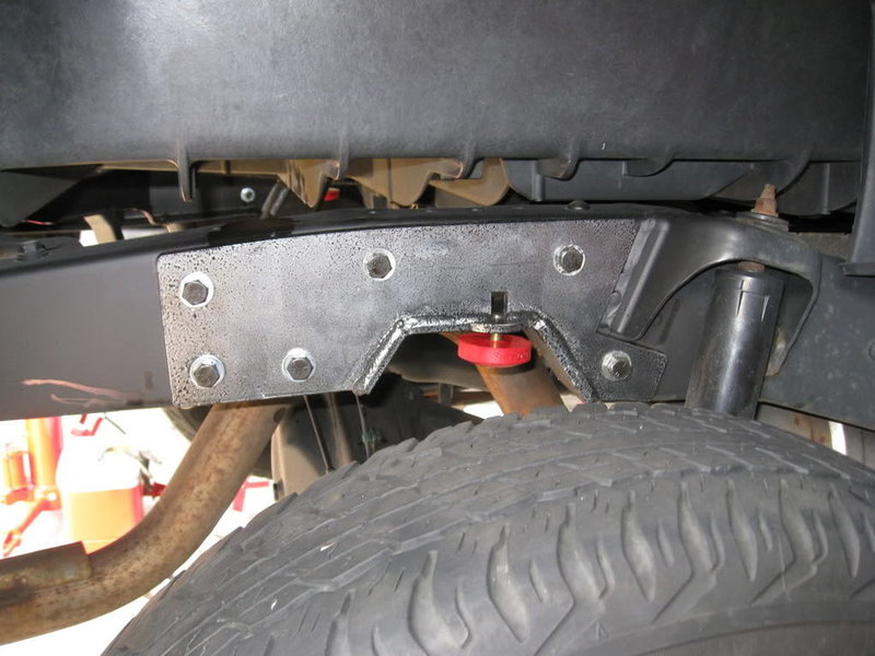

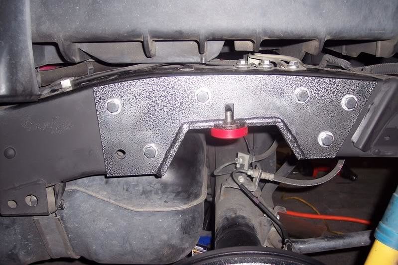

    it will work with taller blocks, BUT because of where the top of the notch is and where the bump stop has been relocated, you won't get much of a drop (probably enough room of about 0.5" or so until you bottom out constantly or what have you).
    attache some images of the DJM notch installed. will give you an idea of how much of a notch you have if you go with the DJM notches.

    So probably 4x4 leafs combined with 4 inch blocks wouldn't fit with the DJM notch? I am running 4x4 leafs with 2 inch blocks no notch with low pro bumpstops wanted to go down another 2 inches possibly 3:/
    Thanks for the pics though gives a way better view than just djm website
