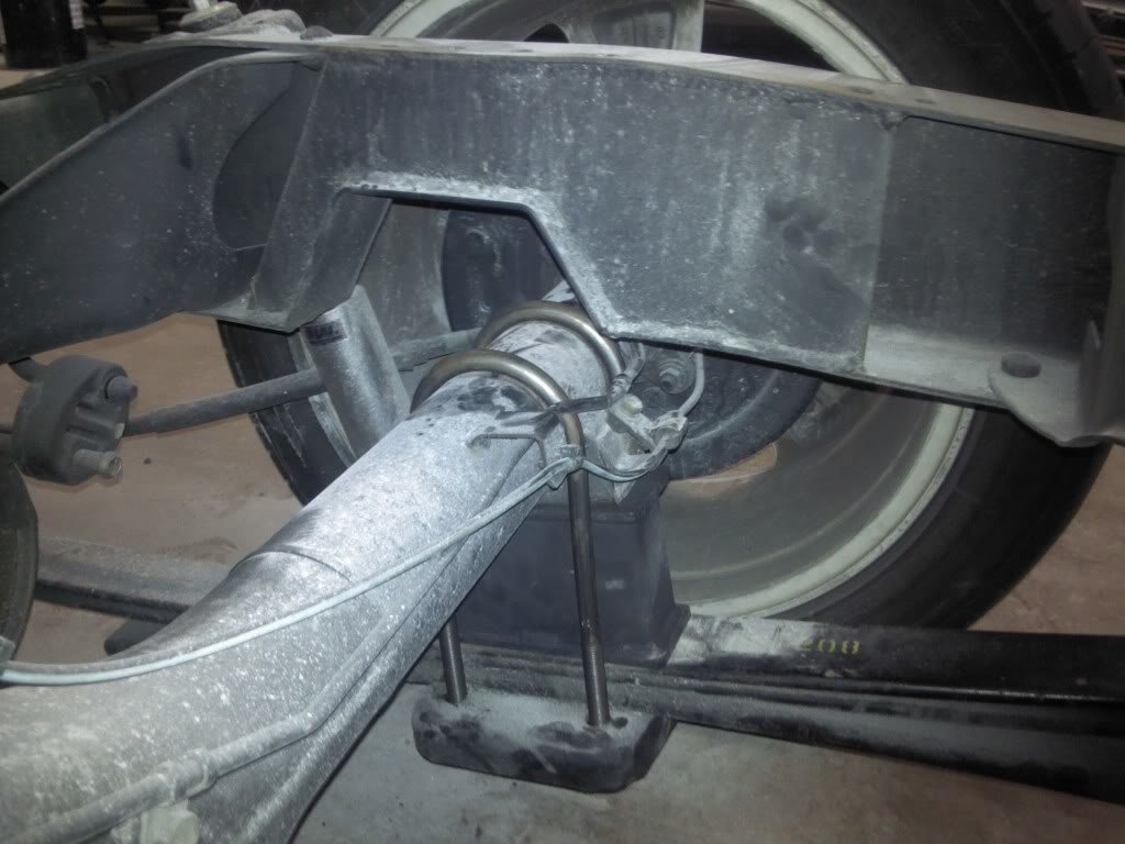

    By "shock plate", are you referring to the metal plate that the blocks and shocks mount to? I.e., the plate that the u-bolts connect to in this pic:
    I guess I never gave much thought to the wheels hitting that plate if the wheels are too wide and the offset is wrong.

    Yes well more so the bottom shock bolt was sat inside my rear wheel do to it being positive and being 10" wide but 8.5" on +45 isn as deep inside as wheat I had however it doesnt hurt to have less offset the wheel won't poke and it will have more clearance inside
    Offset of wheels is confusing to me to took me awhile to actually understand it
