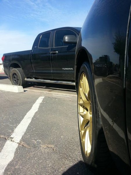

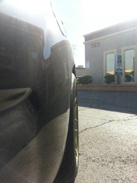

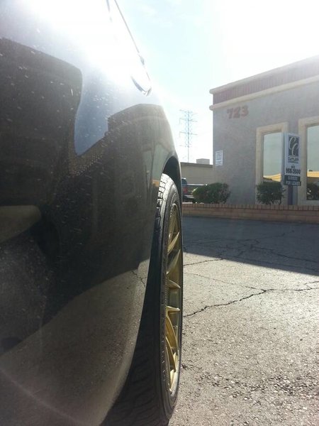

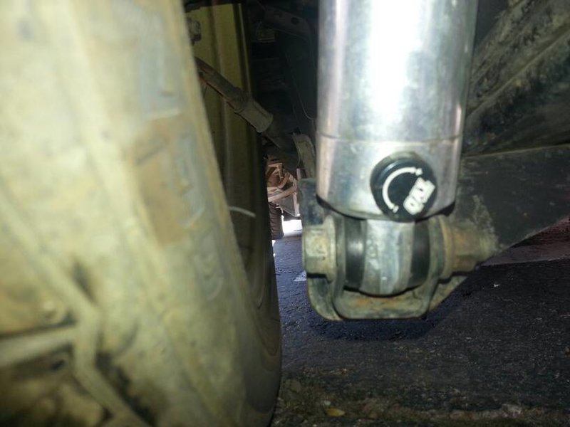

    Pics first, ill edit from the computer and respond accordingly.
    Ok so, as you can see with my 18X9.75 w/ +20 offset I am roughly an inch from the axle mount and shock perch. You inset yourself at +35 and run a 10" rim and you are going to be .5" from all that. Too close for my confort....
    I'd, still do a 275/30/20 on those 9's. But that is just me, I like have meat surrounding my expensive rims and enjoy a decent ride on my daily. Im running a 275/40/18 on my rear and a 255/40/18 on my fronts.
    Ouch a 25 series tire. Ride quality must have been shit. Here scroll to the bottom http://www.generaltire.com/tires/performance/g-max-as-03#Specs . If I were you and ran 8's up front and 9's in the rear I would go 275/30/20 and 255/35/20 and a 3.5/4.5 drop 4/5 is going to be pushing it.
