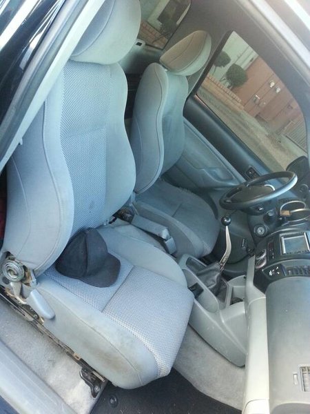

    Got the new seats in and hanger in. Seats are comfy, will be redoing the harness on them and the inside mounts next weekend as long as the seat covers show up this week.

    what kind of seats I need buckets I hate my bench most days

    Here you go, sport seats out of a 05. Got them from a local for 100 bucks. Rylan was kind enough to forward me new OEM covers off a member for 100 bucks and not I need to cut the belts to my bench and swap the full harness I had from my bench, in my 200SX seats, to the sport seats as the passenger side is not plug and play. As well as cut the rear inside mounts and re-weld them in the correct location.

    my seat has the air bags and sensors id have to get them out of a 09 and newer i guess to work right

    yeup, or delete the wiring in the seat. I think a few members have done this. Like I said, I have to remove all the existing wiring and swap in my old. Also have to redo the inside mounts. For some dumbass reason they are 2" back of the ones in the regular cab.....

    Same color, I got OEM seat fabric. They are not covers.

    Did you say your sport seats were not plug n play or did I read that wrong?

    They arent, harness do not match up at all and the seat belts do not plug in. :mad: No idea why they didn being that they came from an 05

    The airbags don't but I just transplanted my bench airbag sensors into the seats when I had them stripped down but all the mounting holes lined up correctly right? As for the seat belts, I just used my bench seat belts since I liked the fact that those had stronger hardware holding them to the truck.

    I have to swap my seat weight sensor in as well as the main harness with seat position sensor as the seat existing does not tie into my existing harness on the passenger. I would have liked to have used the seats belts that are attached to the side, but alas those are different as well. As for the mounts, these seats came out of a double cab, apparently they wanted to change up for the double cab and extra cab instead of keep it consistent. Don't you worry Rylan, Daddy's gonna make it work and take lots of photo's.

    That really sucks about the double cab seats, I could have sworn singlecabguy pulled his from a double cab and they mounted up without modifying. Guess I was wrong.
