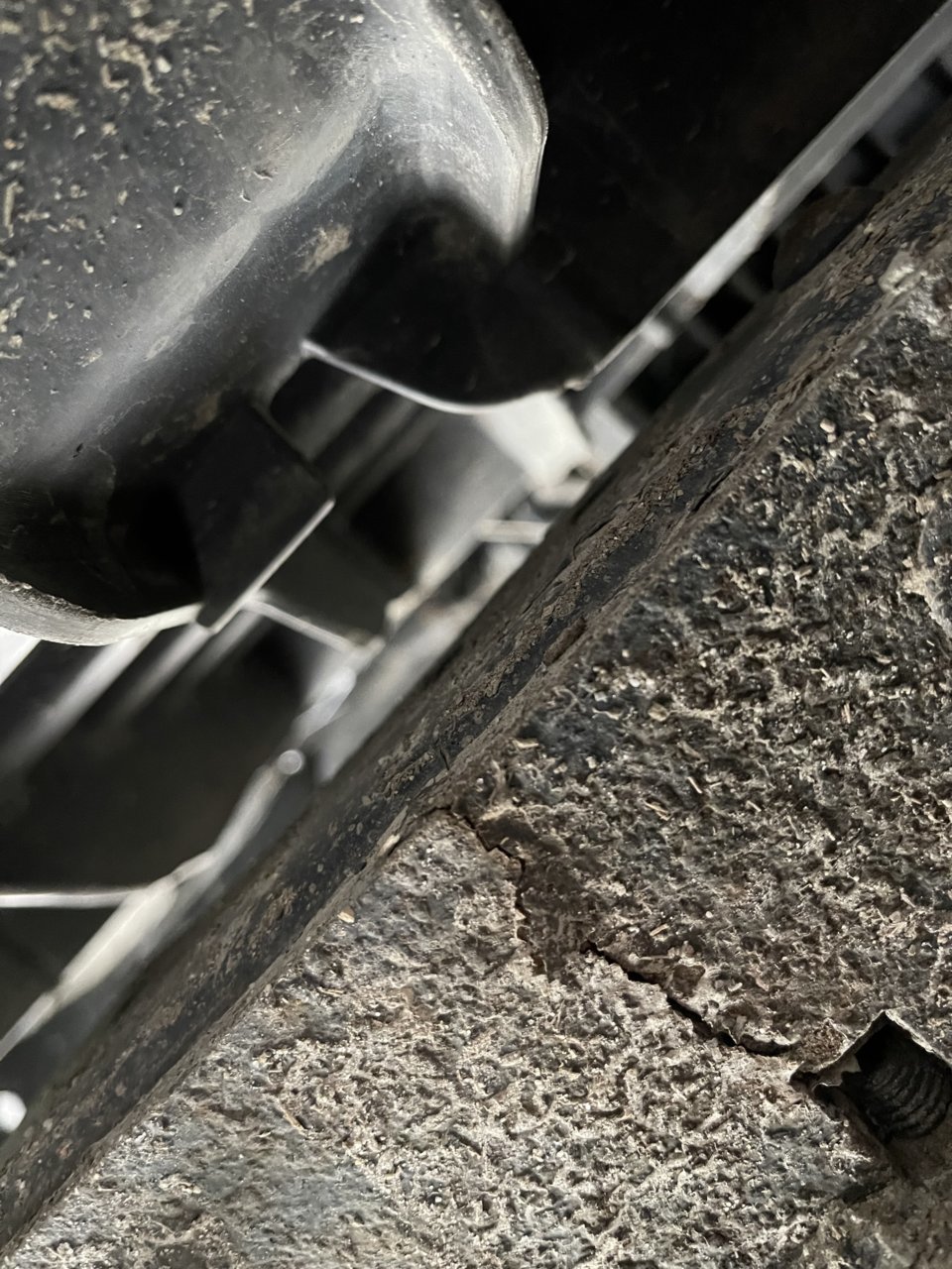

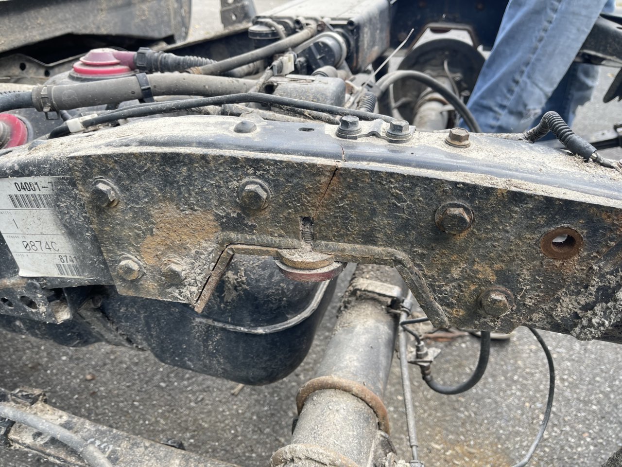

    To anyone who has the DJM kit on a second gen with the c-notched frame. I've now cracked both frame rails and reinforcement plates. The frame is two years old. Fair warning, our frames can't handle missing the bottom structure piece. I'm now looking into having to tube frame the rear of my truck since I autocross it. Best of luck to you all.

    I think driving it daily over rough roads in Maine did it in. The reinforcement plate split apart at the welds as well besides just cracking.

    It's sitting on kyb excel-G shocks, and yes I have hauled two motorcycles (at separate times) as well as a washer-dryer. I certainly won't be putting anything back there besides my race tires from now on. I'm going to pull the bed off this coming weekend and weld the frame and try to make new reinforcement plates.

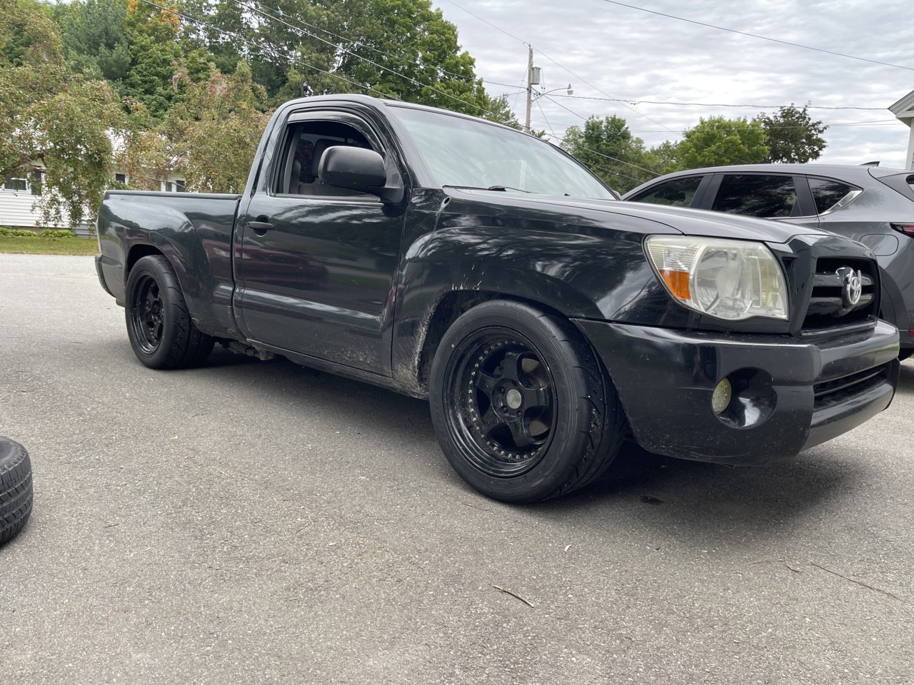

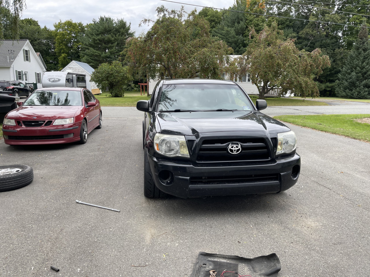

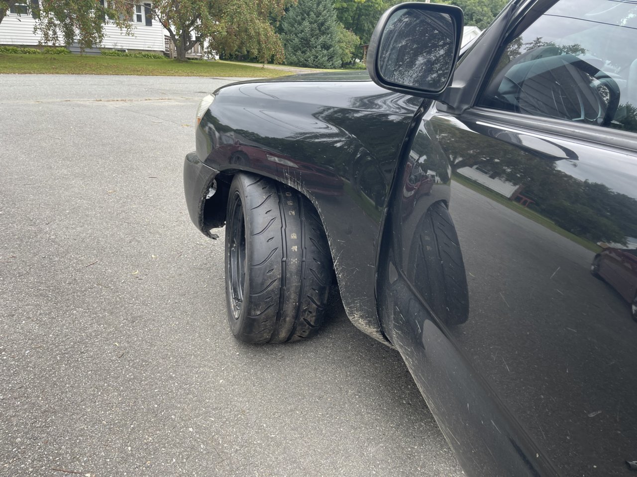

    Fitted the Falken RT 660 295/40R18's today... took some effort. Here's before the fender got rolled. 604983C5-5EF6-4EF9-9AA5-2AD27ED5551A.jpg This is after we finished rolling it. 08FDFD44-A0C8-4D9A-9B48-393B7F166E4D.jpgI also had to take an impact rated adjustment tool (hammer) to the inner fenders to make it clear without touching while under load in a turn. No pics of that, but here's some more from the fitting process. 68843B69-9C76-457F-B5A4-D756031E437D.jpg11A7489B-13A6-4324-9665-8B8C9EB9CB42.jpg CD956524-AFC3-4424-A0AF-D1CE54513FA9.jpg

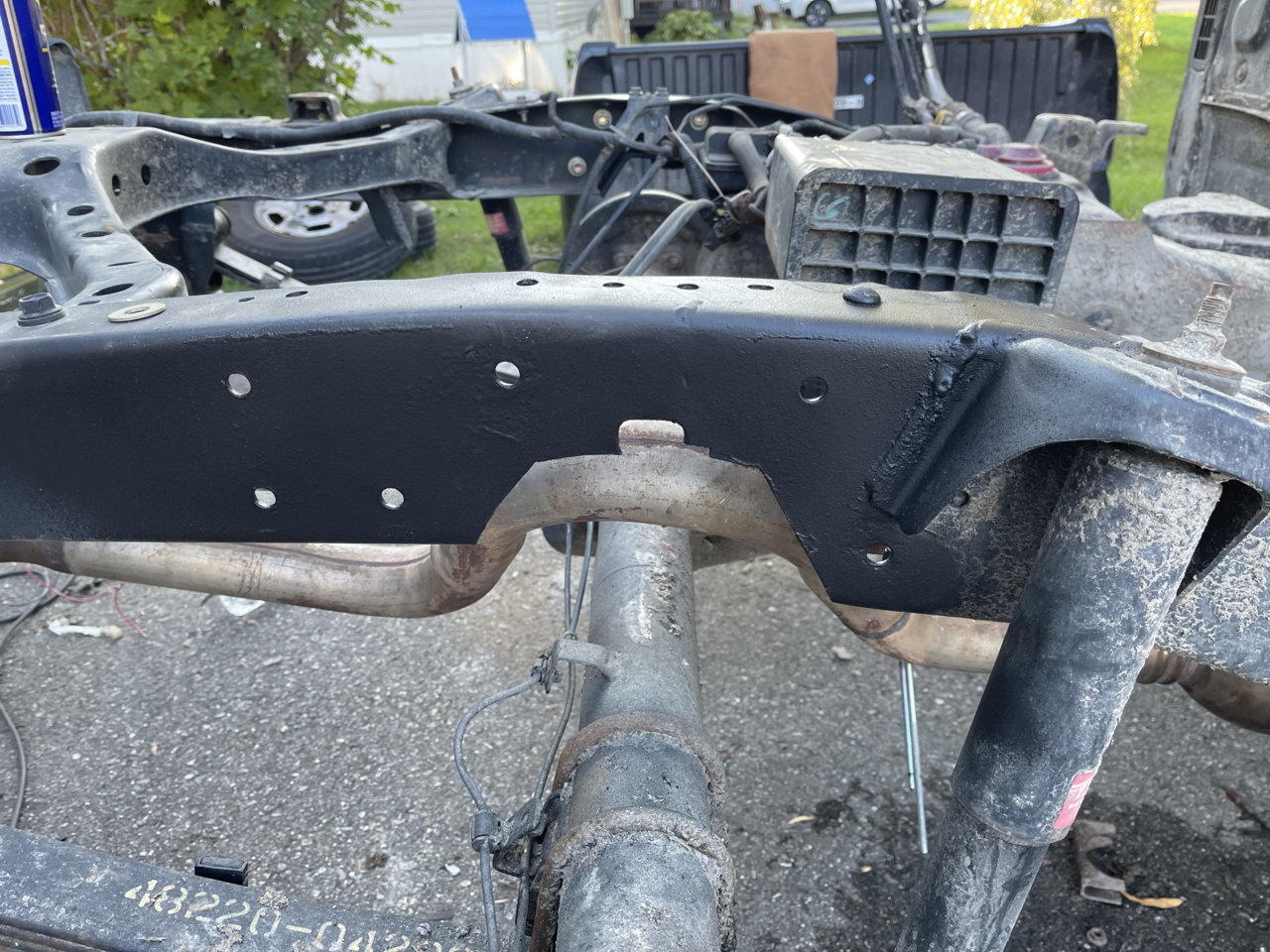

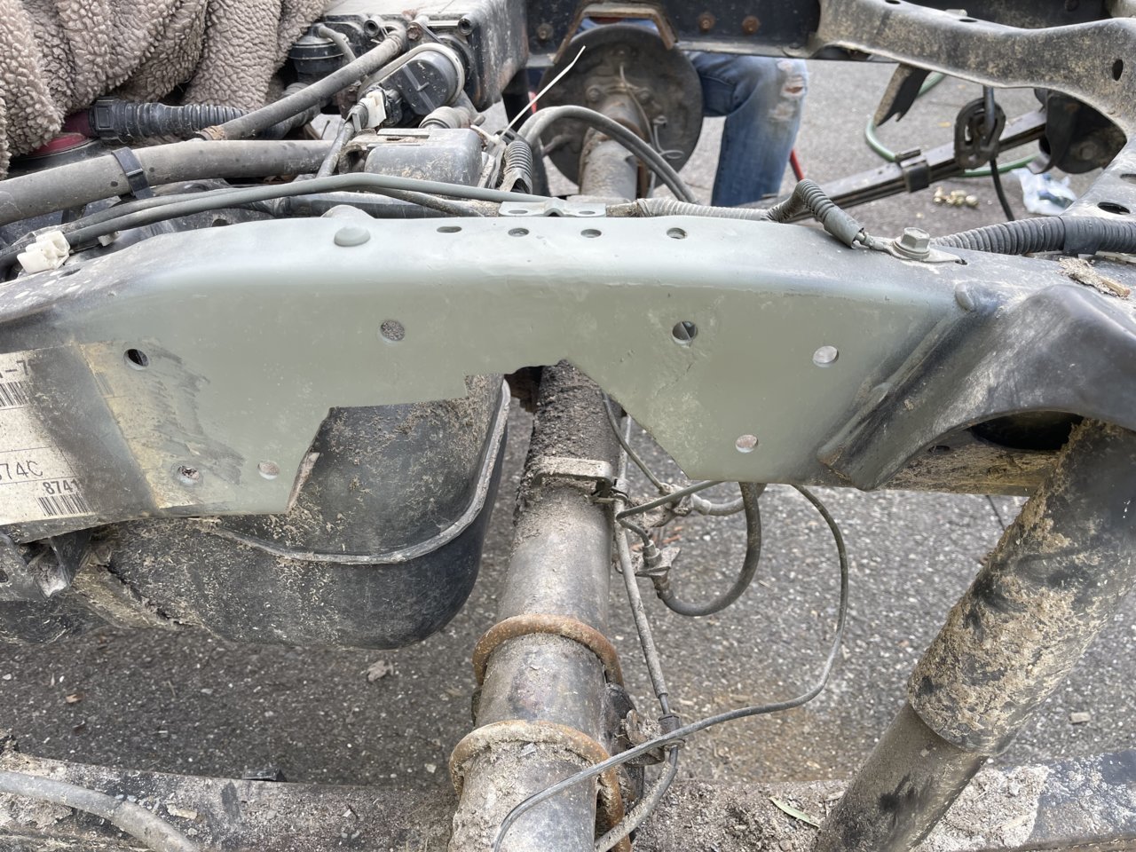

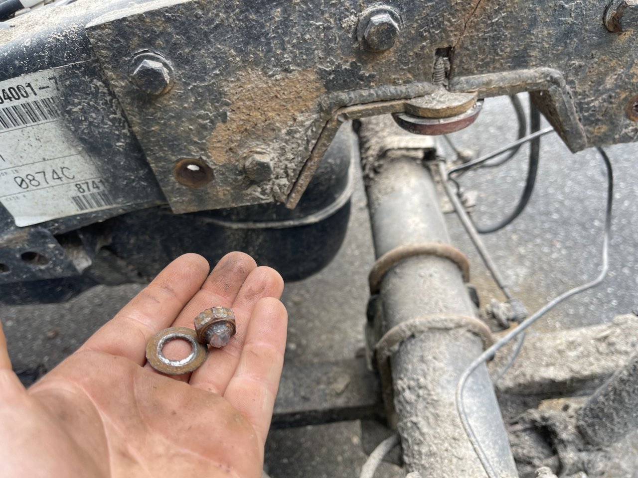

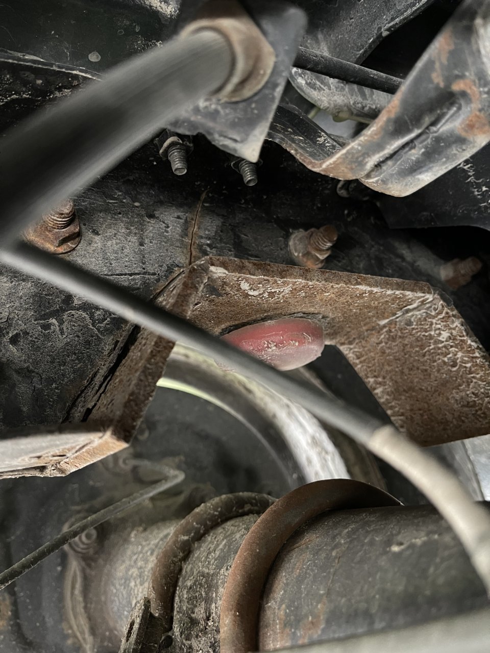

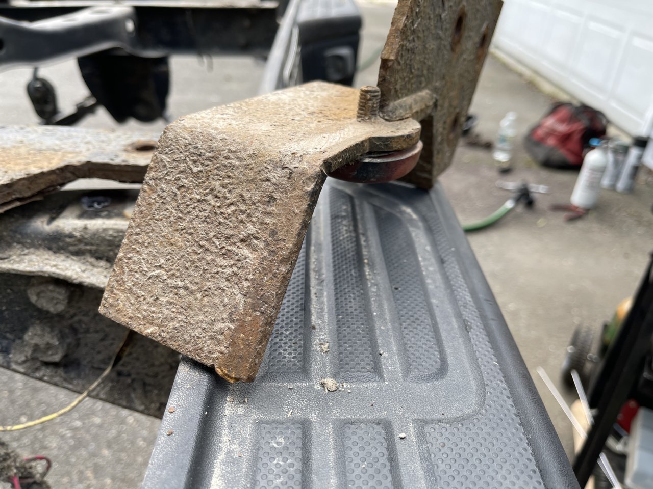

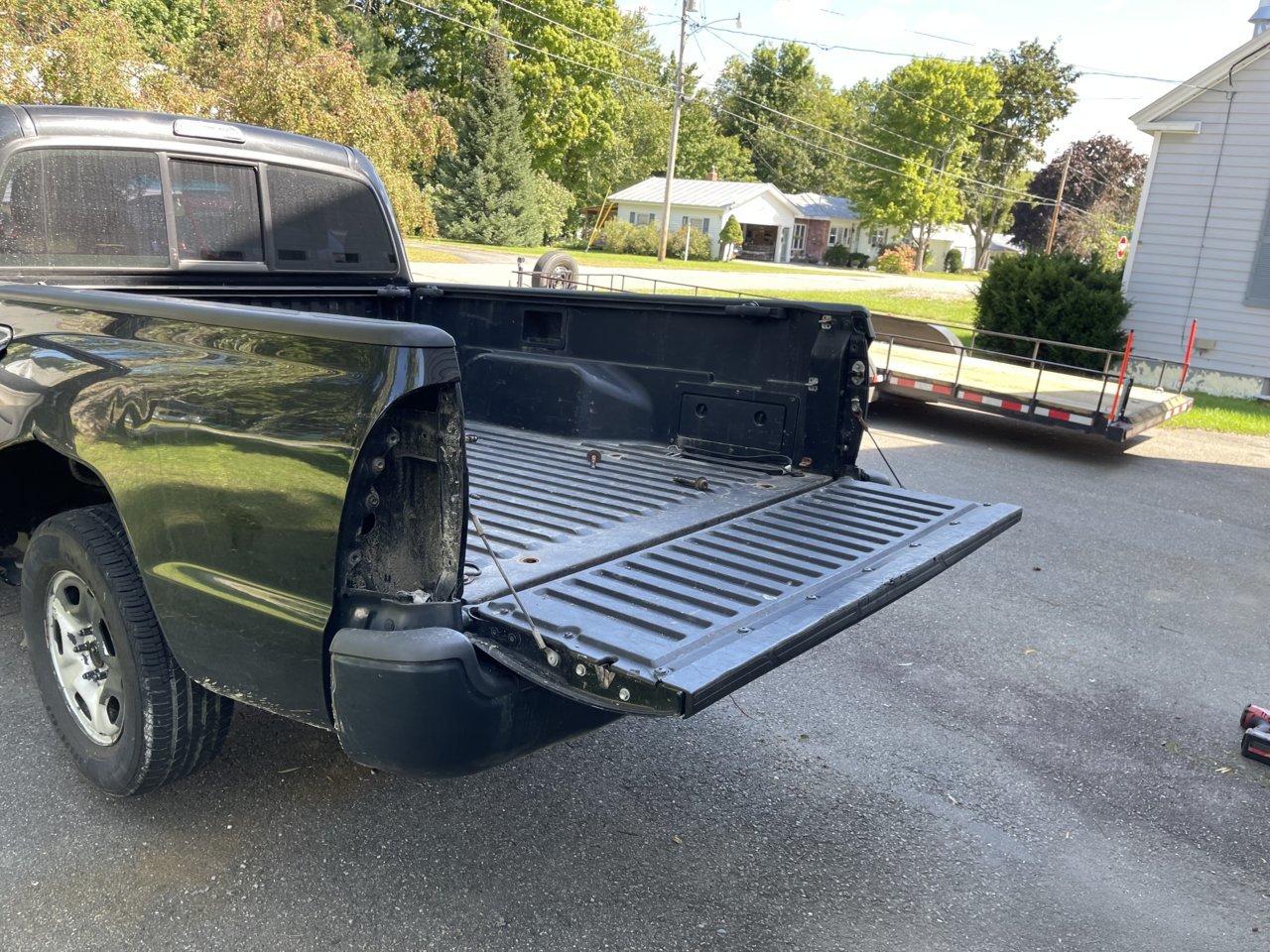

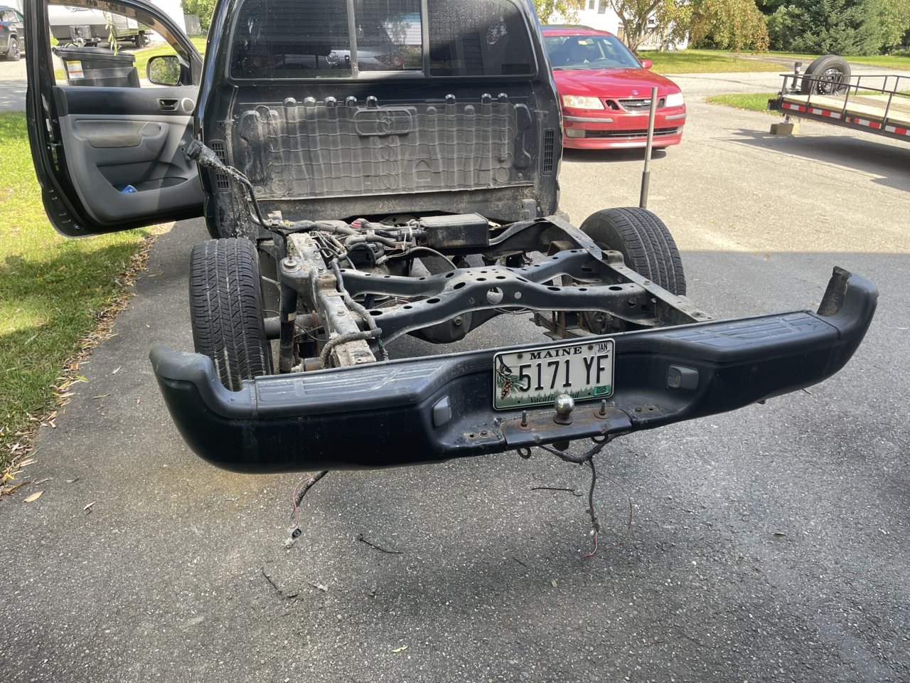

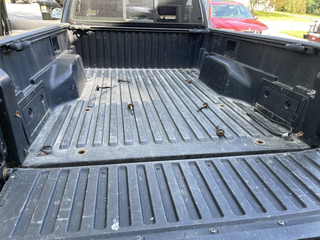

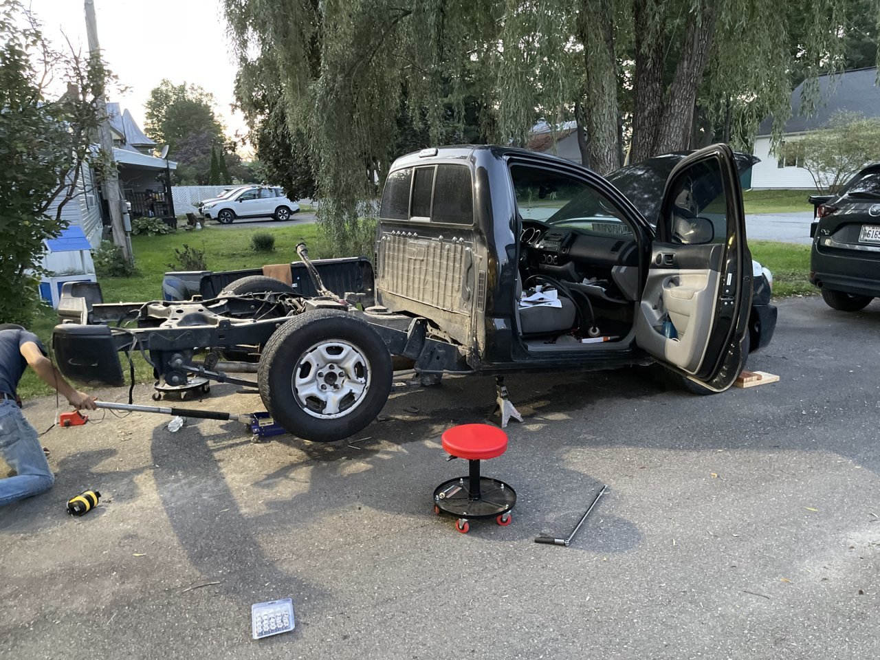

    So I started the bed removal process with the obvious, removing the six T55 bolts. Thankfully somebody prior to me put neverseize on them and they came right out. [​IMG]
    After that was completed, taillights came out and wiring was pushed back through. Not pictured, I removed the filler neck cup from the bedside. [​IMG]
    After that my roommate and I ate our Wheaties, and lifted the bed off. It's a bit tricky with two people as the bed wants to tipbackwards when lifting from the top of thewheel wells. (Tailgate was off for this too)[​IMG]

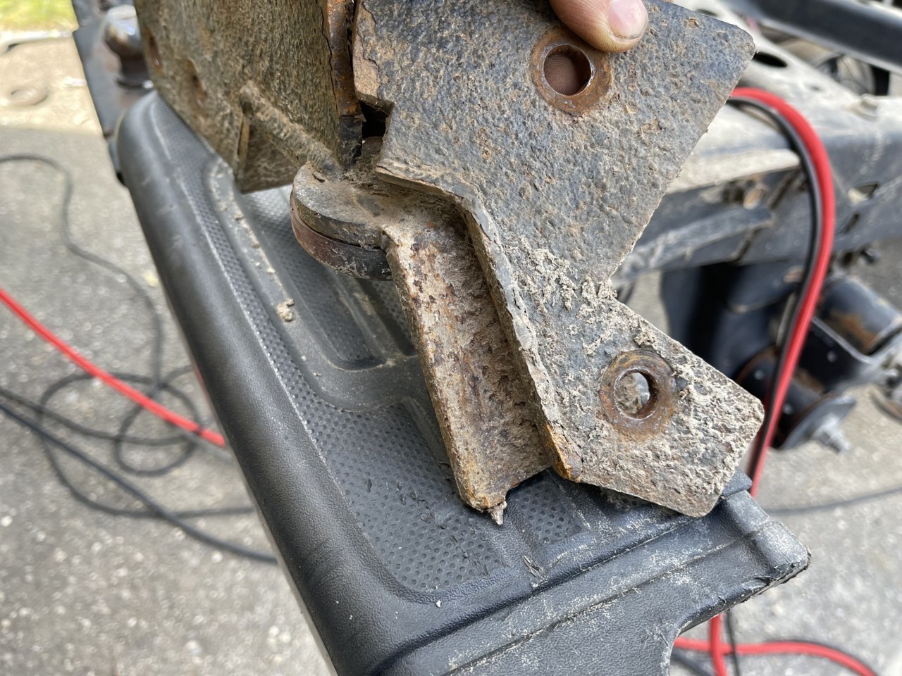

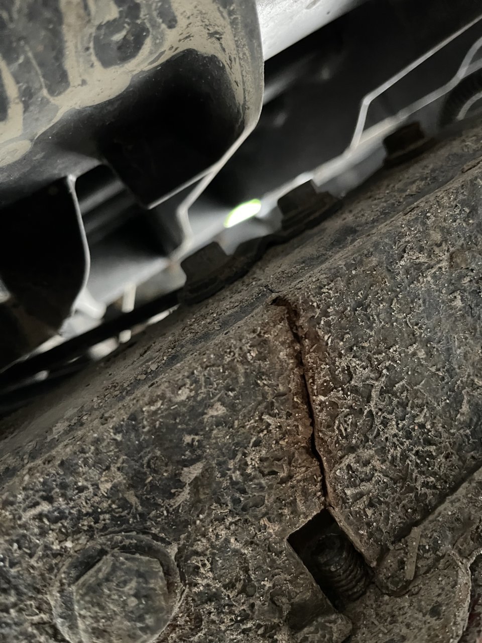

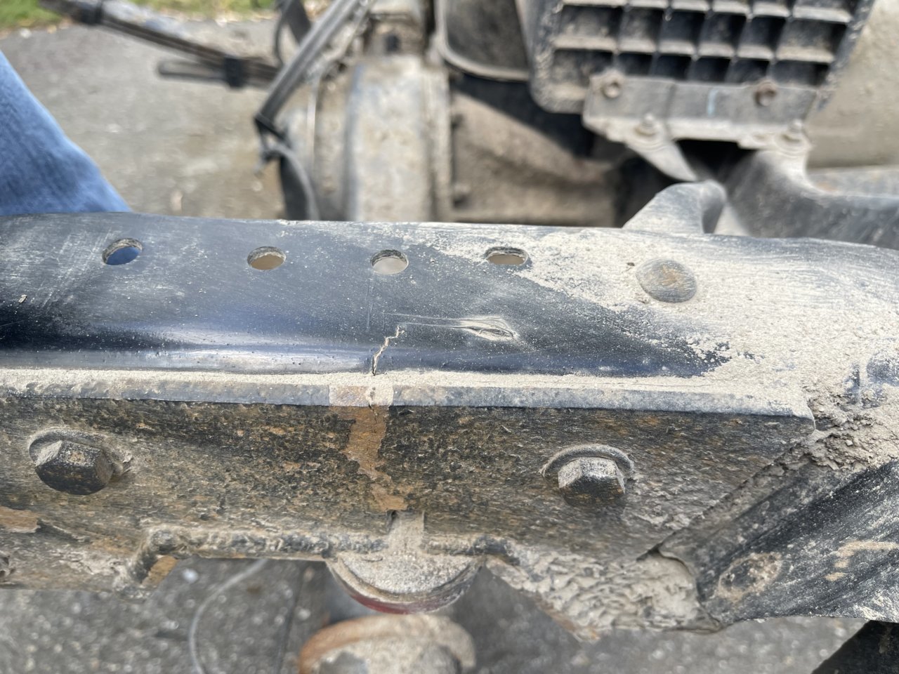

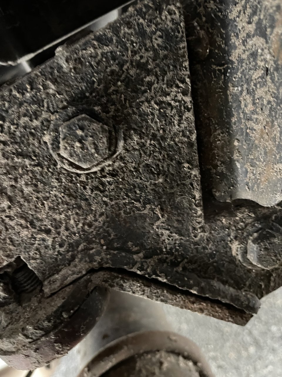

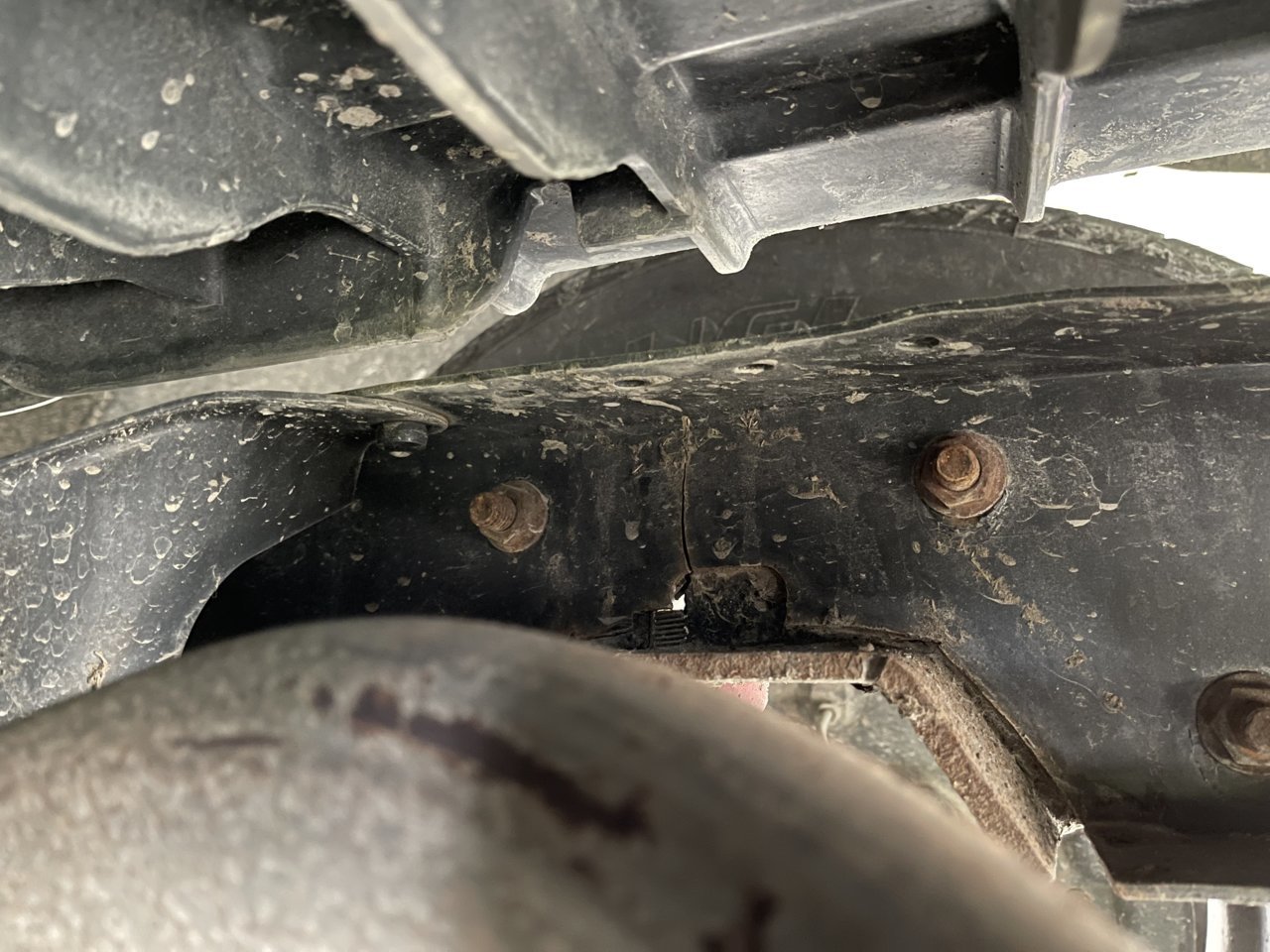

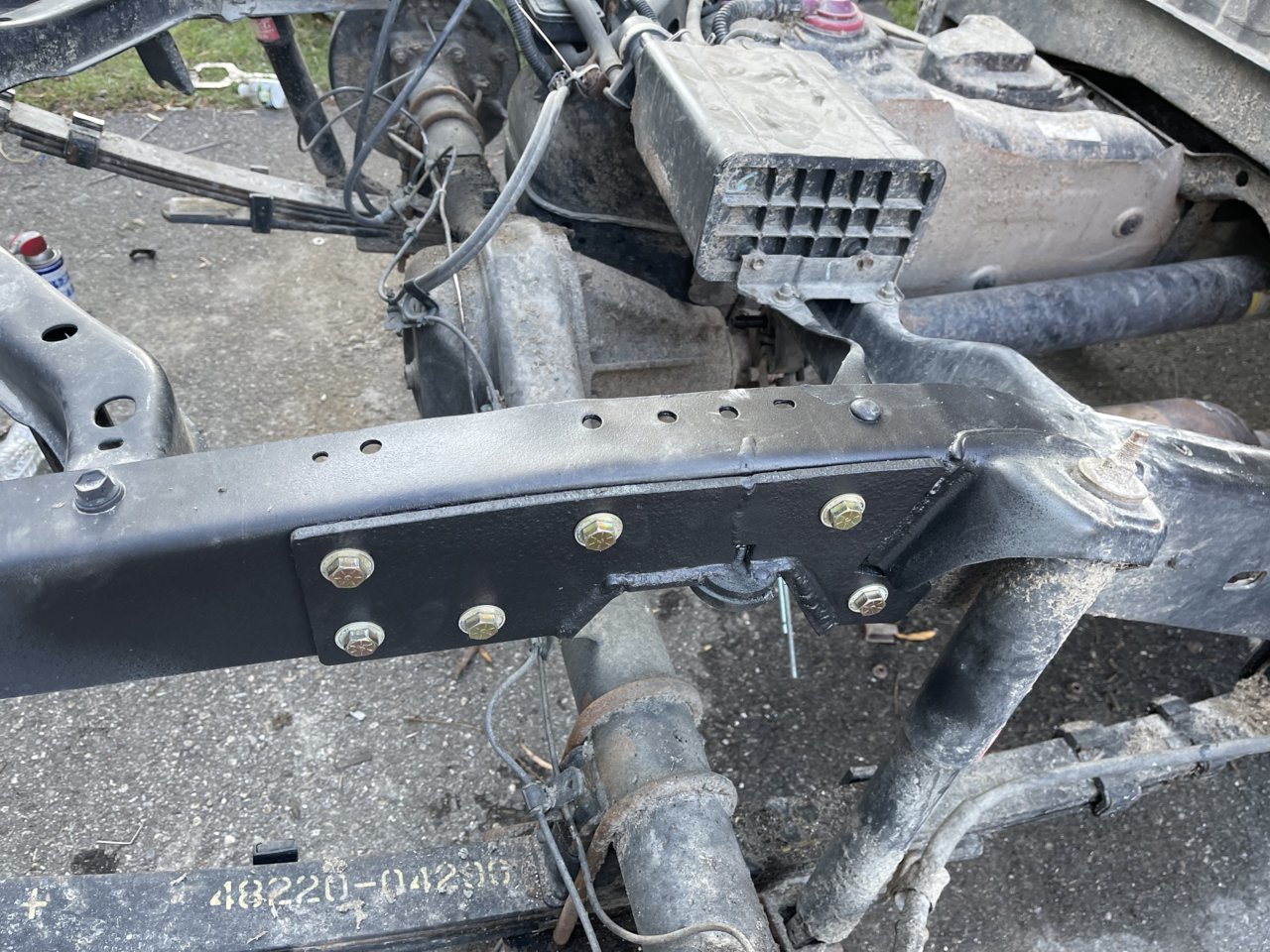

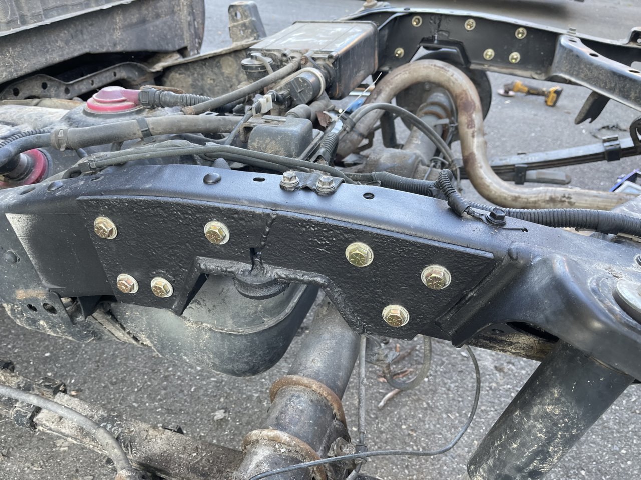

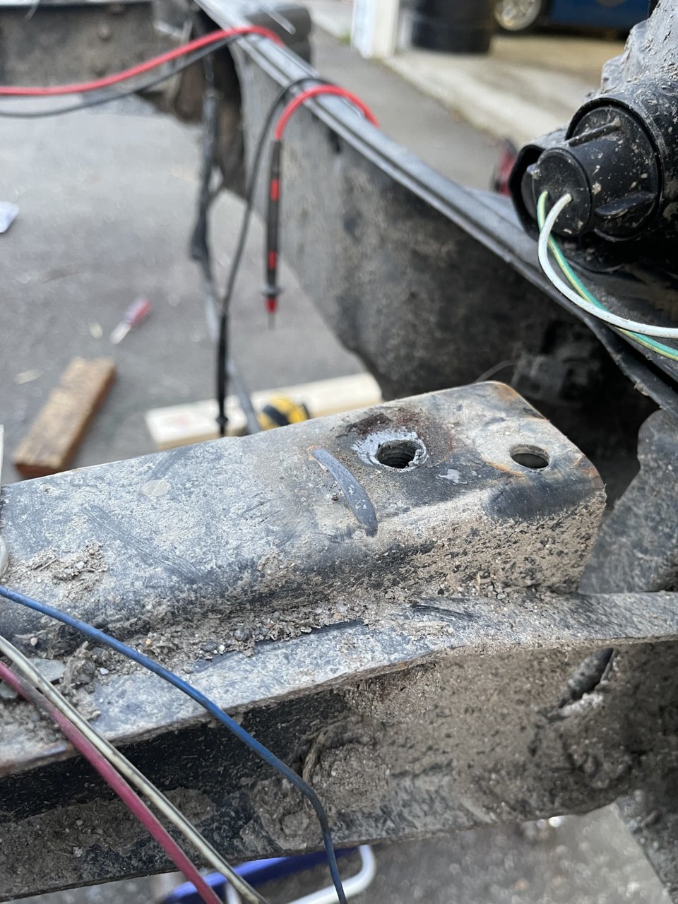

    With all that said and done, we got to assessing the damage. Both sides of the frame cracked, and both support plates broken in half with welds pulled apart. I will say the welds looked very cold, with practically zero penetration. [​IMG][​IMG][​IMG][​IMG][​IMG]

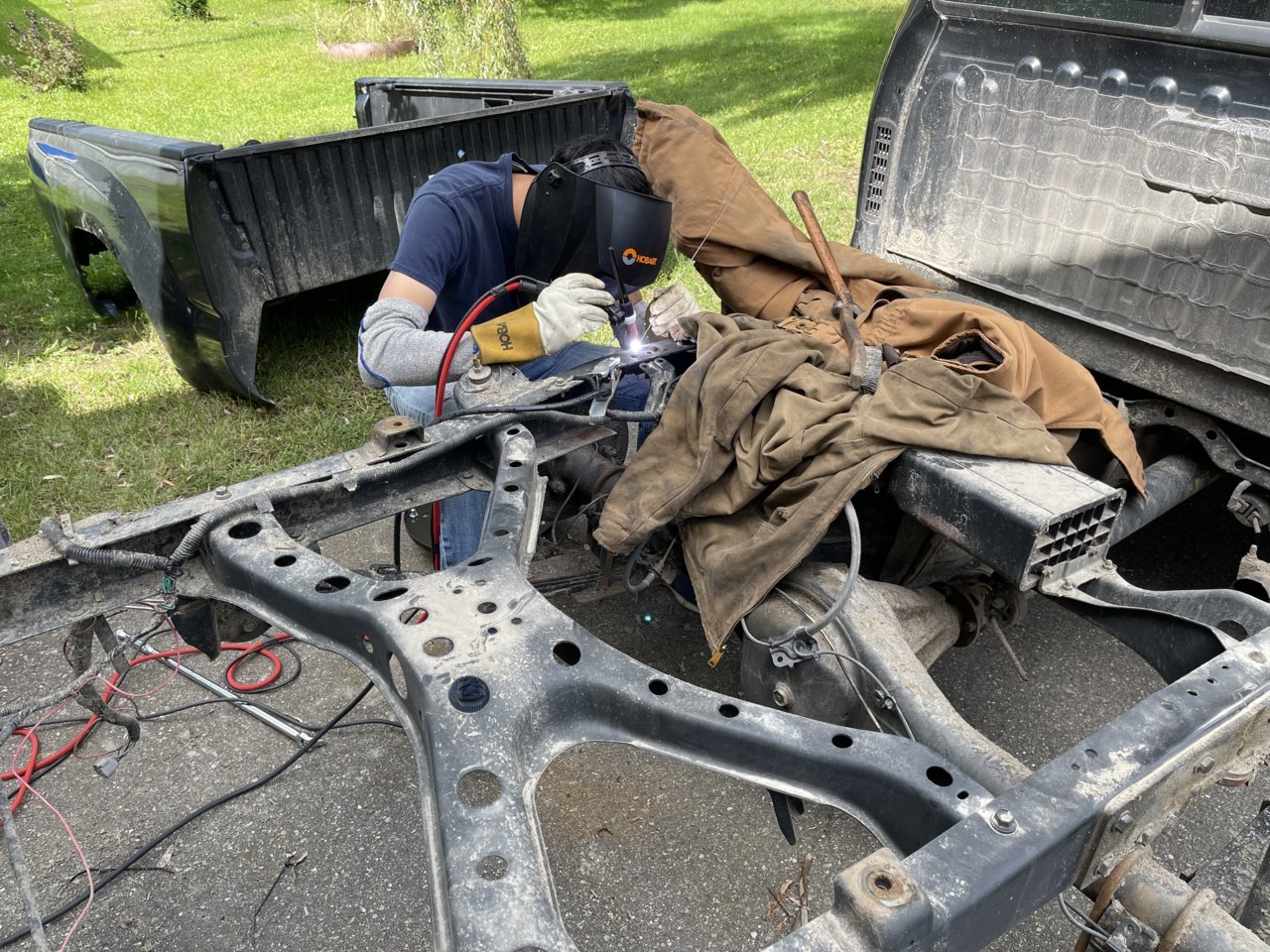

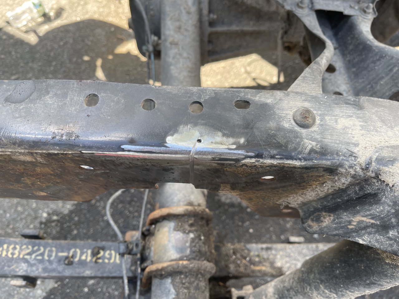

    After regrouping and analyzing, we cleaned up the frame, grooved the cracks, drilled the end of the cracks, and tig welded them closed with 308 stainless filler. [​IMG][​IMG]
    After that we hit the frame with etching primer and fresh black paint. [​IMG][​IMG]

    Then we ground down the reinforcement plates, and tig welded those back together as well. Hit them with the same primer and paint, then slapped it back on with new grade 8 hardware. [​IMG][​IMG]

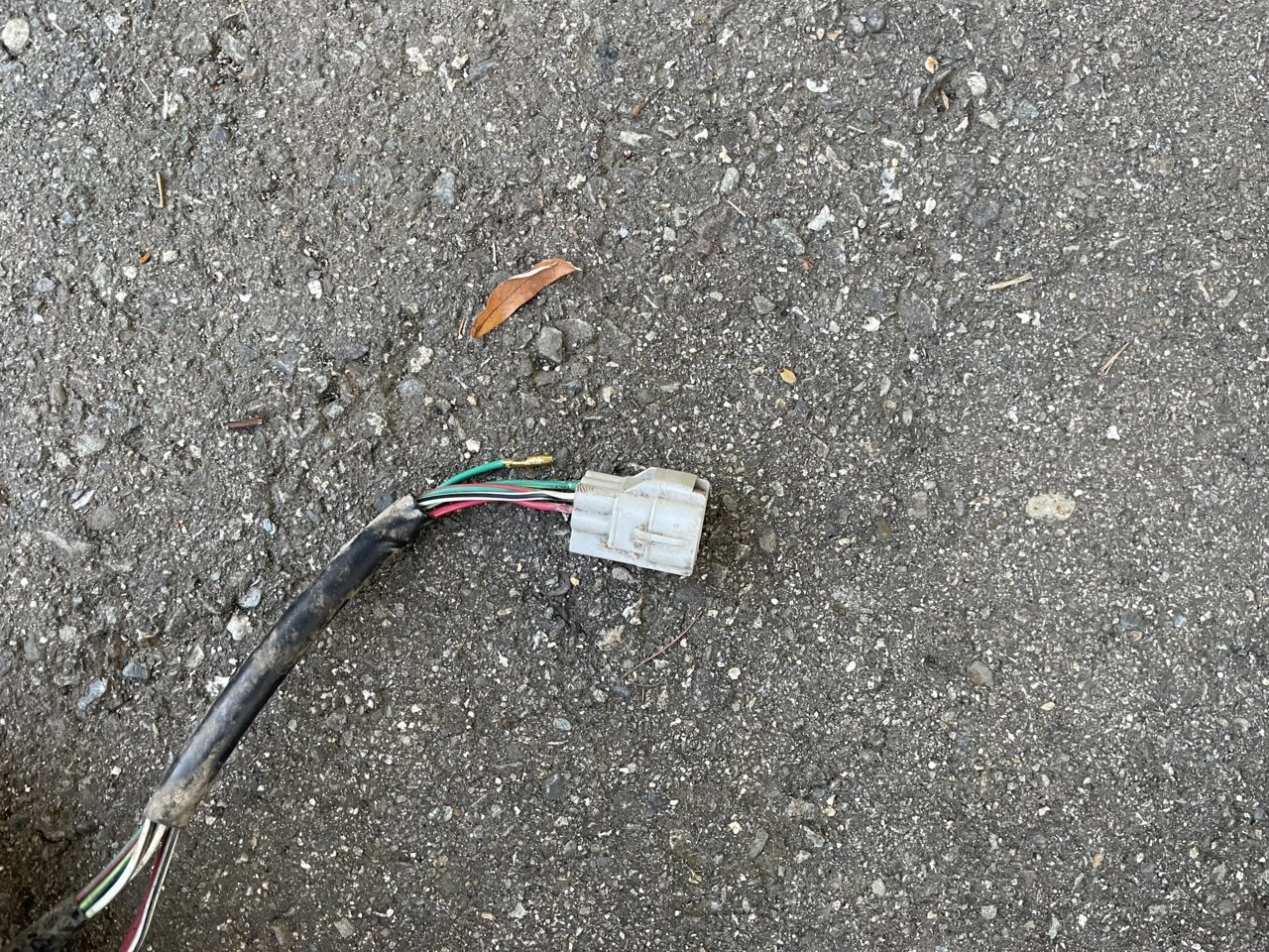

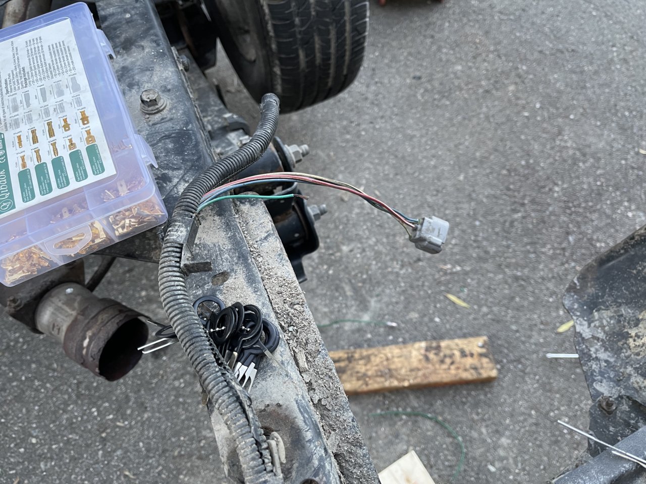

    After that we tackled the wiring, which I posted the results of earlier. Here's a couple pictures of the mess, and one of where the wire was sandwiched to the frame. [​IMG][​IMG][​IMG]

    I was thinking some extra reinforcement around that c-notch would help, in theory at least. Though looking at the close up pictures the shoddy original welds failing most likely led to the stress fractures on the frame anyway, so now that they're properly done up it shouldn't be an issue.

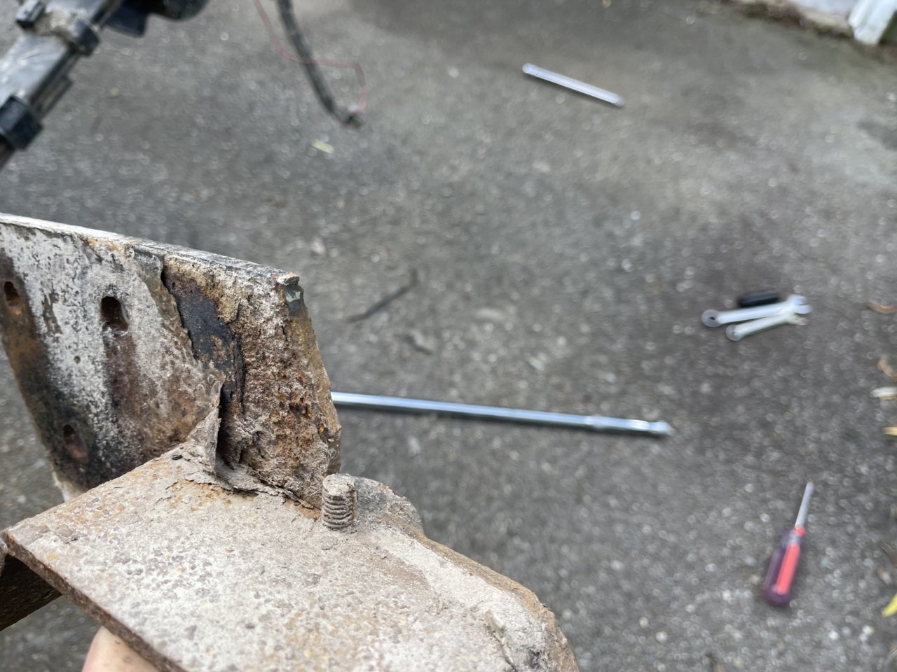

    I didn't have a lot of choice actually, half of the old bolts snapped when I tried taking them out.0E900032-C64B-4CD0-AE6B-77C3C888CB74.jpg
