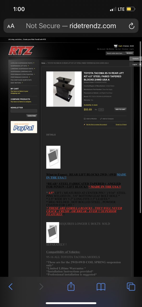

    6C730F60-788C-4432-8C85-4DD4912DCCB5.jpg I can use this lift block to drop my truck right 5 lug 2009 rn I have a 3 inch block but I want to go lower will it work?

    Do you have a c-notch installed? If not- no. If yes- yes.

    At 4.5 inches of drop, you'll be quite literally sitting on the bump stops. You'll need to have the notch done before installing the 4.5 in block. As you saw with my experience, extra support/boxing the frame/ anything to strengthen where the notch is installed is really important. Best of luck- and as always post some pics when it's done!

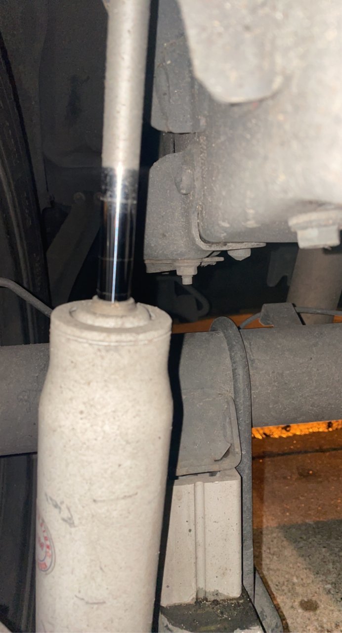

    FCD61DE1-7494-418F-A19B-B95580DCCB56.jpg How much room I have rn 3 inch block no notch

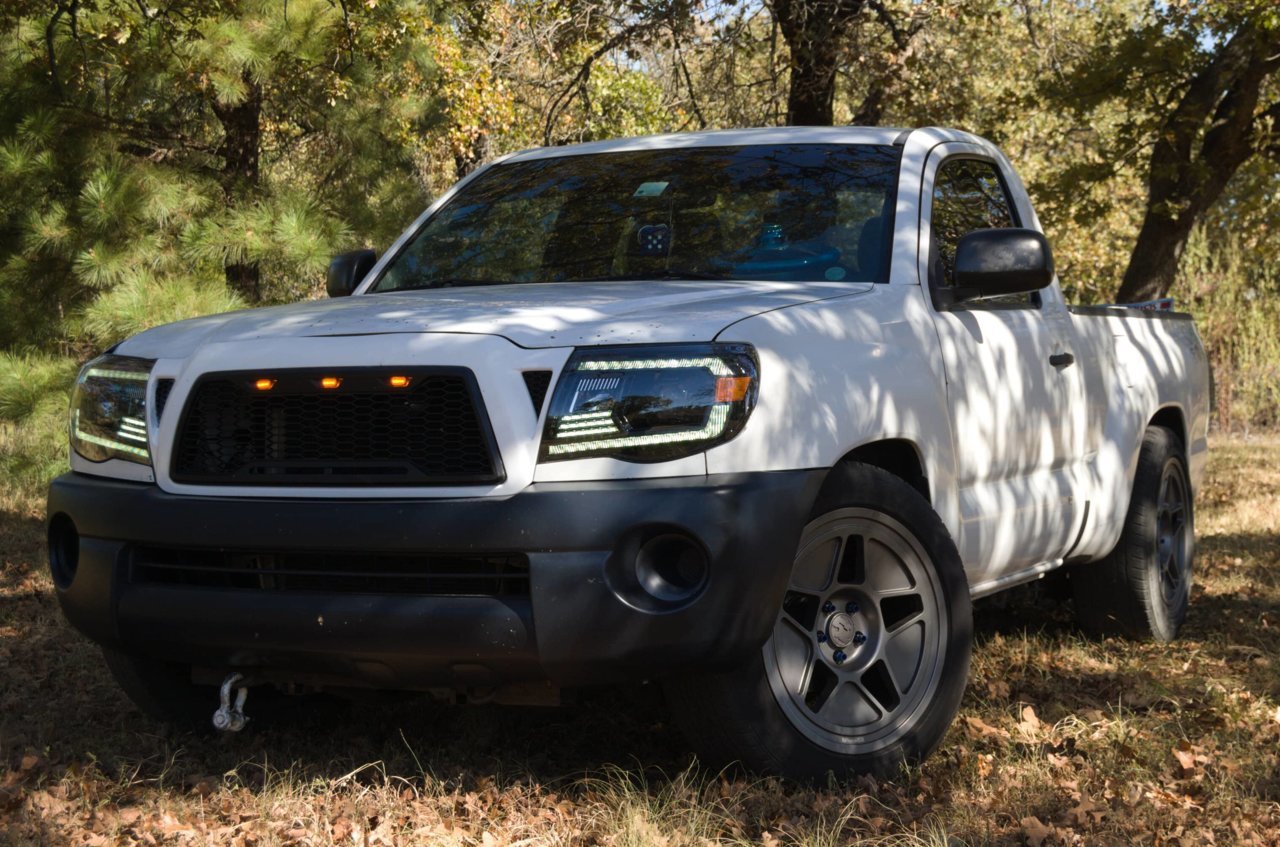

    (In search for used djm control arms, message me if u have a set) super white tacoma 2007 5 lug regular cab -1.5” Front -3” rear bilstein shocks/struts Proforged steering components Staggered 19” Fifteen52 Wheels Alpharex polished black headlights eBay taillights Alot of misc interior mods.. quick release hub w/ steering wheel URD short shifter Color matched bed bars Full sound system
    wish there was more tuning options for the 2tr's :turtleride:
