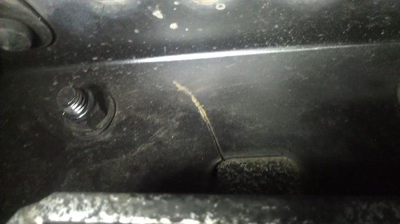

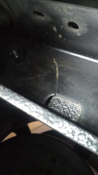

    My truck is officially out of commission for the next week half....... went under the truck to regrease the leafs and I always do an inspection of everything making sure there are no problems. Ive seen a brown dirt line on my frame before and freaked out thinking it was a crack i touched it bt felt nothing but today when I checked I saw the line and this time i got closer and BAM!!!!!! cracked like a dayum egg........ Passenger side only.... I will not drive the truck till its fixed. Already talked to a fab guy here and Ive been waiting for work to be done from him but its hard since he fabs on weekends and has a day job. But after talking with him and showing him pics the truck will be seeing him next friday.... the frame will be fixed and a new taller notch will be welded reinforced and boxed so this never happens again.... fml :(:(:(:mad::mad::sadviolin::anonymous::goingcrazy:

    Shitty thing is that it happened on the opening that is factory on the frame I hated this from the moment I made the cuts for the notch and saw how it meets right with that dayum hole....... I believe it possibly could have been from bottoming out with no bumpstops but in general that shouldn't happen..... add on the fact our frames are then and very flexible....

    That is a good reason of why I didn't buy that notch kit, it makes that section of the frame weaker than stock.

    Glad to hear you are getting it done B, suck to hear about the crack.
    Yeup bolts allow for movement and it doesn box the area.

    Are cracks fixable or is it more of just reinforcing that area so it doesn't spread?

    Gotta open the crack with a cut off wheel past point of last break. Re-weld and then reinforce the area, usually by plating one or both sides.

    Yes its fixable.my friends x had his djm.notch cut.wrong.and installed wrong and cracked.both sides of the frame way worse than mine and it got fixed exactly how Phil said gotta open and re weld the notch ill be getting is taller with added plates on the outside and fully boxed
    The shit thing of the djm kit is that hole in the frame the notch goes right under leaving that part of the frame expose and add the fqct i bottom out sometimes bam crack
