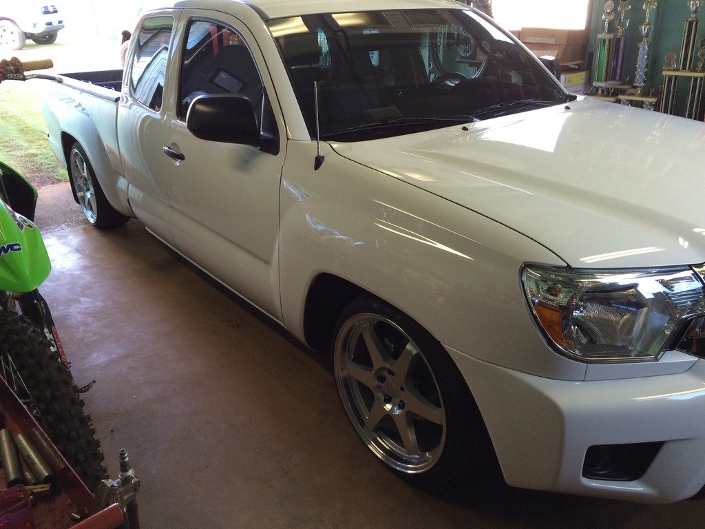

    Just slammed a 2015 for a friend. Came out about 6/6. DJM 3/4, XII Performance drop springs, and 4x4 rear leaves. 19x8.5 Varrstoens. 215/35R19s.

    Damn. That looks good.

    That's clean af. Damn screw a car I want a slammed Tacoma now. How much did that suspension setup come out to?

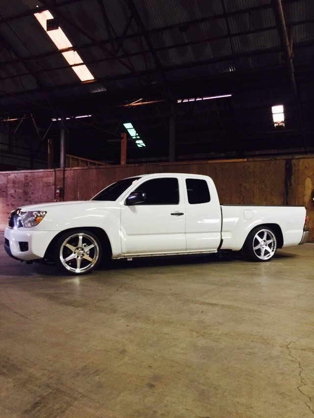

    More pics please, that's one sexy A$$ Taco!

    got a side shot of the ride i wanna see how low it is thanks

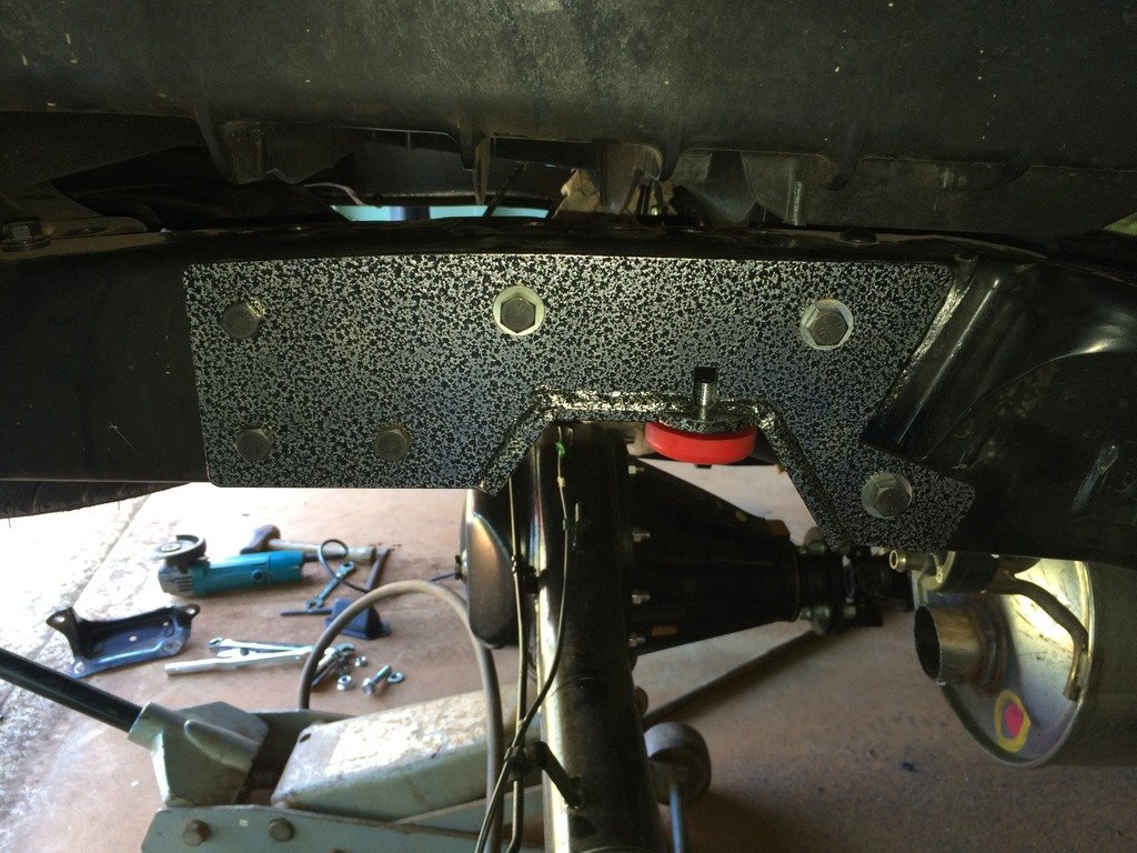

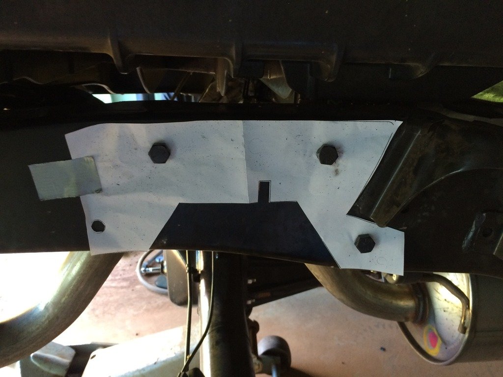

    Such a clean install. I remember when my trucks frame used to look like that. haha

    So much want, looks great!

    So FREAKIN CLEANNNN!!!!

    That looks so good. I wish I could go that low. :(

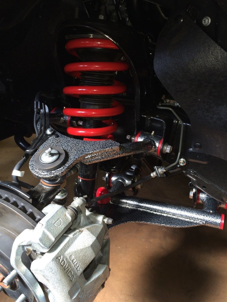

    That's a clean truck rat107. I know you said it isn't yours but do you know the tire size that on there? I'm asking because it doesn't look like there is any camber at all. I just lowered mine with the spindle spacers in the front on top of the djm arms and I'm at about 5 degrees negative.

    Sure is, my fault. I'm still curious about how there is so little camber from what it looks like in the pictures.

    19x8.5 Varrstoens. 215/35R19. It's not even aligned yet in the pics and the camber looks pretty good, haha. I set it back to the factory settings on the adjuster cams when I reassembled.
