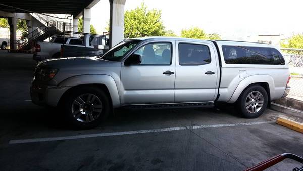

    Mine prob don't look right. especially now that I got a camper. no pics yet, still gotta bring the rear down a little bit.

    brand new on this site. been driving lowered silverados for years and looking for something like this.... but ive been wanting a 4 door (crew cab in chevy terminology, not sure about toyota terms) and looking to have it lowered. basically if they made a new x-runner type truck in 4 door i would already own one.... what type of suspension setup do you have on this?

    I wish I had a better place but I was rushing home. so, only place was home depot parking lot.

    Damn sick. Just needs some low pros on those rims

    what setup do you have..... so for the repeated posts in here... im scrolling backwards through the thread in hopes the more recent people who have posted in here will see this

    Just a reminder, I have a prerunner.
    For the front, got xii performance coilovers with a custom 3" extension. 1" spindle spacers. chopped spindles. light racing uca's.
    For the rear I have the tundra racing flip and block kit plus an additional 1" block. qa1 shocks. working out getting helper bags. those will be my expensive over engineered bumpstops.
