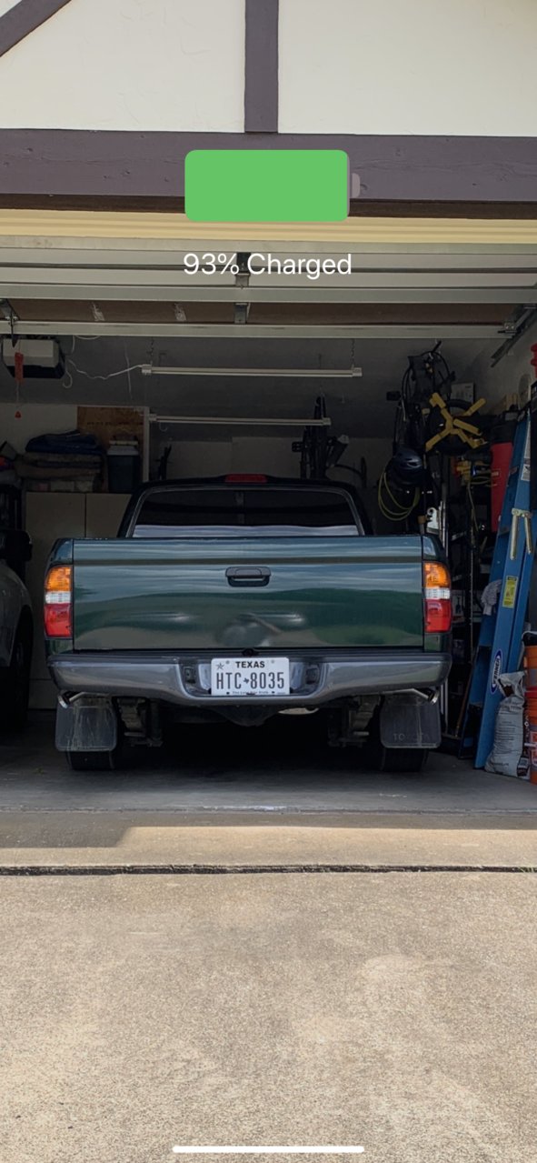

    It went okay. The hardest part for me was getting the new UCA bushings and their sleeves to line up properly. The instructions make it sound like it's no big deal, and maybe it's not, but it was for me. I did the bushings a week before I installed them on the truck. Because I want to be able to return my truck to stock, I bought a set of UCAs from Jim's in Colorado for the shafts (a little added expense, but worth it to me).
    I followed the instructions but was unable to get grease all the way to the shafts. I wrestled with them for a couple of hours before I was finally able to get the grease to where it was supposed to go. If you have trouble like I did, don't install them until you absolutely see grease squeezing out on the shafts. The polyurethane bushings will certainly let you know if they don't get greased.
    Other than that, everything went pretty smoothly. Last year I installed the shorter springs but didn't like them. So I reinstalled the factory springs. That added time to the job that you wouldn't have to if all you do is install the DJM kit since it's designed to use the factory springs. I also installed new upper and lower ball joints while I was at it.
    When I was done, I had to adjust the toe-in quite a bit just to drive it to the alignment shop. The manager at Firestone said my truck aligned "much better" than most lowered trucks they see.
    I took two days off work to do the job. I spent ten hours the first day and about eight hours the next day working by myself on my garage floor. If you have no experience, you might want to hire someone with experience to do the job for you.
    IMG_0358.jpg IMG_0981.jpg Here are before and after shots. I now have 1.5" of clearance at all four corners. The front tires rub on sharp turns and over dips in the road, but it's not objectionable. I installed the DJM four-inch blocks in the rear.
    Left upper arm installed.
    IMG_0817.jpg Lower ball joint factory position below the arm
    IMG_0868.jpg Ball joint flipped to above the arm

    I just discovered your post. I haven't been here in a long time. Thanks for the compliments. No, you don't need lowering springs. The DJM kit is designed to be used with factory springs. I did install the 2" drop springs, but the ride was horrible. A year later I removed them and installed the DJM kit.
