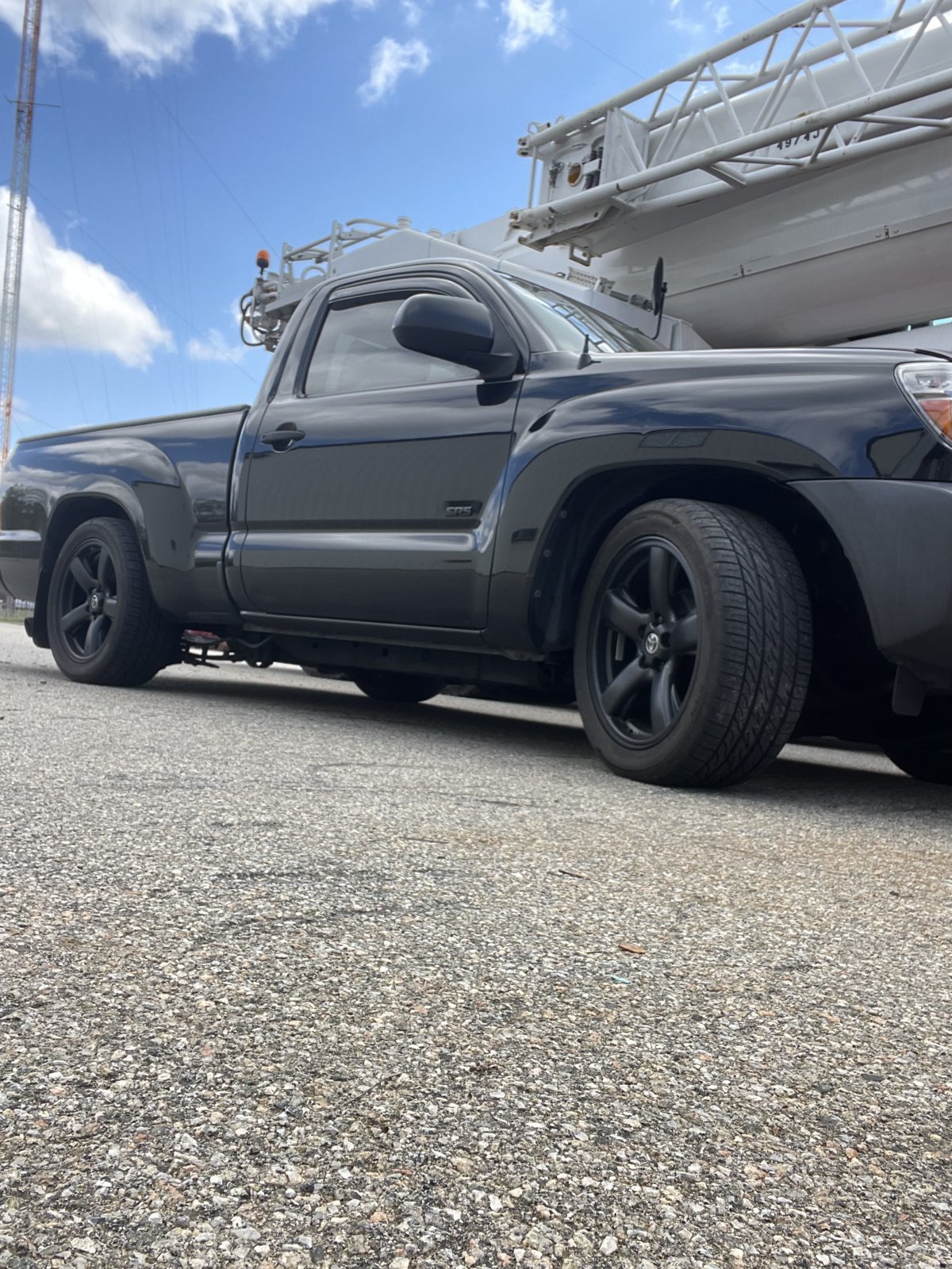

    I went with a djm kit, originally 3/3 then switched to 4” blocks. I have 18” xrunner wheels. I notched but not sure if it’s really necessary.

    That’s honestly a perfect build, any rubbing or bottoming out with the 3” drop in the front?

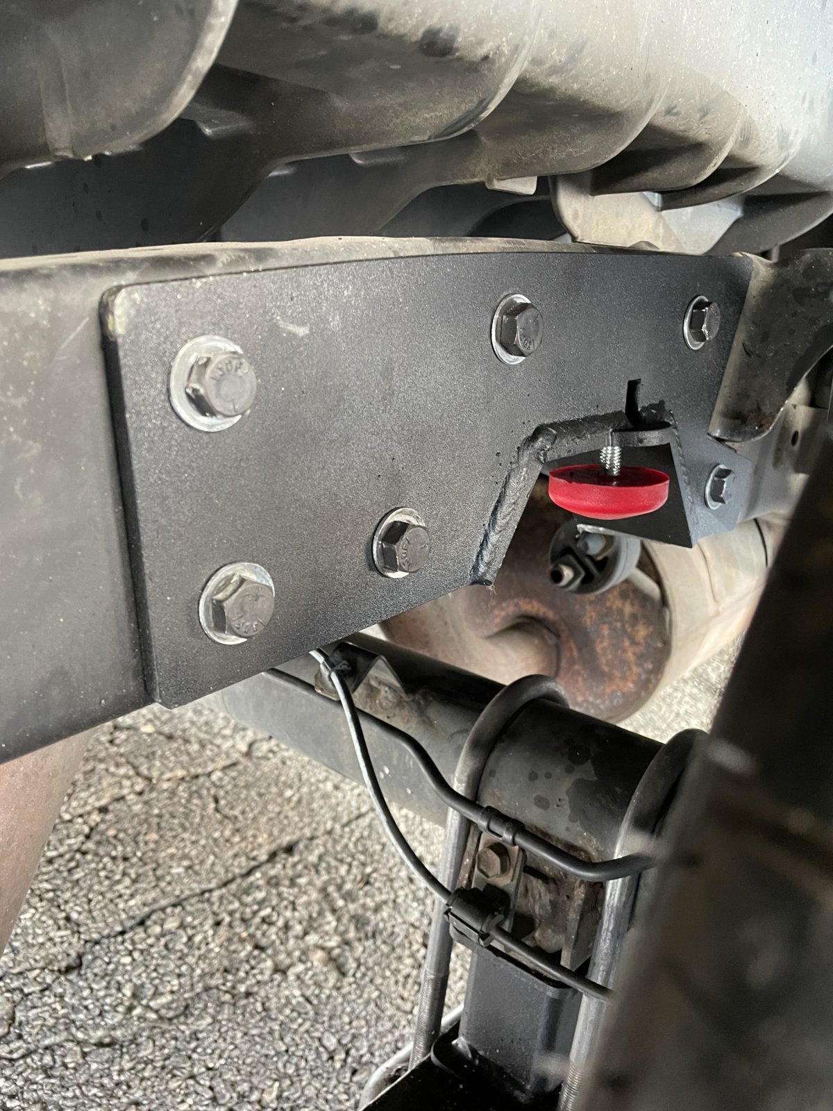

    No djm makes a good kit, comes with new upper and lower arms and keeps the same ride geometry. I also installed xrunner shocks. I ran into someone with the same setup and they didn’t notch and told me they did bottom out a lot, but they use the bed hauling furniture etc. You can also have the notch welded.

    Yeah not a bad idea if you have the means to do so. But for what its worth I bolted the notch in my one truck about 10 years ago and havnt had issues either. Its seen lots of abuse and racing. Also, adjustable qa1 shocks for the rear are a great idea

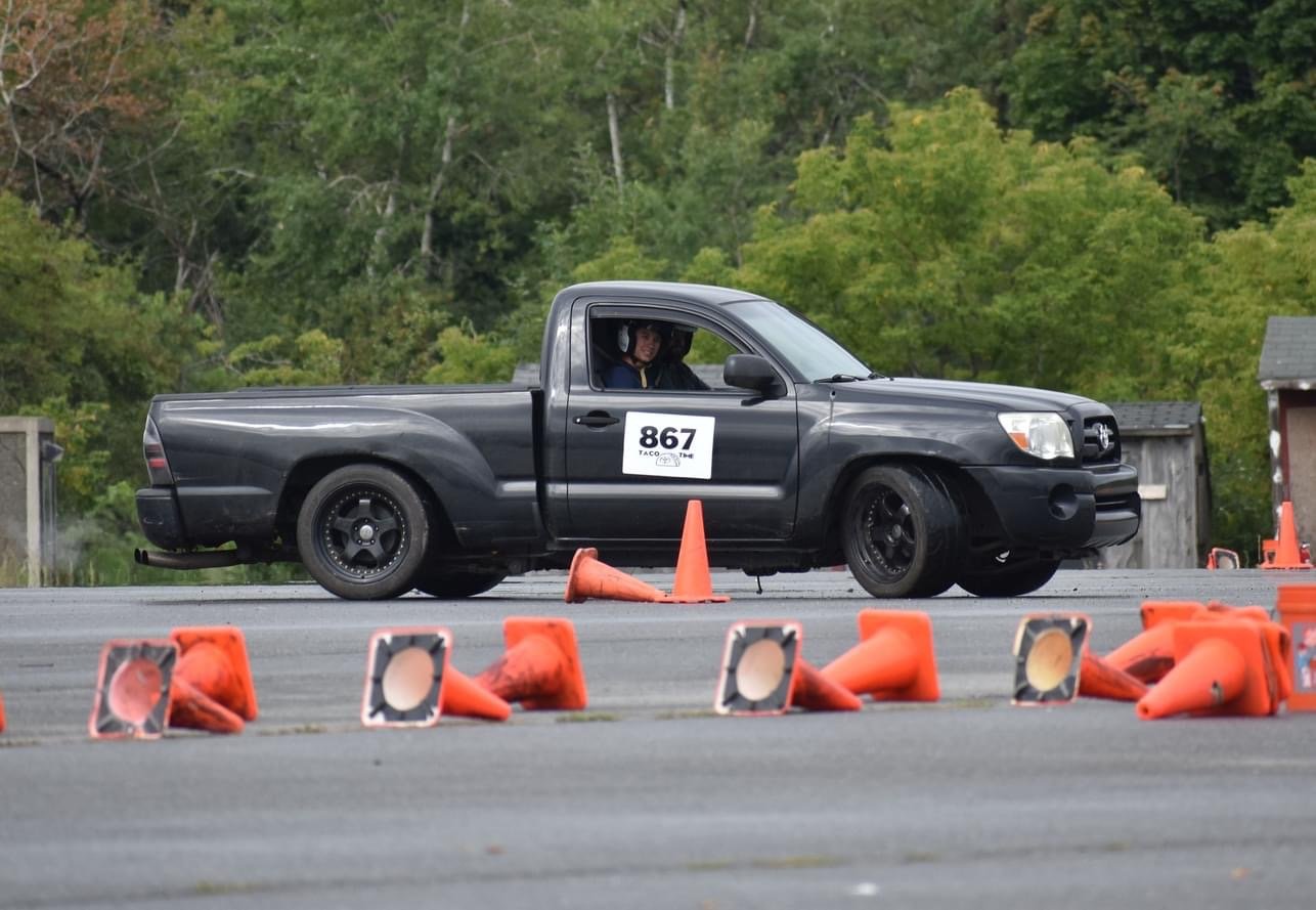

    My .2 cents is the 3/4 DJM kit with the notch welded in. Previous owner to me did that kit on the truck, and then put in a 5in block with 4x4 leafs and it bottomed out hard everywhere. Beat the frame so bad it cracked the replacement frame in two years. So staying with the 3/4 or so is safe. I race the crap out of mine on 18" wheels and I like the look. I'll agree with a previous post saying 2" is the max lowering without the c-notch.

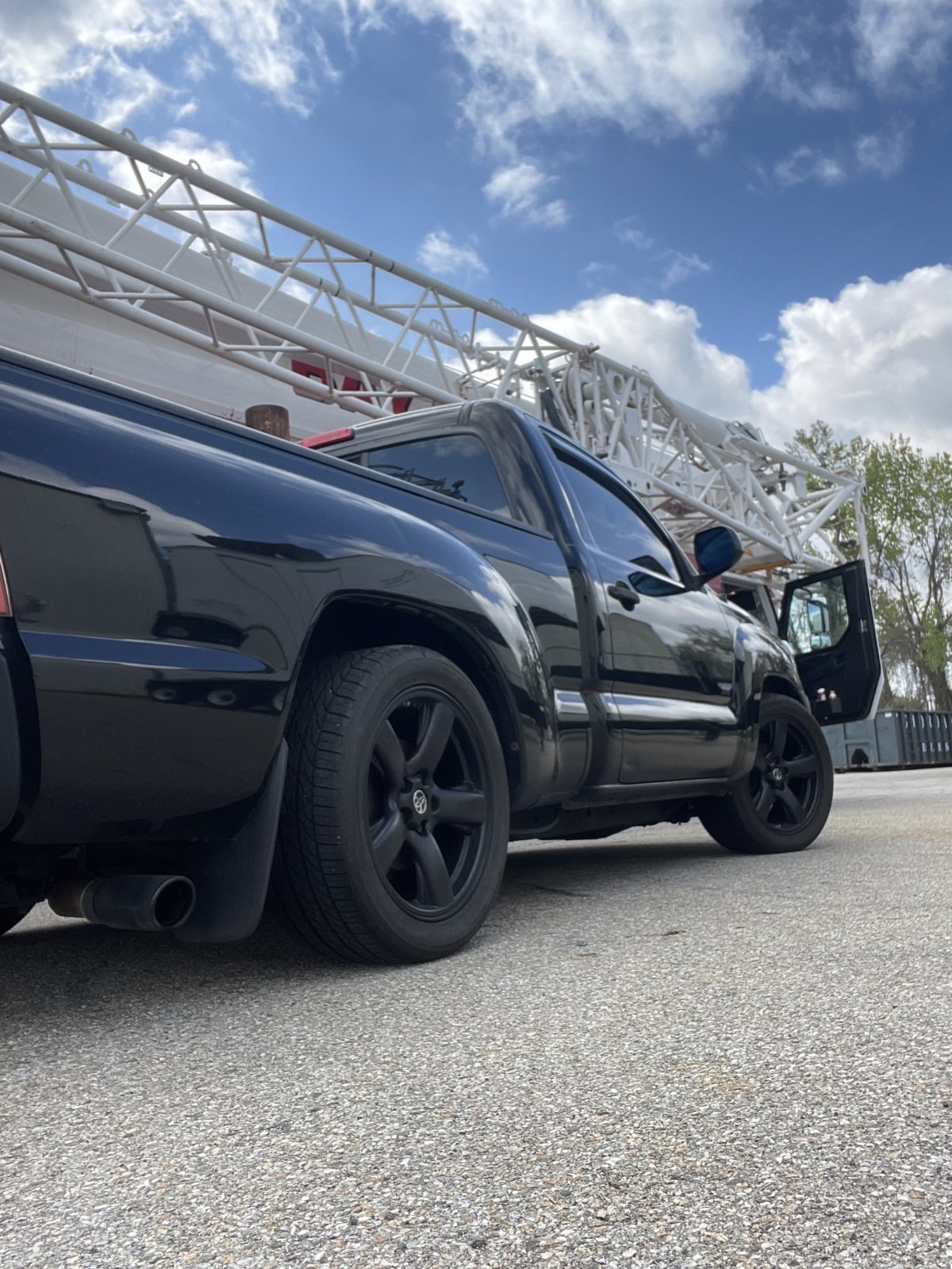

    My truck as it currently sits for reference. I'm about 4 1/4 front and back. (Ignore the body/cab gap, I screwed up a bed mount and it doesn't sit level currently)

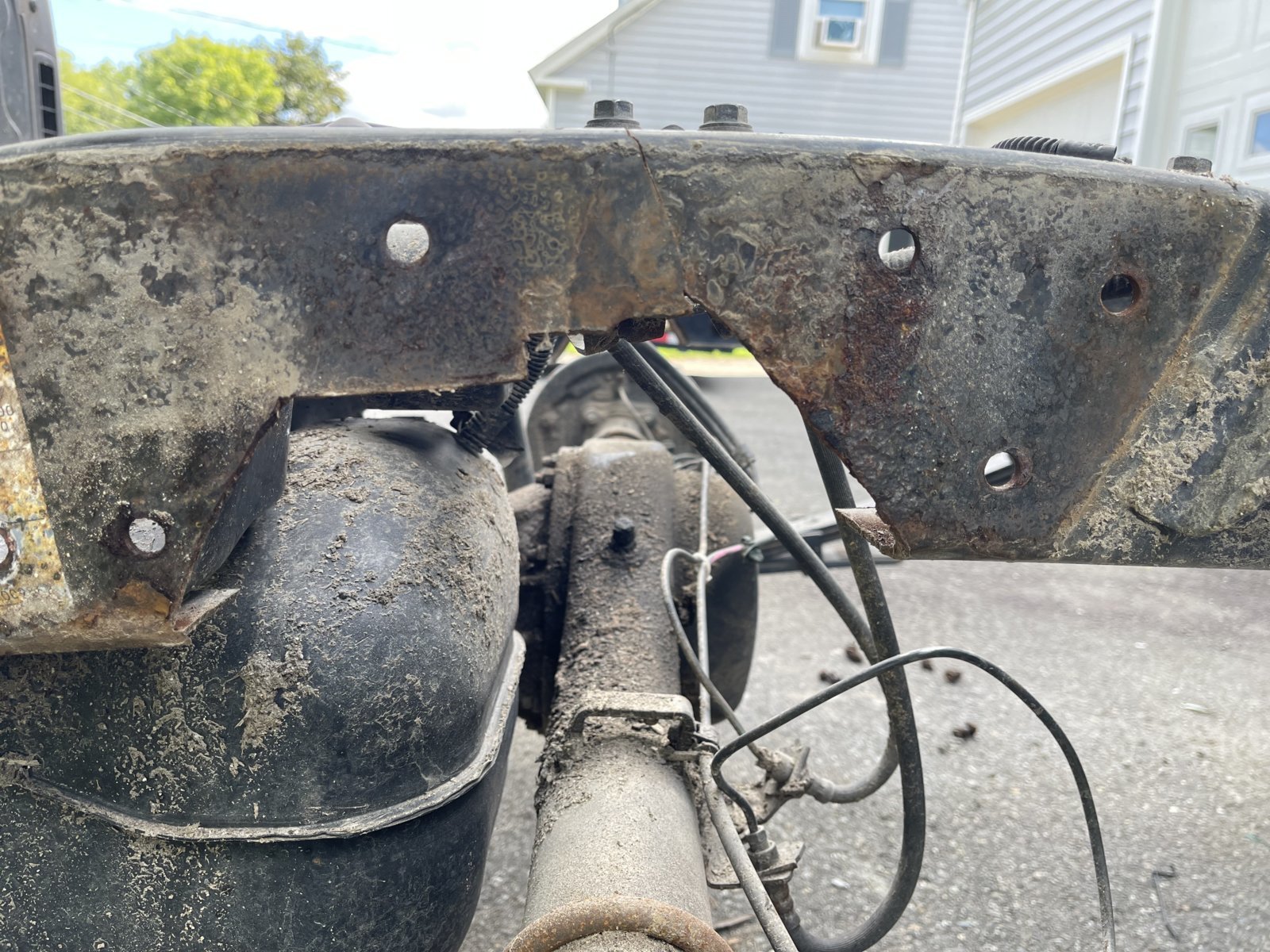

    I do have to point out that whoever cut the frame on my truck for the notch did a very... "less than good" job about it. I still haven't welded my notch in after picking the truck up two inches and welding the crack up. Two years of abuse later and it's doing fine, so having correct ride height is important. If you're slamming your bumpstops everywhere you go it's not good for the vehicle. See the photo for how not to cut...

    Holy hell, what a hack job! I can see how that cracked lol
