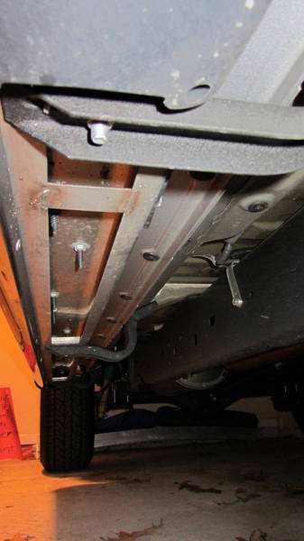

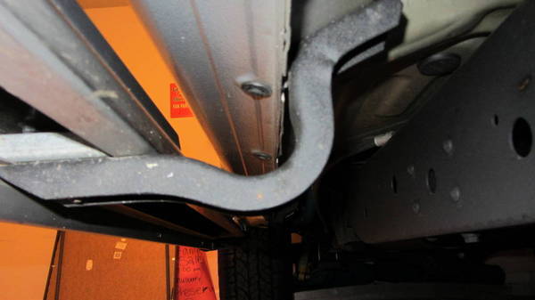

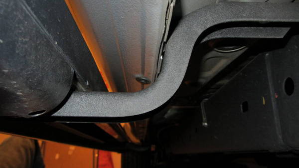

    Here are mine.
    [​IMG][​IMG][​IMG]
    Notice the 2nd pic (front bracket) is shaped different than the middle and rear brackets.
