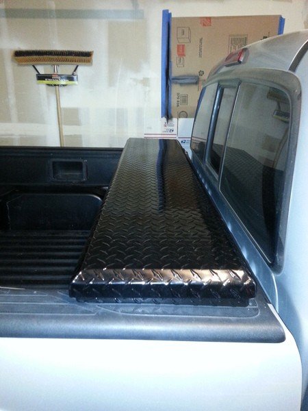

    I went ahead and got the silver one because it was easily available and so inexpensive. I cleaned it with acetone, roughed it with sandpaper then used self-etching primer and flat black spray paint. image.jpg
