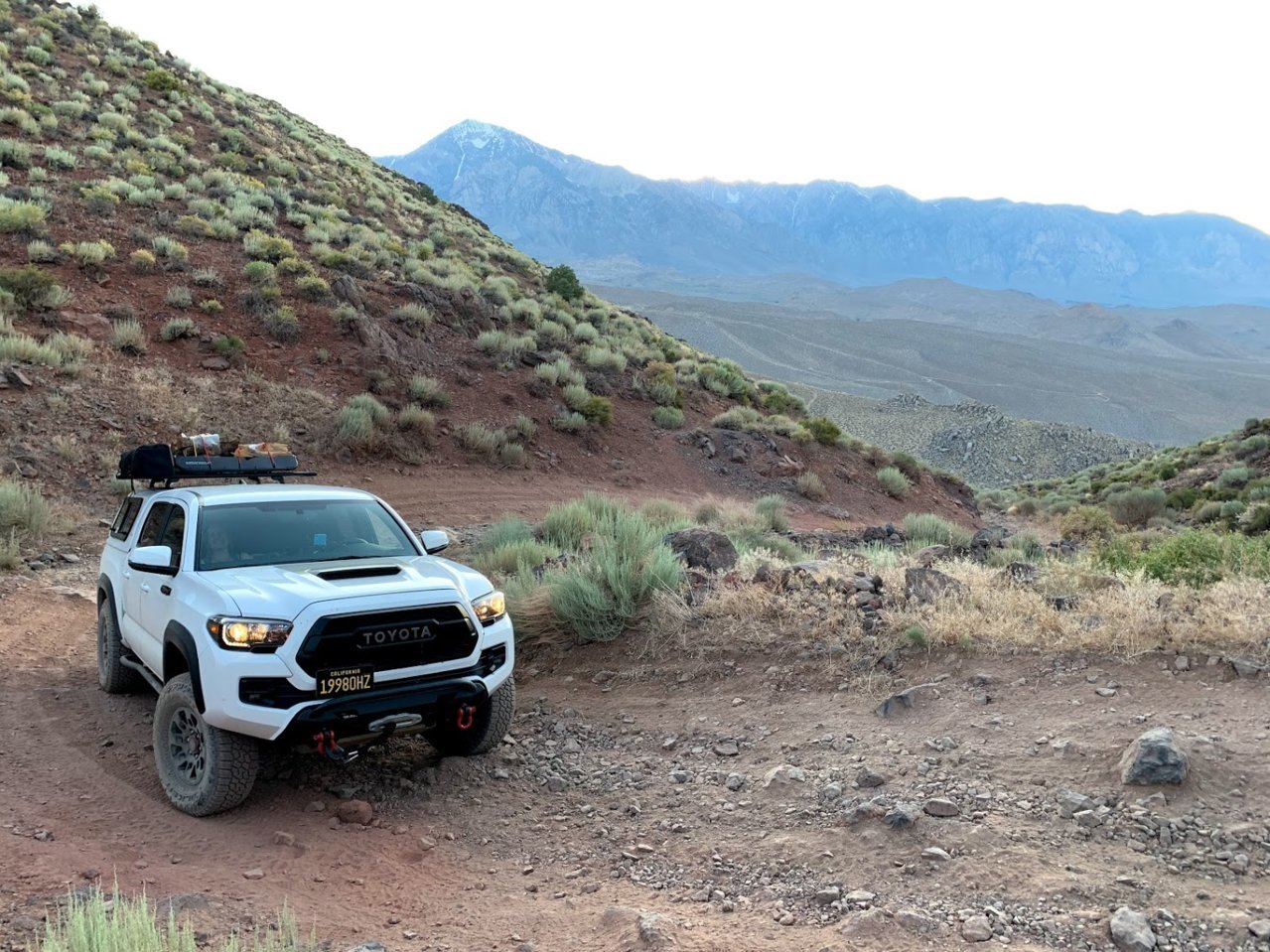

    And because this thread is worthless without pics, here's my truck up at Coyote Flats last month. Cheers.

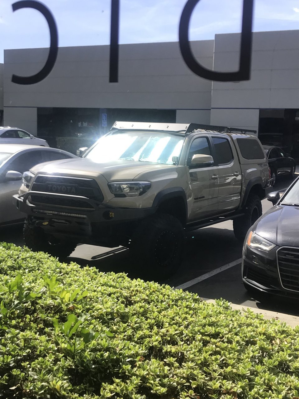

    thanks for the note! I went with the Rhino Rack platform on the Smittybilt AM mounts (used six of them, it's solid!) The Lock n Load looks interesting but I couldn't get the Yakima HD bars to stop from moving around offroad w/ a load on them. So far so good w/ the Rhino though. The Offgrid basket mounting on it isn't great but I'm going to build a little bracket and I think it will be OK.

    Nice pix and plate!

    sweet thanks for the update, i had been looking at rhino rack too. i hate my current set up with the basket on top of the bars, it's so high up off the top of the truck. thanks for posting the pic i like that it's pretty low profile, exactly what i'm looking for :thumbsup::spending: do you remember what the dimensions are of the rhino rack? i have the long bed but i've been meaning to get out and measure the width between the tracks on the topper to get an idea

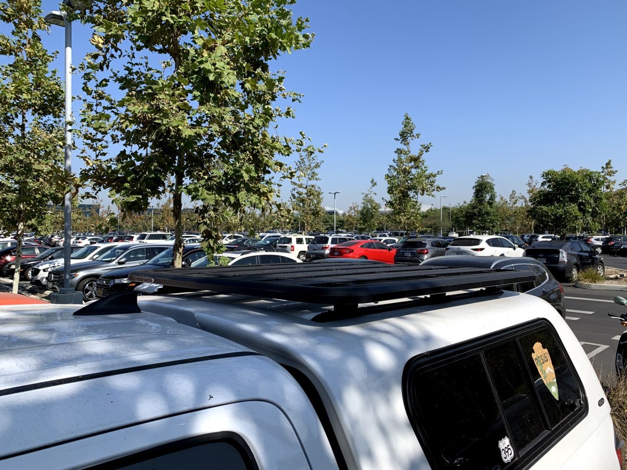

    I got the 52" x 49" model for the short bed. With the Smittybilt mounts it's just under 2" of clearance at the center point of the cap--I think you could maybe sneak it even tighter with more effort but it's low enough for me (and like 4" closer than the Yakima bars put anything.)

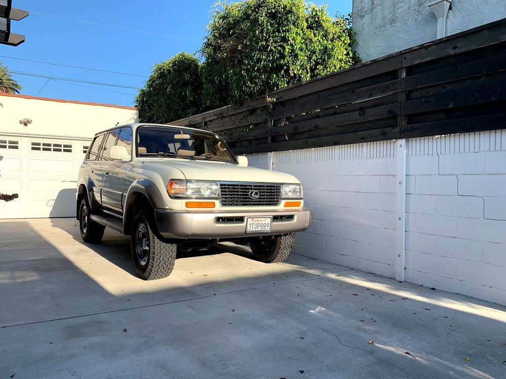

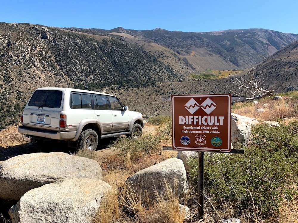

    Haha, who am I to stand in the way of scientific progress.
    It's triple locked so someday it will leave my Tacoma in the dust offroad, but without any armor I don't want to push it yet.

    sweet, thank you. that is plenty close enough to the roof for my needs!

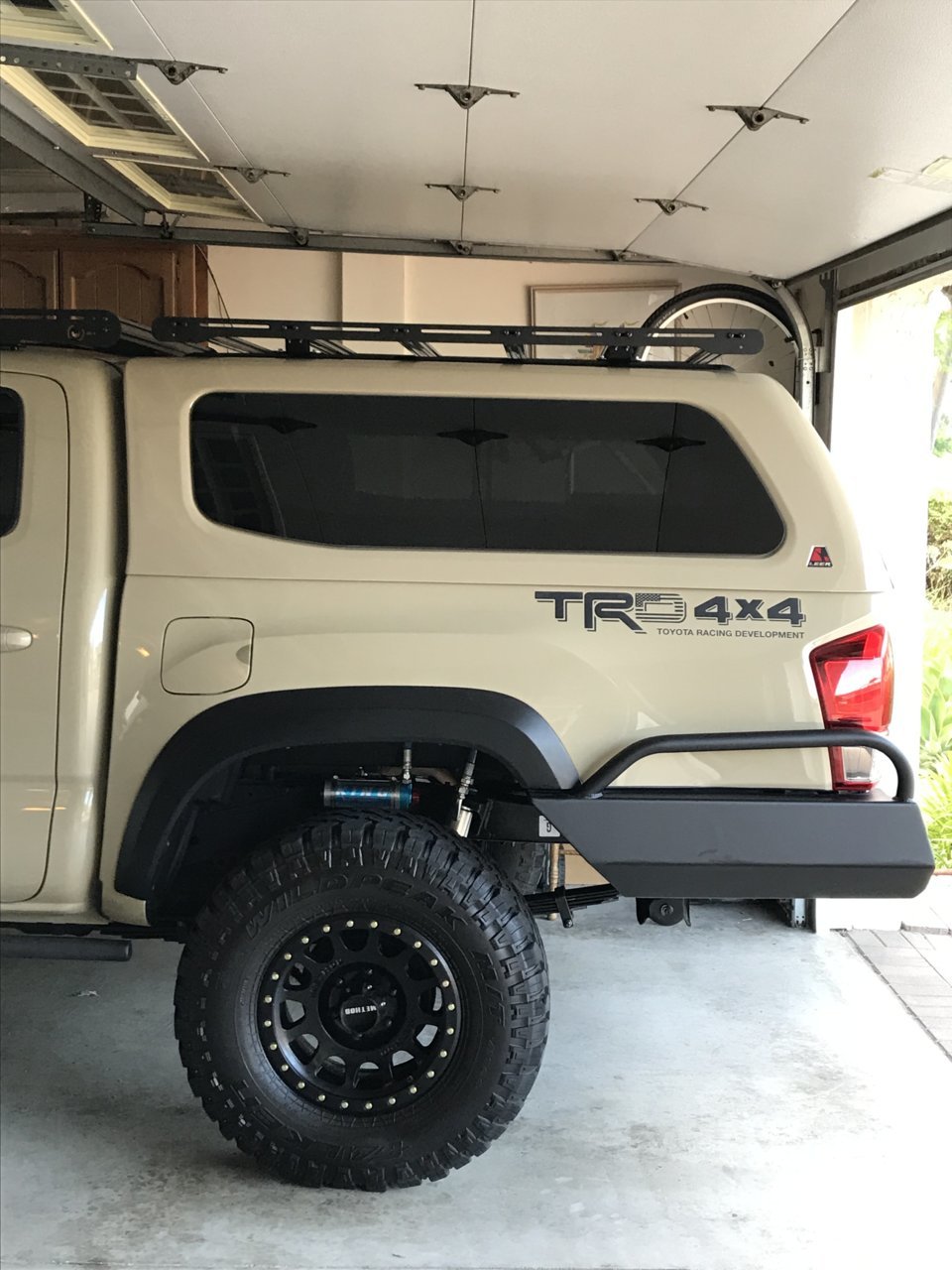

    Prinsu for scale
