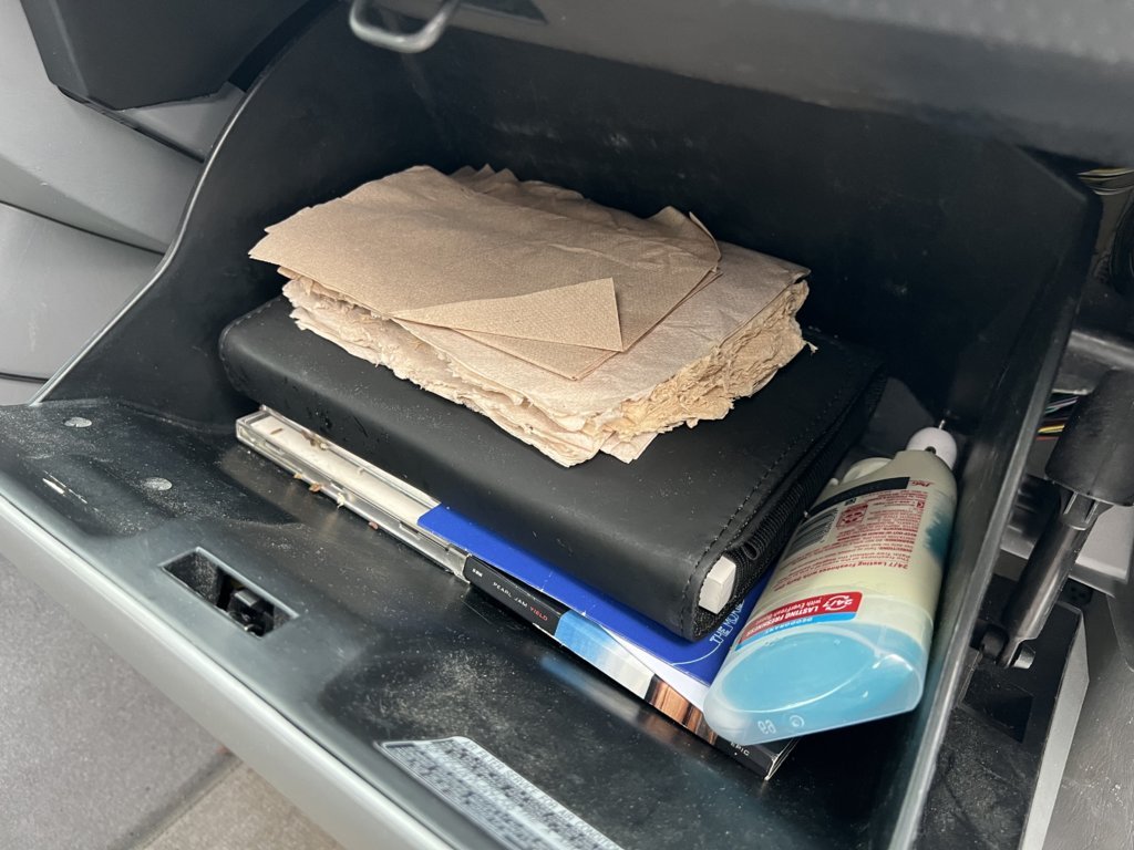

    My wife and I just got back from a 10-day honeymoon, and upon returning to my truck I discovered that I wasn't the only one enjoying the warm cab. Attracted to my exquisite music taste and totally not the stack of napkins, a mouse had set up shop somewhere in my truck.

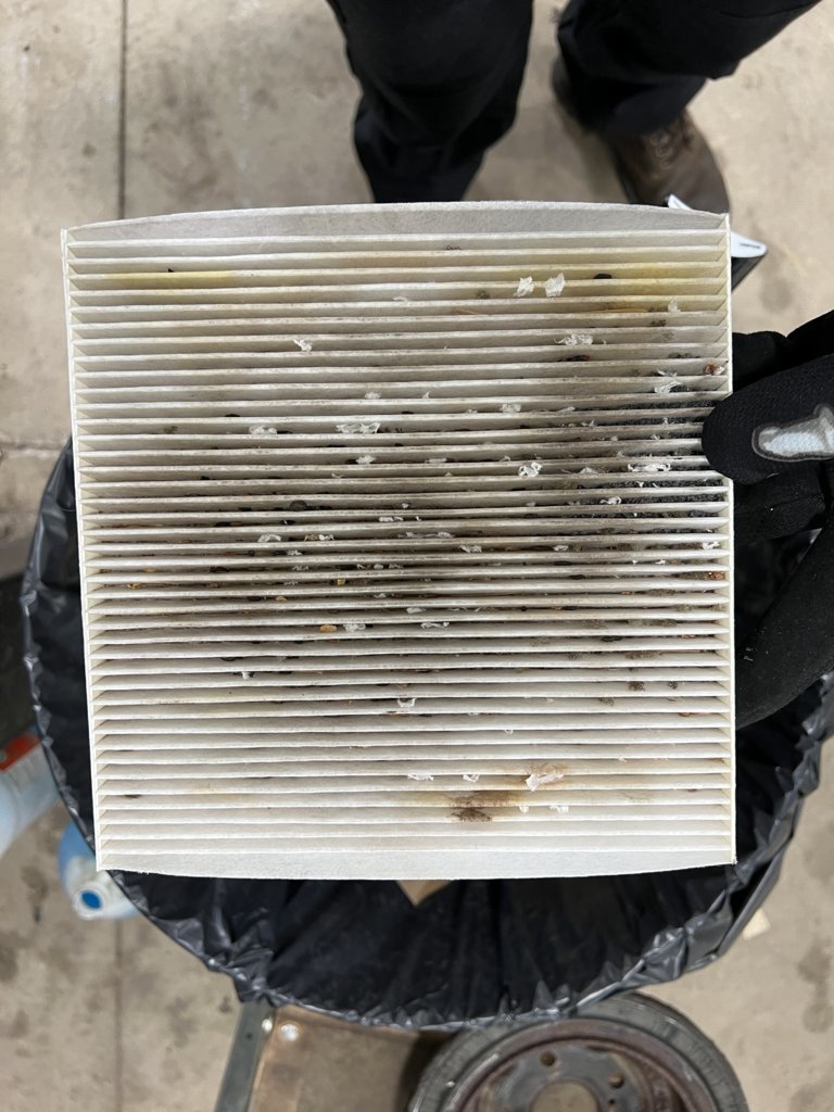

    I cleaned everything out and removed the cabin air filter. While my friend hadn't chewed through the filter, he had made a good mess of it.

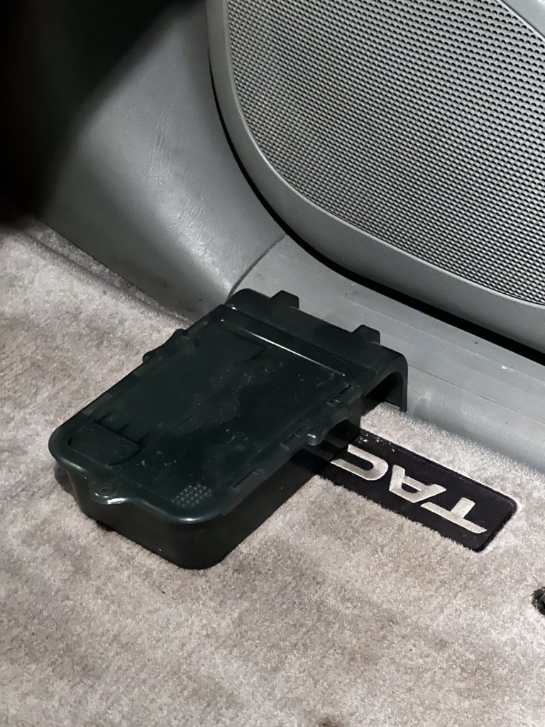

    I set a live trap, armed with pieces of the finest store-brand string cheese, and sure enough, I caught the culprit the next morning.

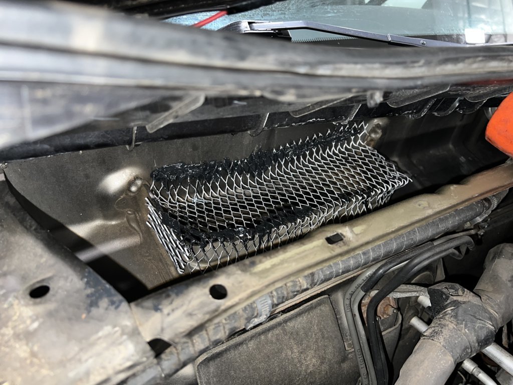

    After relocating the stowaway, I decided to follow BlackBeerd's thread "Cabin Air Intake Screen Mod," and hopefully deter any more visitors.

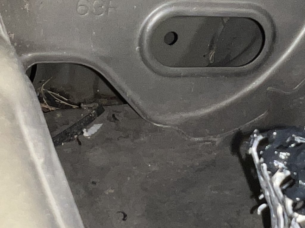

    I drive my truck daily, so I'm not too concerned about them returning, but if I can do anything to help myself, I will. While I was installing the mesh, I found their entrance. I'll be putting something over the fender holes once it warms up a little.
