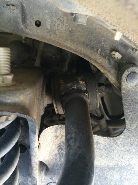

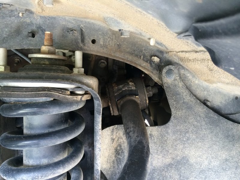

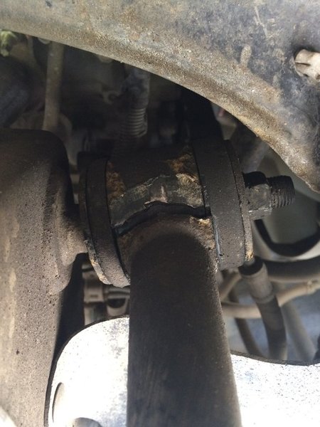

    I noticed my suspension making some noises over the past week; I figured things just needed to be re-torqued. Today I go to take a look and find this. I haven't done any off-roading recently, only daily driving to and from work (8 miles). I bought the UCA's brand new about 3 years ago, so about 50k miles on them.
    I need some advice... Is this a known problem with LR UCA's? Anybody have a similar experience? Will they help me with something like this?
    Also, is it ok to continue driving with this? I don't know how long it has been like this, but I can't imagine it happened too long ago.
    Thanks for any input.

    Yup. Give LR a call and they will get you out a new one. They have been really good with CS, especially when they see this kind of stuff happen

    It looks like you have the older style setup with 4 washers on each arm. Two on the outside and two on the inside of each side of the arm. They now use only two washers per arm, both on the outside.
    Are those the original bushings? If so they have changed those as well.
    I'm sure LR will send you some new arms.

    Old style arms / old style bushings / old installation specs

    The old arm design usually suffered from this failure because people torqued the bolts with the truck on the hoist and then when the truck was lowered onto the ground , the rotational forces of the bushings were being tranfered to the arms resulting in the breaks at the arms where they meet the bushing housing
    The new bushings stop this issue from happening

    As far as driving it the crack is bigger in the last photo than in the first photo...

    I spoke with a customer service rep today and they're sending me a new set. Customer service was great, and he said I'll be getting the new design. Obviously, I'm still upset about the performance of the one that broke. No way that should happen in the first place (especially commuting to work and back). We'll see how the new ones work out.
