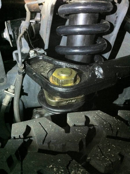

    Are your ball joints set up with the SPC logo facing out and the ball joints all the way out, as far as the camber adjustment?
    Such that they're like this:
    this is apparently how the FJ guys are running theirs and getting aligned fine, it's also where I put mine. I was concerned at first I had it set up wrong but I figured Big O would change it if needed for the $90 I paid. I'm thinking now I had it right.

    Dark here in SC. Don't know if this helps. My buddy was able to align it with only the factory adjustment points.

    Helps a ton! Thank you!
