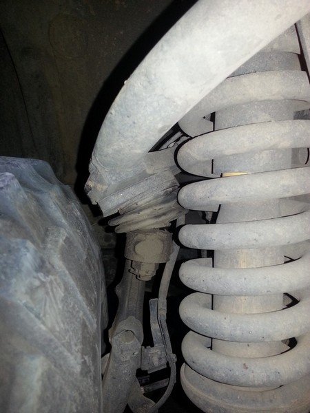

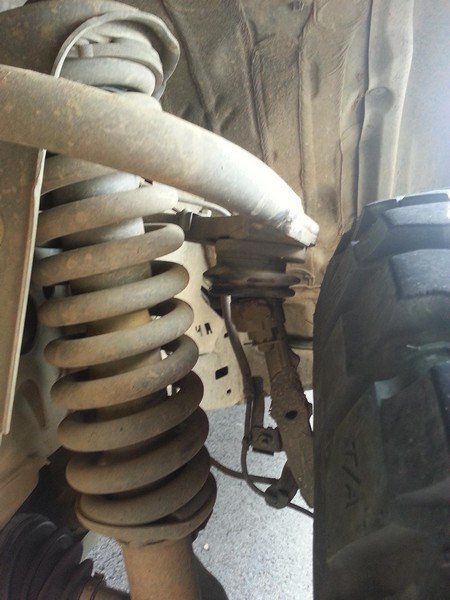

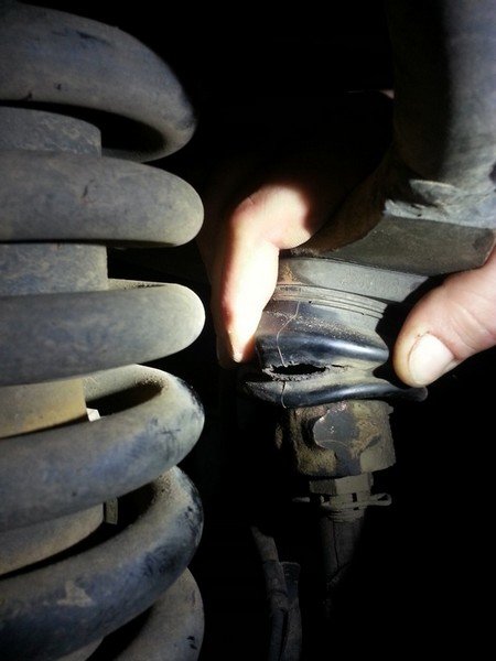

    1. My UCA bushings are worn out and I have a tear in the boot of the driver's ball joint. These are light racing UCAs. . Should I get new BJs or just the boot?
    2. Do you guys have this problem with the boot contacting the coil? Am I doing something wrong?

    hm thats strange, mine don't even come close.

    I just replaced the boots on mine because one of them had a tear in it. After clearing all of the grease off the internals, I found zero sign of water or corrosion, so I regreased them with a synthetic lithium grease and put new boots on. If you didn't grease them initially when you first installed them, you may want to check their integrity before just replacing the boots as they don't come with enough grease to hold up over too long. I haven't had a problem with the BJ's contacting the spring, but I know others have, so they found where it contacts, and, depending on what strut set up you have, either turn the spring, or rotate the strut assembly.

    I'll see what I can do about rotating and inspecting. I need to check passenger side for the same effect.
    OME lift with 886 springs.
    39,780 miles on the UCAs.

    I think the spring cup on the OME's floats just as on the BLSTN 5100's, so you may be able to just rotate the spring.

    I sent pics and I talked with one of the techs (the offroad guy was out, so just a standard tech).
    He suggested:
    1. Replace the bushings to see if it limits downtravel
    2. Adjust the control arms so that the LCA is fully in and the UCA is fully out (or the other way around, I can't remember)
    #2 seems like a bad idea because that totally screws up camber, right?
    I'm going to try the strut rotation and pray for the best.
    SPC said they are really interested in solving the issue and working with me. They are super prompt and seem like a good group.

    My driver's side LR UCA boot hits the spring at full droop, and hits it hard enough to tear, but not the passenger side (it does come close though). All settings are done correctly (completely out away from the truck, turned to correct direction). I just can't figure it out. I had the same issue running 885's and 886's, both with Billy 5100's set to 0. Everything else in the front is stock.

    Benson X came over and we did some looking. It seems my driver coil needs a bit of rotating, but the passenger side is fine and still touches. I'll throw up pics tomorrow.

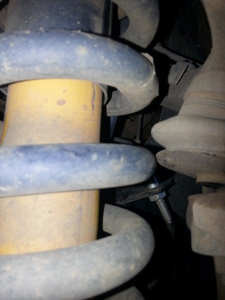

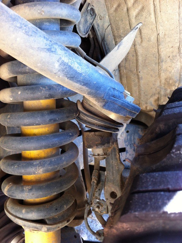

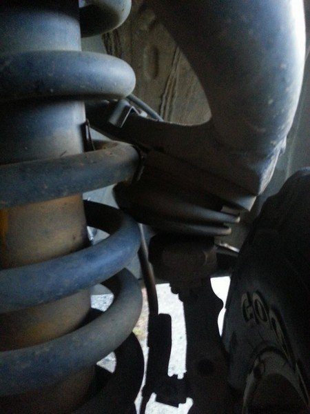

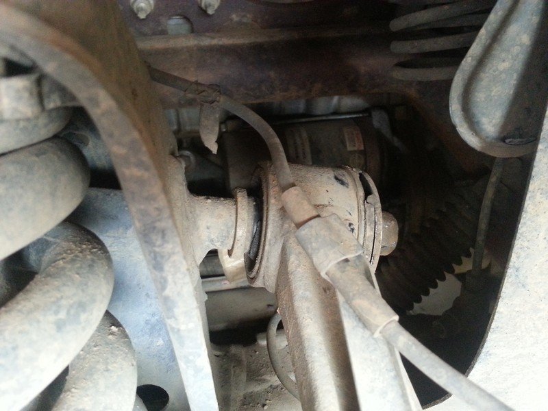

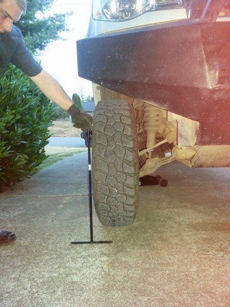

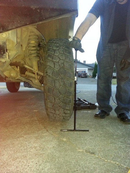

    Alright so here's all the research I could manage from last night
    This first photo is my truck taken about 9/21/2012 when my tires were new, so nothing has really changed.
    The rest are from last night. I compared to Benson X's truck. Not directly the same, but as good as we could do.
    Mike's truck: OME 886 coils, OME N140S shocks, 255/85/16 BFG KM/2, sway bar removed
    Ben's truck: OME 885 coils, OME 90k Nitro shocks, 285/70/17 Goodyear Wrangler MT/R (old style), sway bar removed
    Mike's truck
    We adjusted the driver's camber as far positive as we could go at the UCA ball joint, leaving the LCA alone. The passenger was already fully positive at the UCA.
    We weren't sure how to show off camber, so here's our not-so-scientific evaluation with the front fully lifted. The bar that Ben holds is more or less perpendicular to the ground, the truck is as level as we can attempt. Not sure what this proves, but we felt like you might like seeing it.

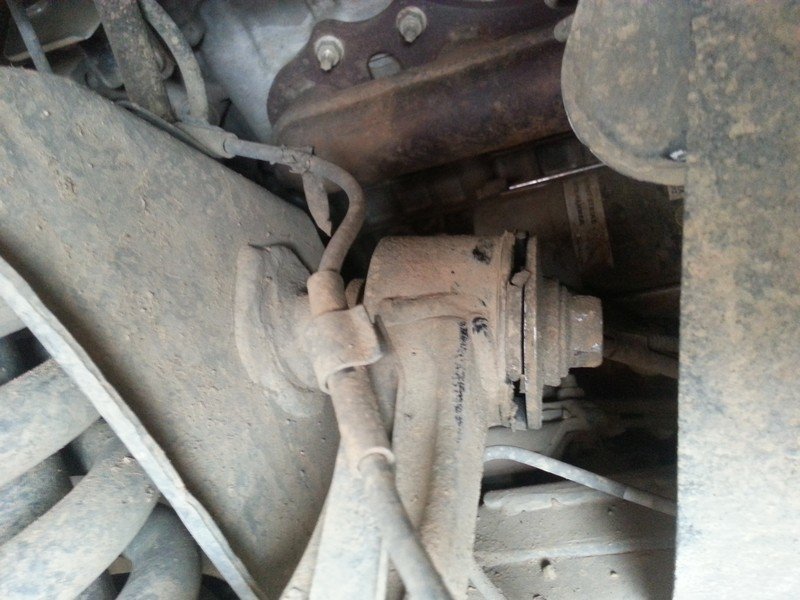

    Here is a view of the old-style bushing that I will be replacing this weekend. New bushings will be SPEC-RIDE.
    Driver's side at ride height
    Driver's side torn boot. I will be replacing the entire BJ this weekend.

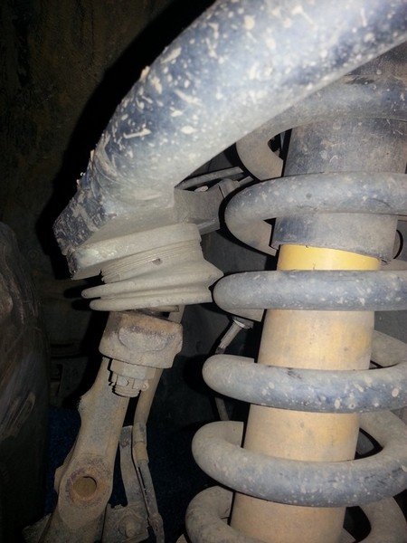

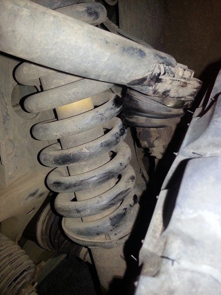

    Driver's side at full droop. Notice the SPC logo is facing outward
    Passenger full droop. Making contact on this side as well.
    Ben's truck
    Driver side full droop. His touch, but only the lightest amount, thanks to the spacing between the coils.
    Passenger side full droop. Again, only lightly kissing
    Notes/Thoughts

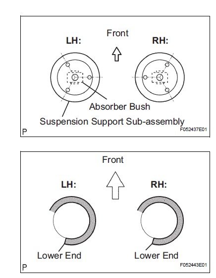

    One of the things we found is that my entire driver strut needs to do a 180°, as you can see from this service manual excerpt. The seating in the cup is fine. Please compare the below pictures to the first picture of my post
    The other thing to note between my vehicle and Ben is the different coils. I'm not sure if the diameters are any different (coil wrap or the actual metal), but the frequency of coils is increased, so where he has a void, I have another coil. I'm thinking that whether you hit or not is sometimes if you are within a void or if you are tapping.
