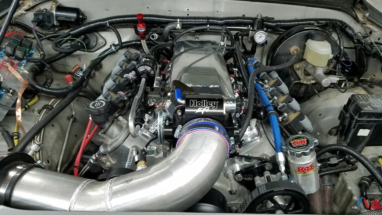

    2006 White Tacoma
    LS Swap with RSG Tranzilla, Custom hi clearance front bumper, Relentless: Slider's, bed rails, rear bumper, Prinsu with 40" BD s8. Dirt Designs 3.5 LT. Archive Garage rear towers/shackle flip/SUA. King Air bumps. King LT Coilovers in front. King 12x2.5 in rear. ARB rear air locker and twin compressor. SCS f5's with 33" Ridge Grapplers. 20" S8 mounted in bumper, squadron sport fog lights, squadron pro backup lights, LP6's bumper mounted.
    heres mine as i was finishing it up back in February. She rips now for sure. For the Tach i used a dakota digital converter box, i have a psi conversion harness that just has an easy one wire out for tach to the cluster.

    MMVI 4.4L 4x4 Access Cab
    Torspd Custom Turbo kit [] Borg Warner 9180EFR Turbo [] Haltech Elite 2500 [] TiAL Q BOV [] TiAL V44 Wastegate @ 15psi [] CP Pistons [] CP Carrillo Rods [] ARP Head studs [] ARP Main Studs [] ARP Header - Head Studs [] Ported Heads w/ 1mm oversized valves intake/exhaust [] Brian Crower Forged Stroker Crank [] Darton M.I.D. Sleeved Block [] Kelford Camshafts [] Torspd 160* T-stat mod [] APR Large Fuel Rail [] Walbro 460 LPH E85 Fuel Pump [] FueLab FPR [] APR T56 Conversion Kit [] KP RACING Built T56 [] McLeod Racing Custom Twin Disk Clutch [] One Piece Aluminum Driveshaft [] MGW Shifter [] Custom lowering kit [] Ohlins Front Coilovers [] QA1rear shocks [] Custom Ron Davis Radiator [] Dual SPAL Electric Fans []
    Well done on the build.
    Curious. What is that tube for that protrudes from the passenger firewall?
    it was for my cowl intake for the v6, it’s too small for the Ls.

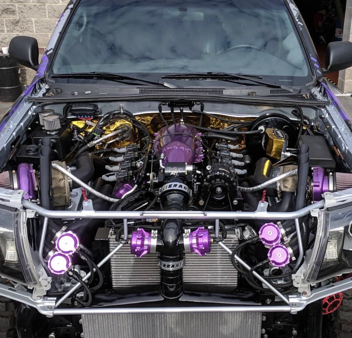

    05 Tacoma LS Swap Twin Turbo
    Alot
    you can use a standalone like me AEM and it can control the gauges. It has alot of adjustment to match actual rpm eng temp. etc.
    Torspd likes this.
