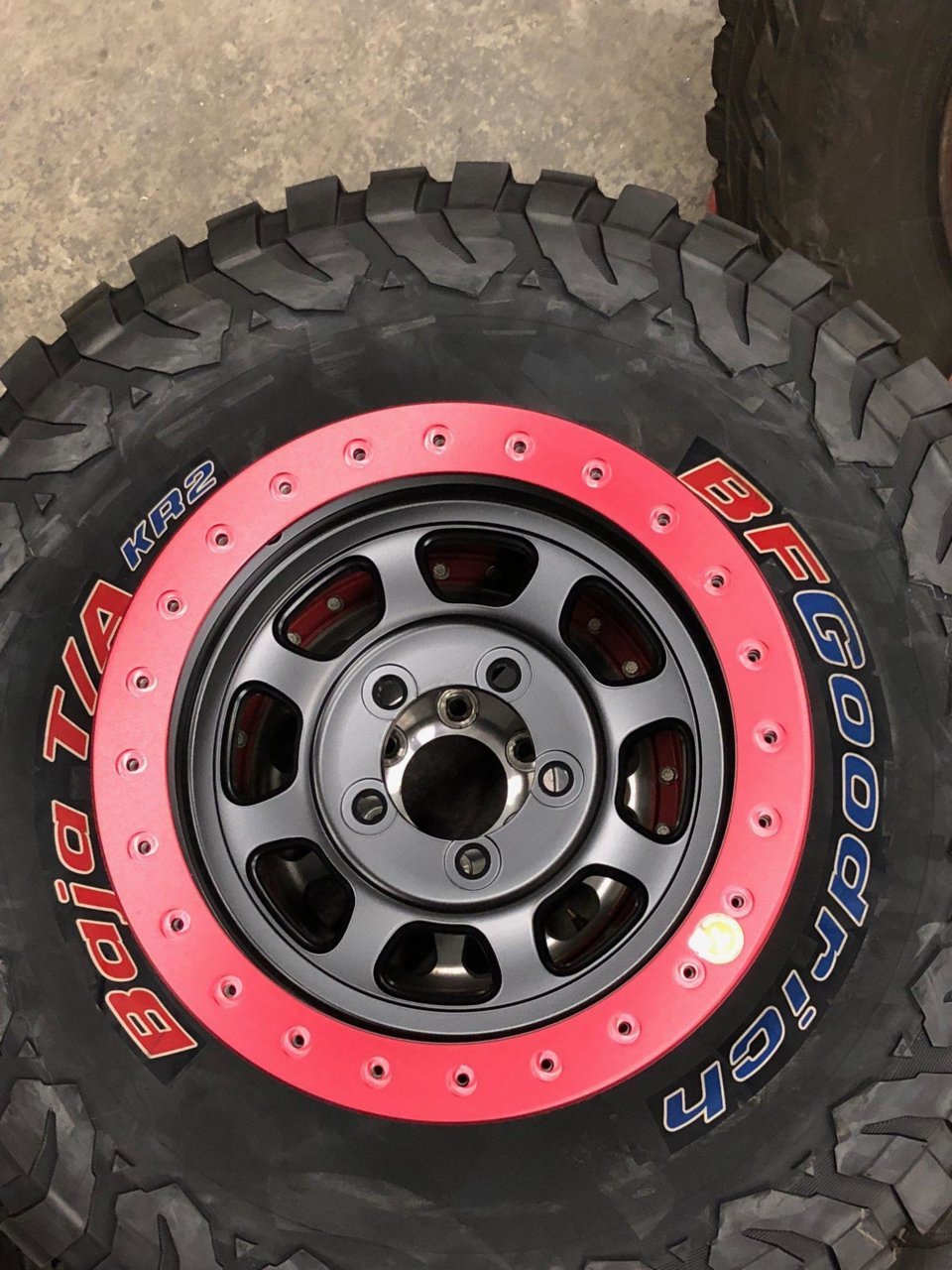

    If I were you, the 5.7 would be way more interesting. We have TR beadlock 17x8.5 that we are considering and a full float 40 spline rear axle assembly but it is spooled. My son says try it and decide. TTR Bead locks BFG KR2.jpg he TRs would bolt on rear axle assembly, and adaptors would be required for front. We installed tundra brakes a long time ago, although we have race brakes if needed. We are sicking with auto transmission and 4wd. We should be back at it next week. I will pull motor and start reinforcing frame, put motor back in and tack engine cage, pull motor complete cage. It has king 8" coilovers and 10" king bypass shocks. My son wants to change shock mounts and install the 10" coilovers. As far as radiator, not clear what our plan is until we get further along. It had dual batteries prior to swap. My son also has bedside panels, which not clear about. I think he is thinking lose the bed and build tubing. This is all bit much when all I asked was could he help me with more horsepower lol. Our goal for completion is end of Dec early Jan.

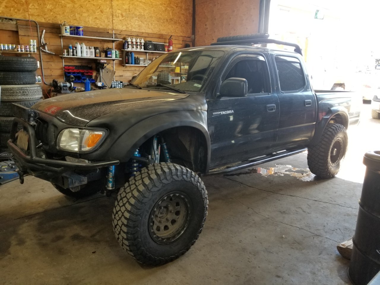

    I agree about slow corners and parking, but my son says I should try it. Here is photo prior to engine swap tacoma.jpg
