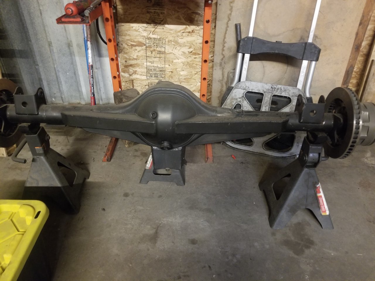

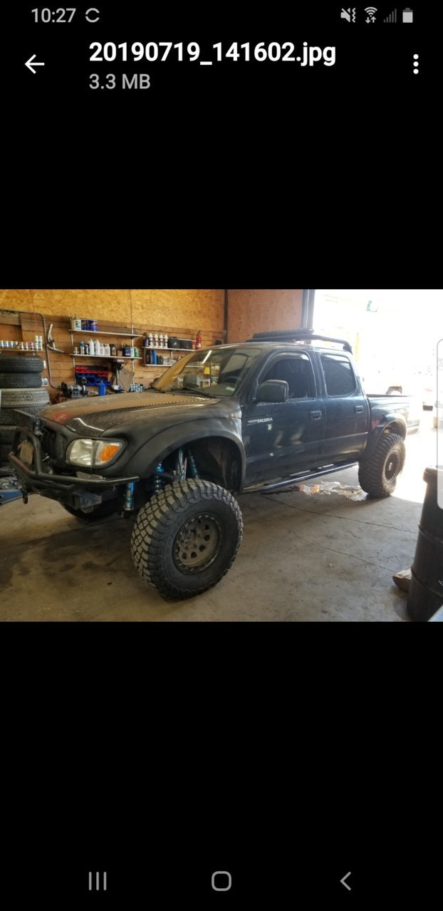

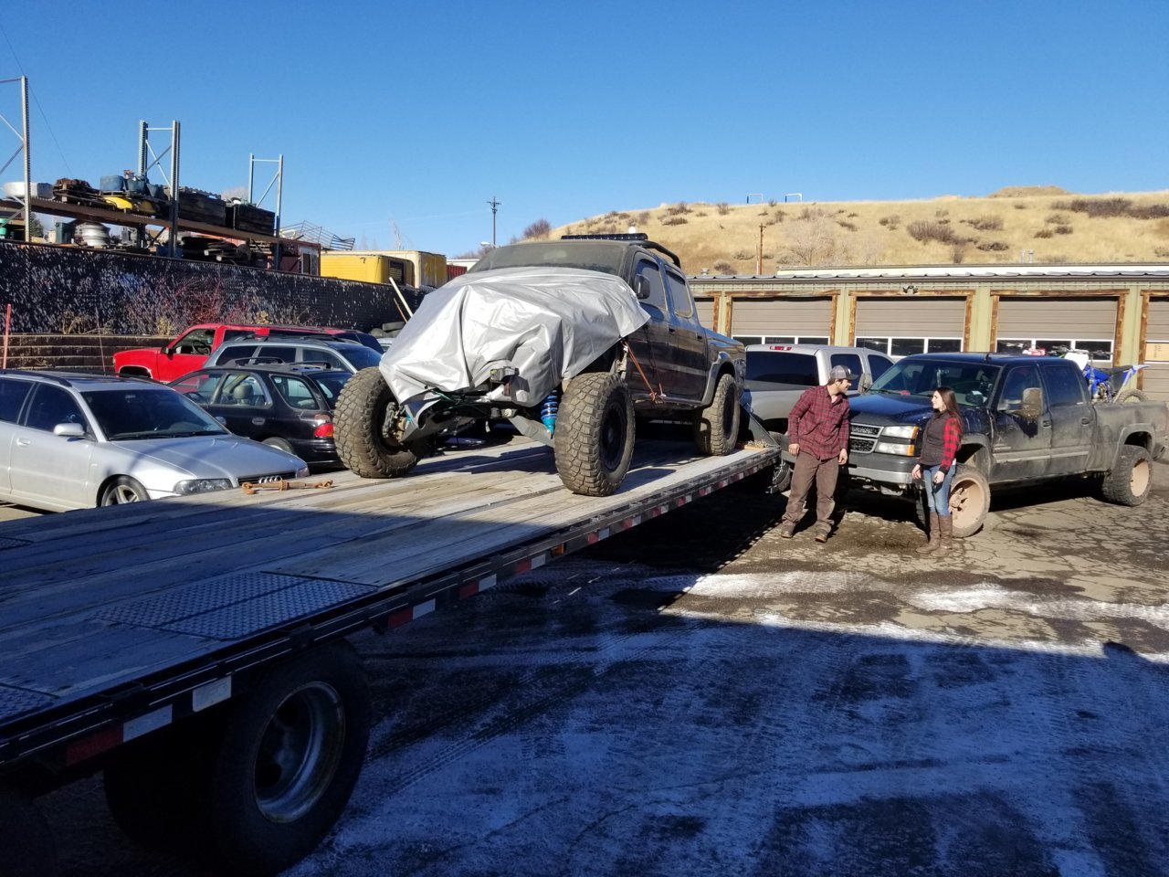

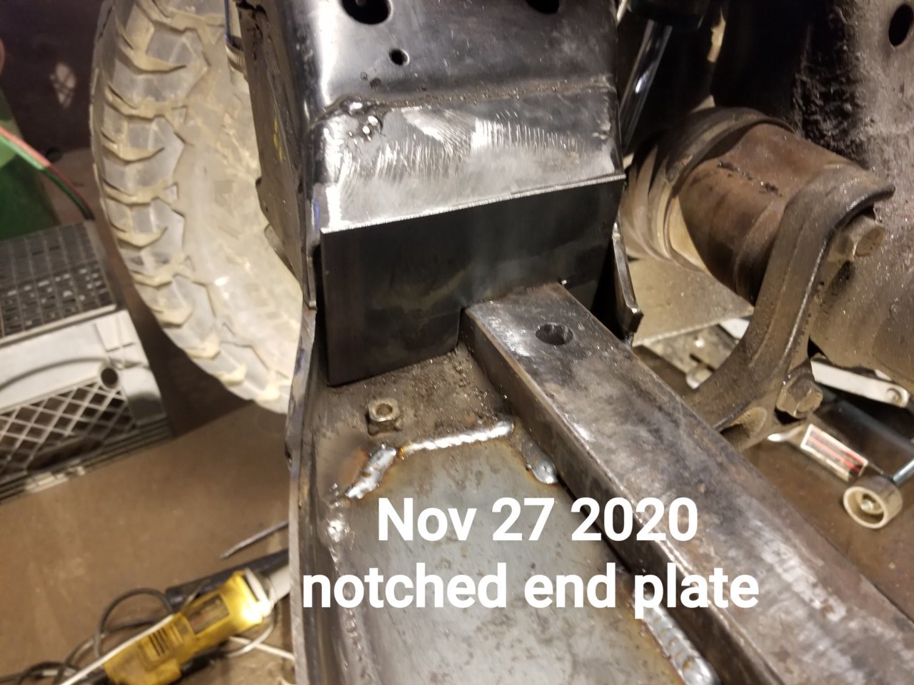

    I will ask my son, but I do know I gave him 500 bucks to buy an old farm truck. 5.3 4l60e. I assumed anyone could do the same. As I look around, apparently the motor tranny was probably worth 12-1500. My son knows a lot about trucks, although specializes in Diesel. We live in small town Colorado. He took a job in Utah and took the Tacoma 20201127_203847.jpg

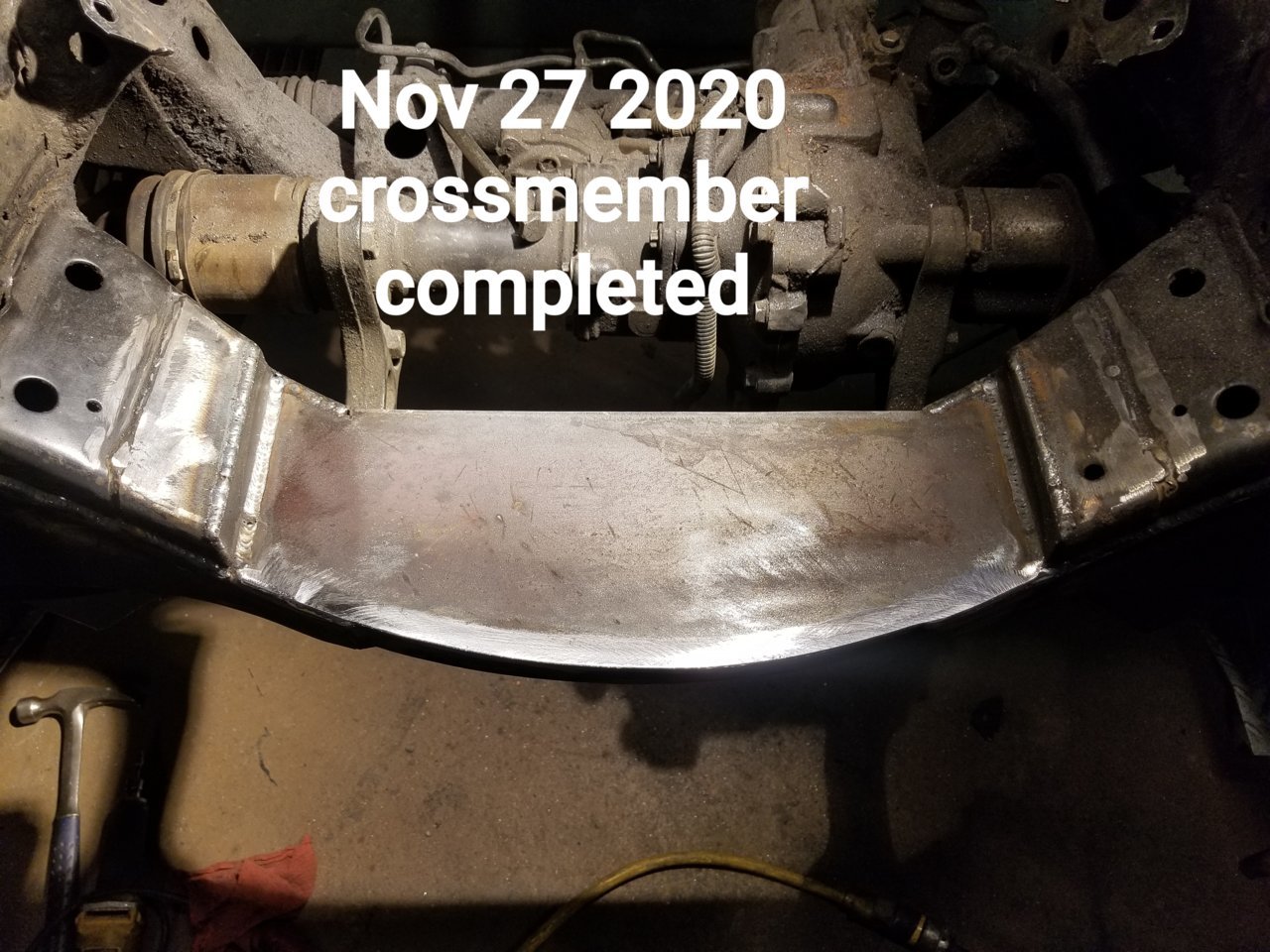

    He knows how to make so nice welds too. Getting it done!

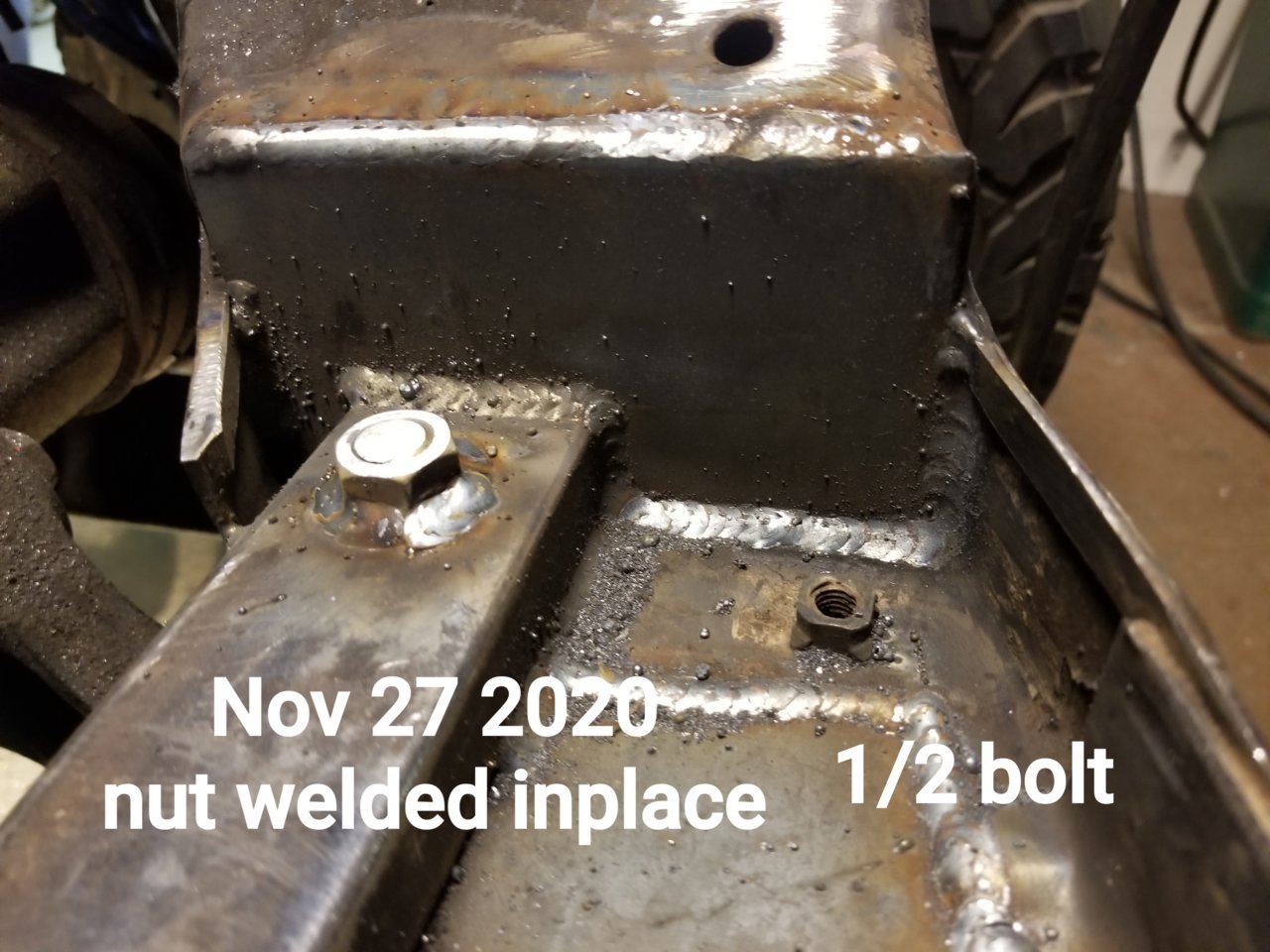

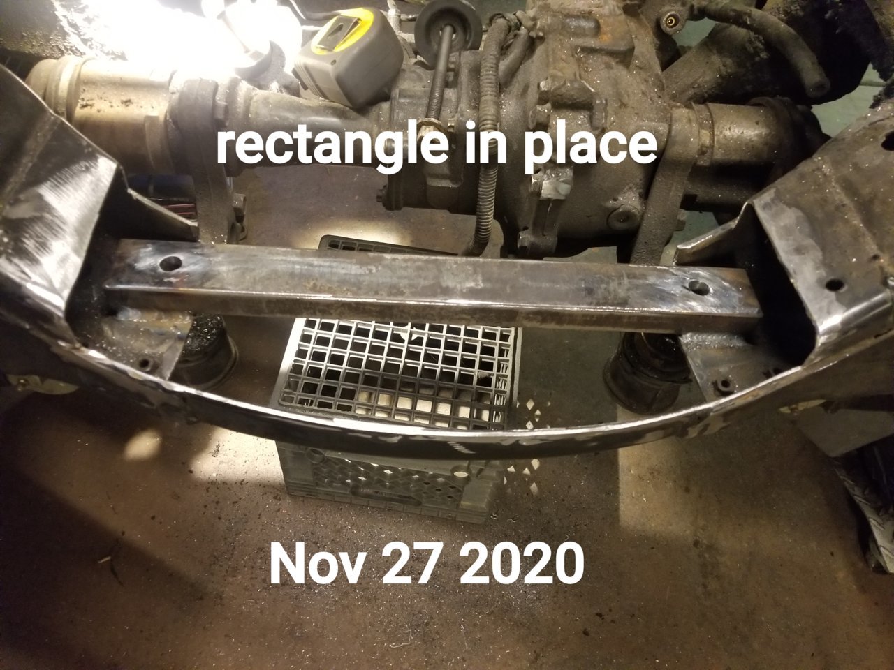

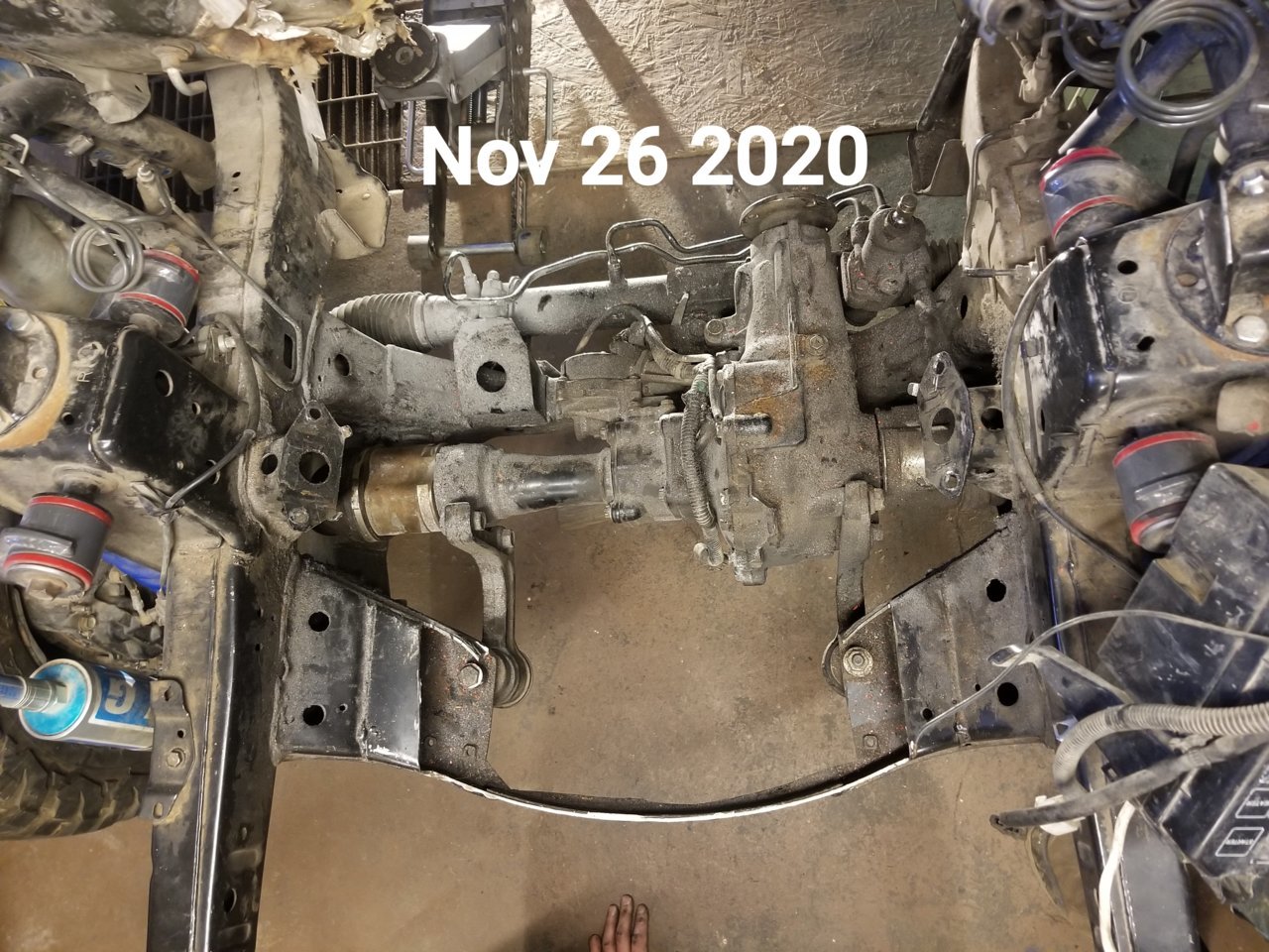

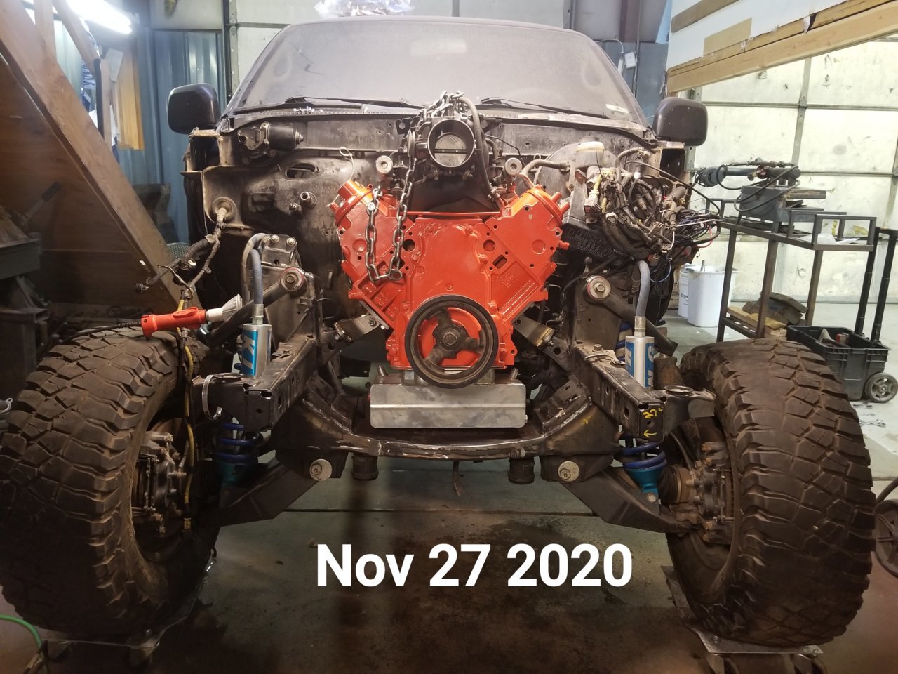

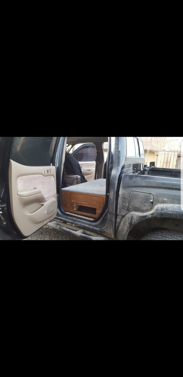

    It is a group effort for sure. Here is pic before swapScreenshot_20201106-102717_Gmail.jpg
    Rear seat out and storage chest built in place. The under carnage is 3/16 Steel nose to last carrier.

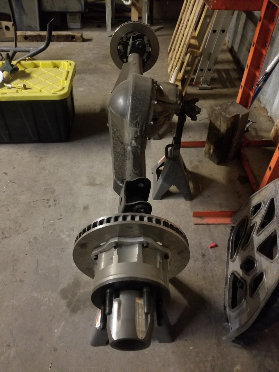

    The concern I have, is he intends to install 4 link and full float spooled 40 spline axle assembly lol. He says to try it, do the learning curve, and I will like it. He is doing swap and maintaining 4 wheel drive 20201027_182240.jpg Screenshot_20201106-101122_Gmail.jpg

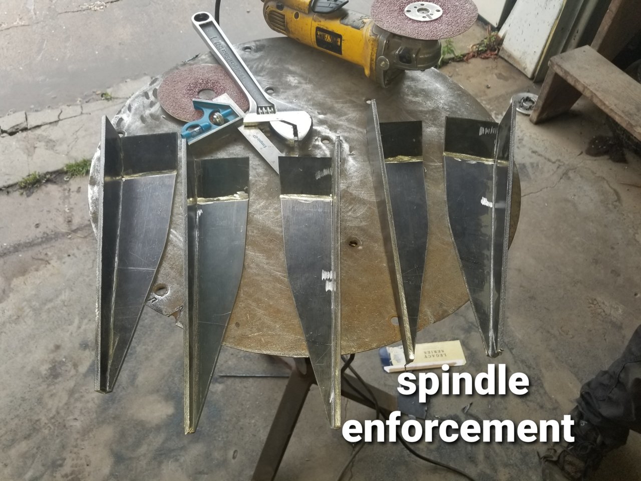

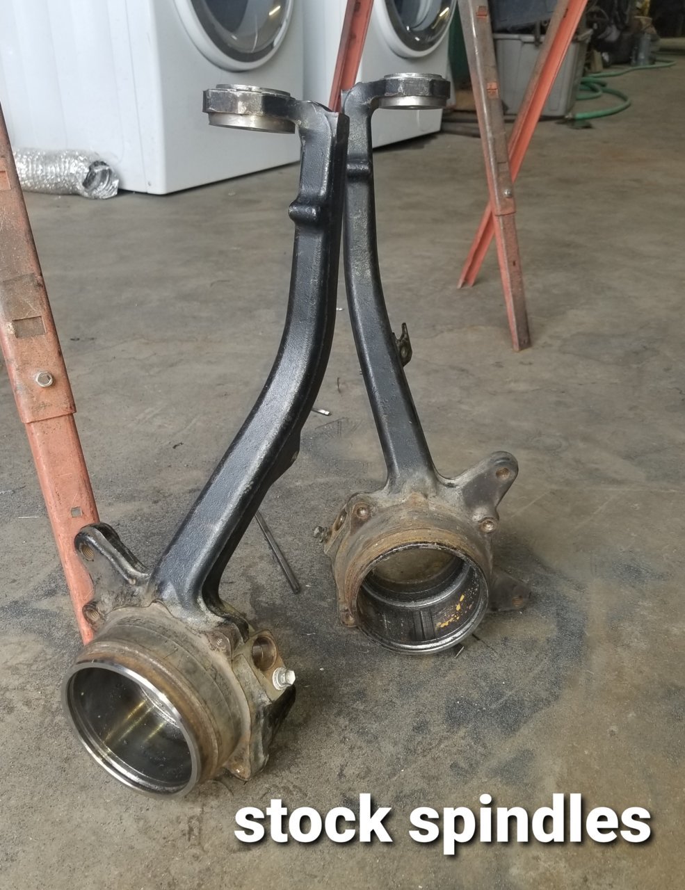

    Spindles enforced20200403_101248.jpg 20200403_101443.jpg 20200403_102258.jpg
