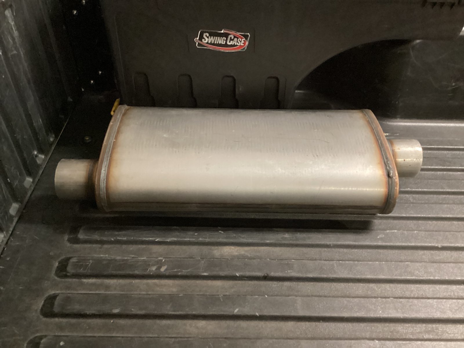

    Well Deep Motor SUCKS! Took my money then waited for over a week to ship! So I called and left a voicemail asking when are you going to ship my parts? No reply so I called VISA and within two days I got a refund! So now I had to purchase another pan. The second pan came with the wrong “Oil Pick-Up Tube” so a Third order.
    God with all the issues I’m having I’m thinking I should have just left the supercharger system on and built the engine for boost!
    Oh, I just purchased this to go behind the front one so I will have two 5x11x22 in a row/series.
    The front is two 2.5” in and a 3” single out this is a 3” in & out.

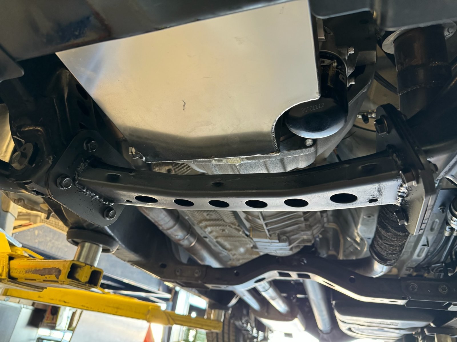

    No they removed the rear cross member and fabricated mounts to put it back in. They didn’t want to pull the motor because of the wiring mess.
    Plus they said when the installer tried to force the over sized oil O-ring in place he may have pushed the Oil pump?
    Or something to that effect. All I know is now the fans are not working. The guy I hired was in over his head. I’m only guessing but with the reputation of the oil tube pickup **** must have thought bigger is better but it did something to the oil pump. The O-ring was deformed and pinched…

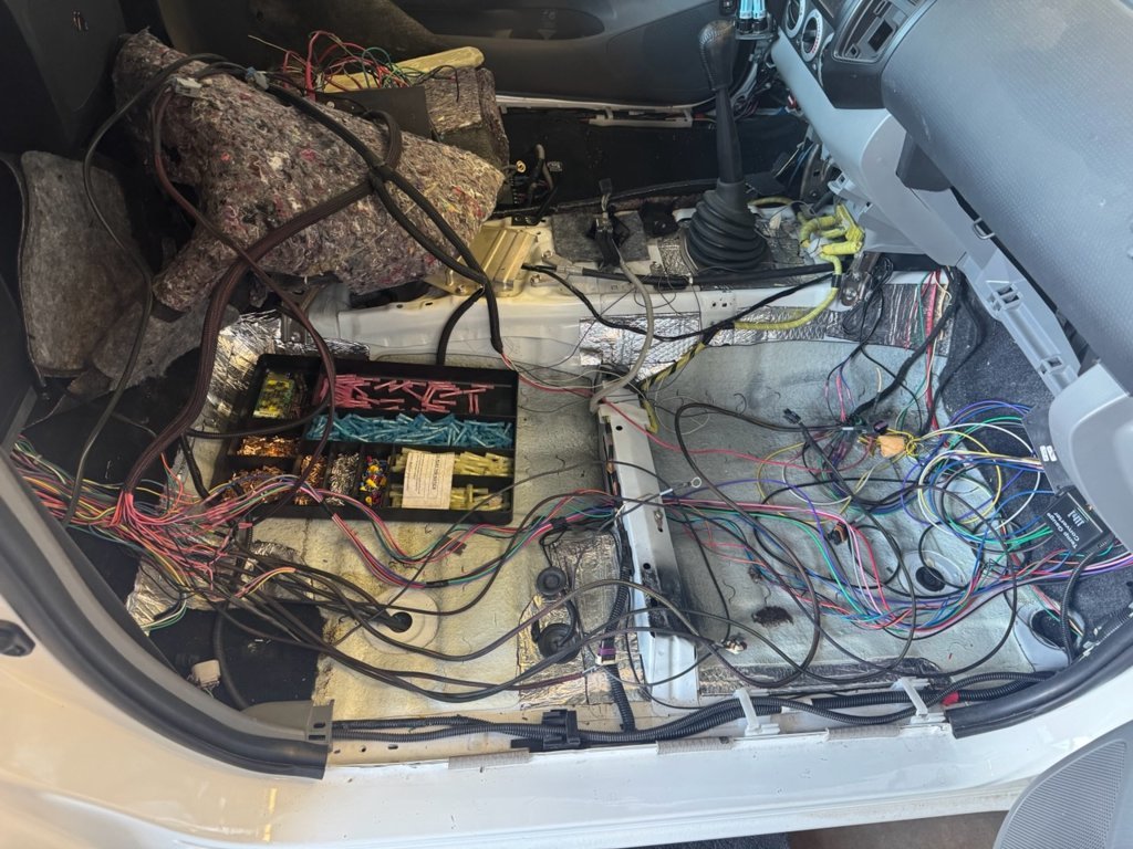

    Well Still a work in progress… :popcorn:
    The mess of wires that was under the hood will now be under the carpet on each side.
