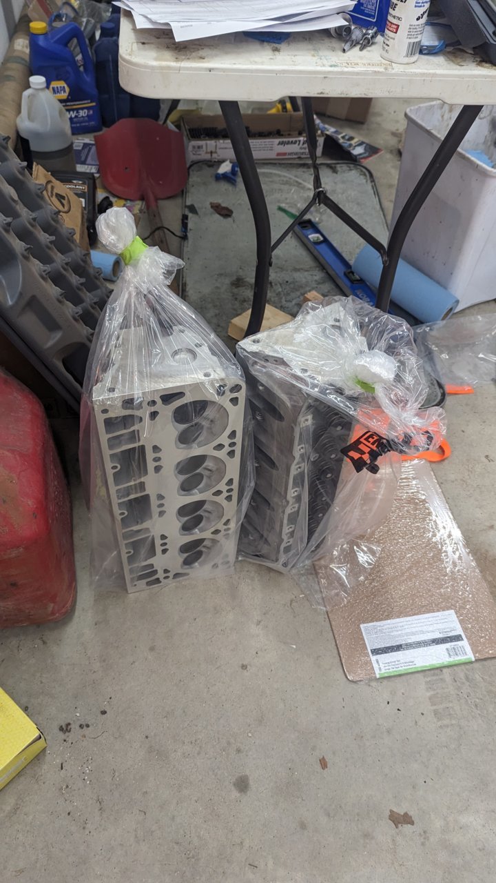

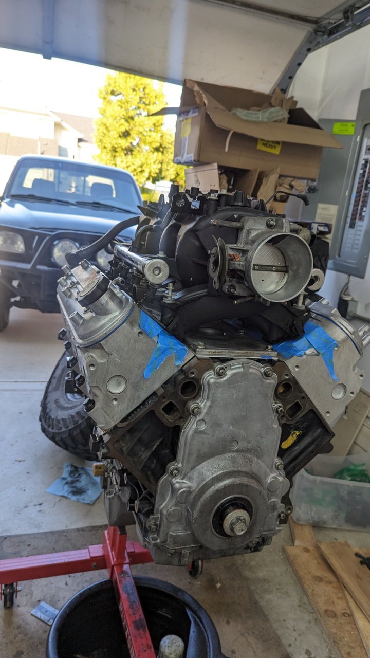

    Ok small update. Got the heads back from the machine shop. Realized the head gaskets aren't sold in pairs and the headbolts I bought were for a SBC... So tomorrow I should get the right stuff in and be able to really get this thing together. Yesterday I got the front cover and seal in and threw on the old oil pan even though it won't work, just to cover up the internals for paint and FOD.
    I will say I am pleased with the work Moffitt and bratton did on the heads. Valve job, mill the face and set spring pressures and were super cool knowing I am a newbie to this. Heads look almost new and the price was reasonable. They even squeezed me in even though they have a several months long back log. Recommend if you are in the treasure valley!

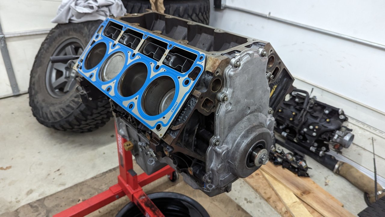

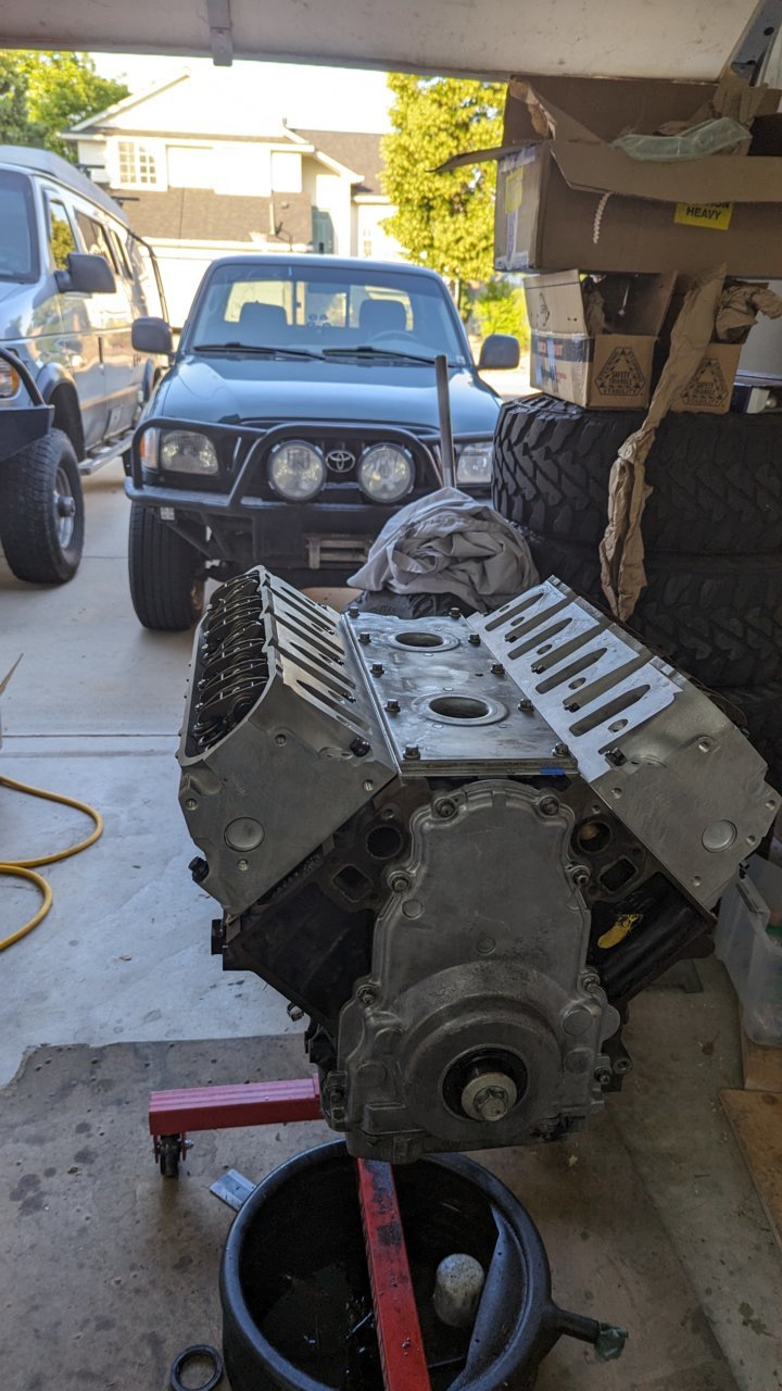

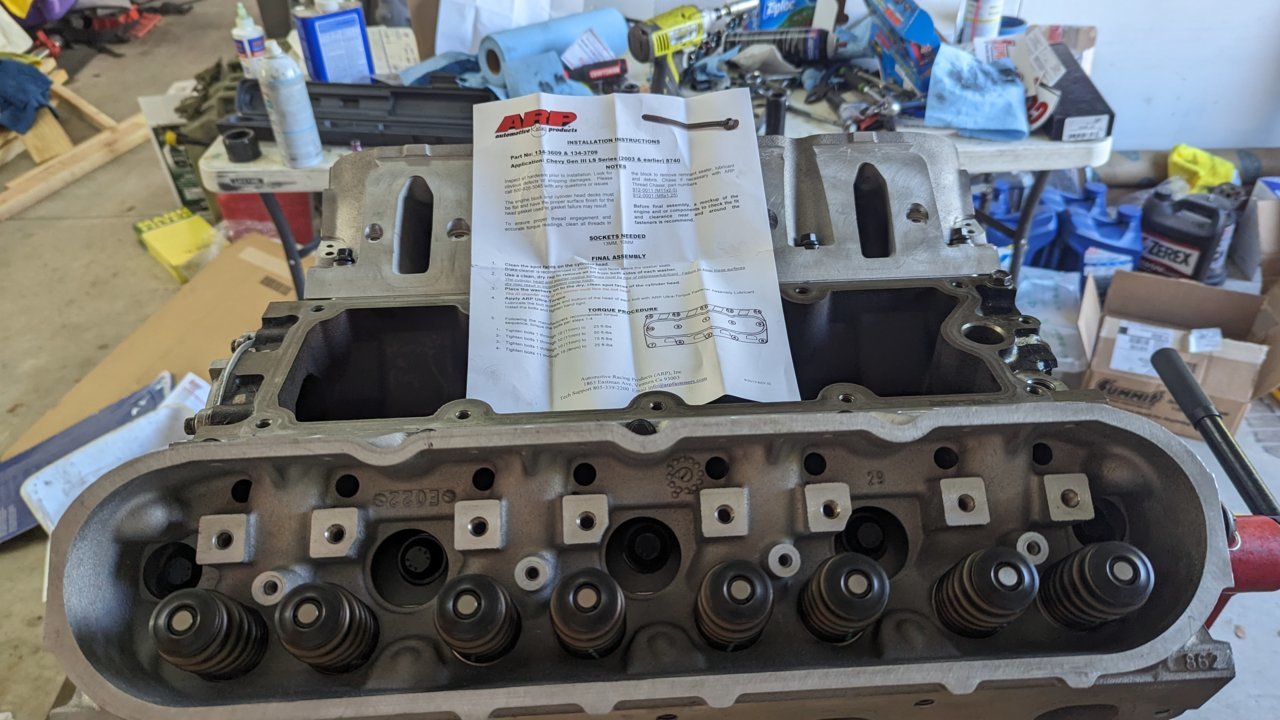

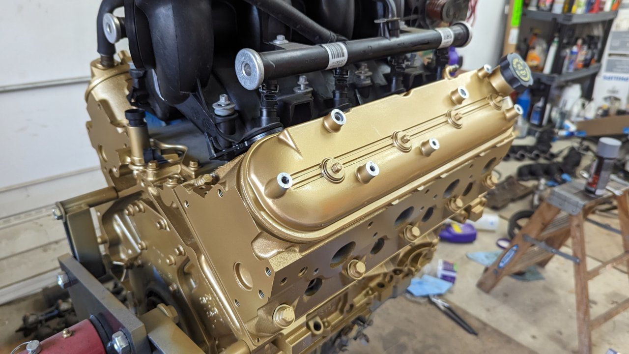

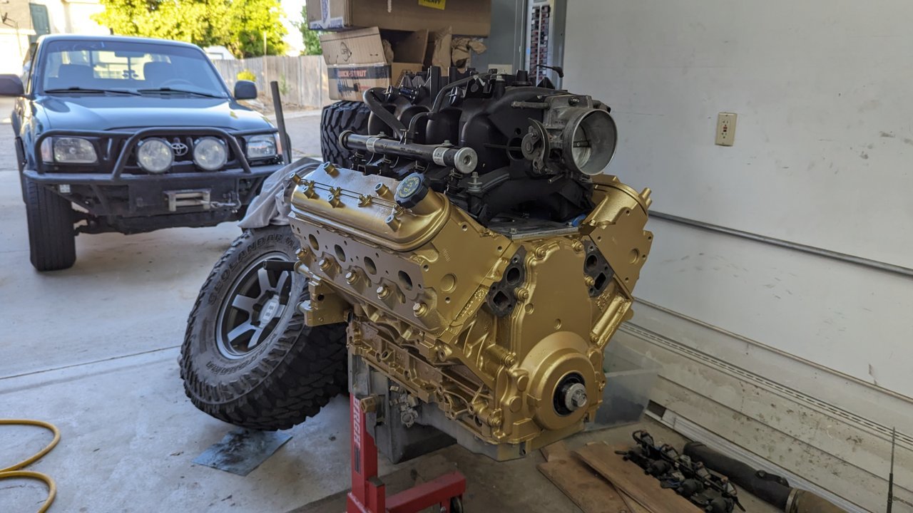

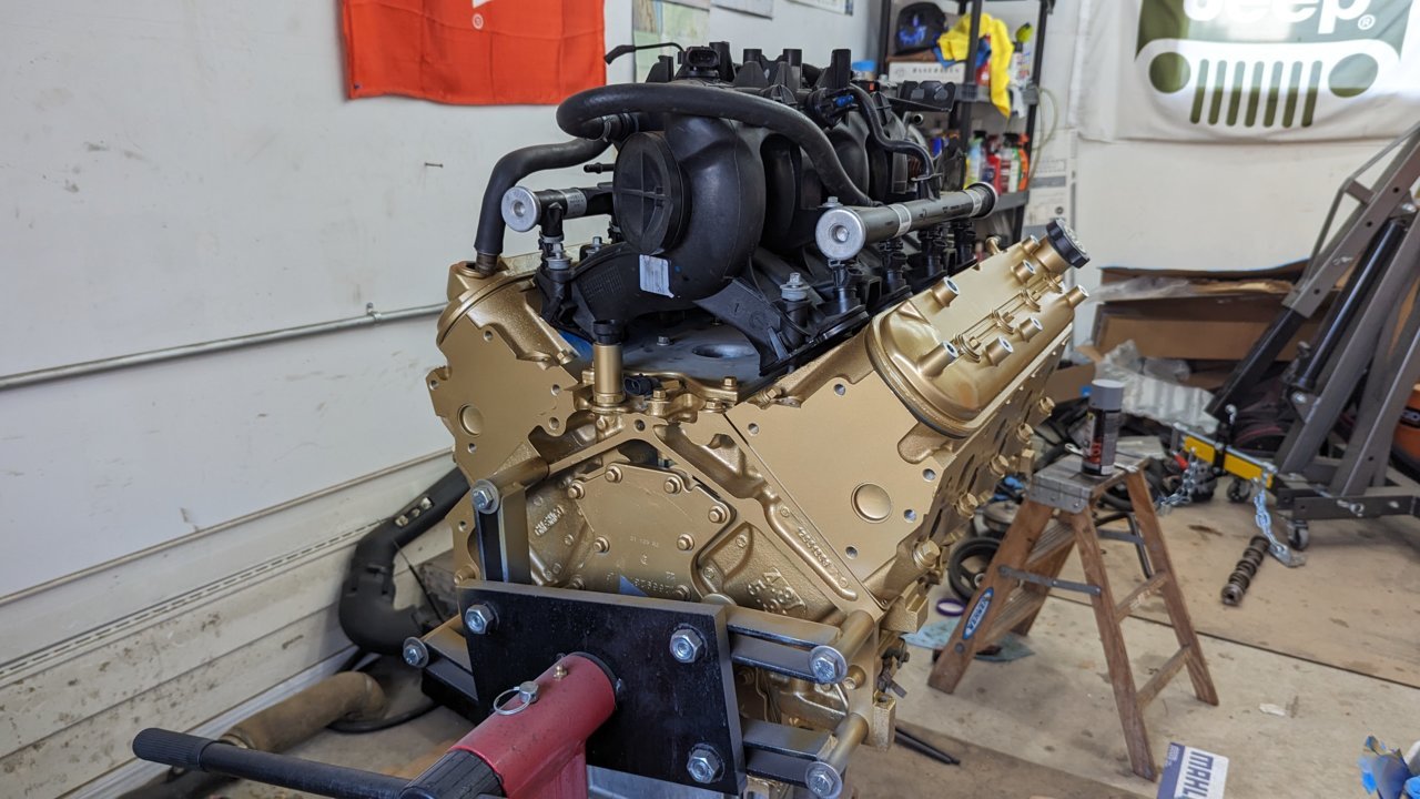

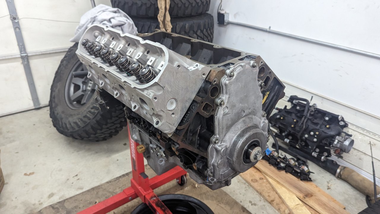

    Went together quick. Heads on with ARP hardware. Valley cover in with new knock sensors. Rockers in and valve covers. Intake isnt bolted on just yet but it looks like an engine again! Next step is prep for paint.

    I will say, I need to work backwards on this. When I went to install the rockers the crank was very reluctant to turn. I used a longer breaker bar and it turned, but something isn't right. Being that the rockers weren't installed, it eliminates the valvetrain as nothing would connect the crank to the cam or lifters. So my guess is either I didn't see that I screwed up the timing chain or that when I lubed the oil pump I did not reassemble it correctly. Better to pull it apart now than when it's in the truck! To be continued....
  9. Jun 22, 2023 at 5:37 PM
    #129
    m3bassman
    m3bassman [OP] Well-Known Member
    Jan 16, 2011
    #49376
    17,138
    Green truck
    And it was the oil pump, had the big gear backwards and didn't pay attention that it had a small beveled edge on it, obviously there is a reason!

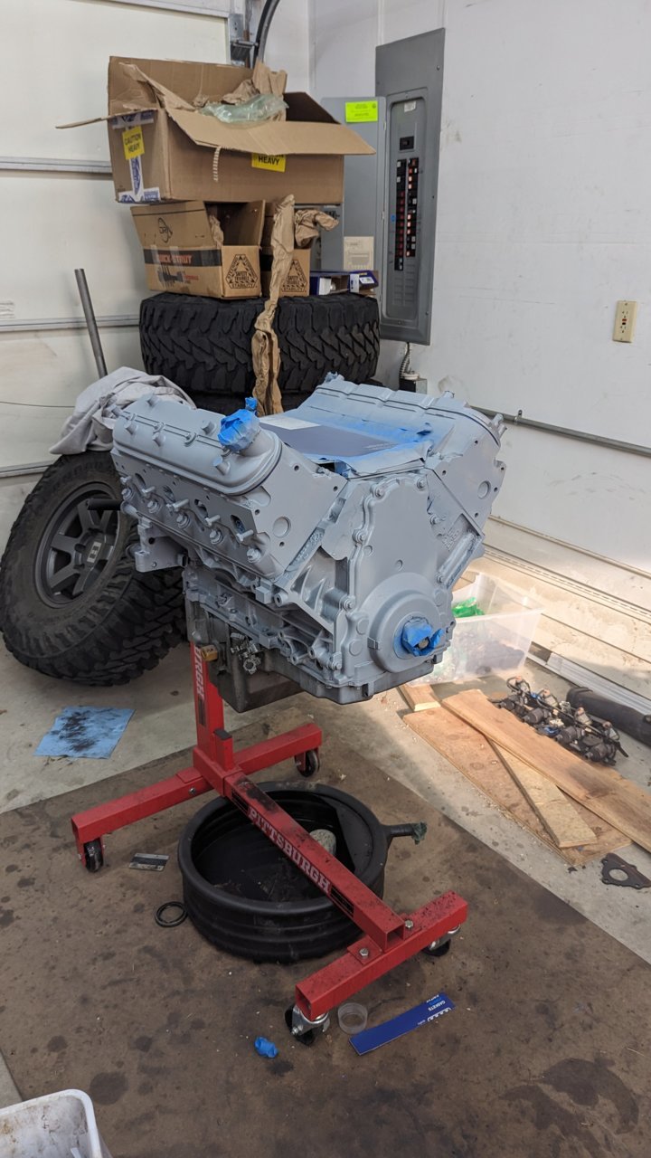

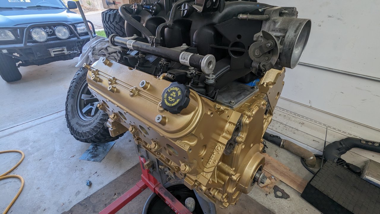

    Figured I would get through the headache that is painting. Did minimal prep, masked the important bits and spread on the primer. Yes it isn't a perfect job, after all it's going in a ratty old Toyota. And realistically I'll be the only one looking at it up close.
    And then paint.
