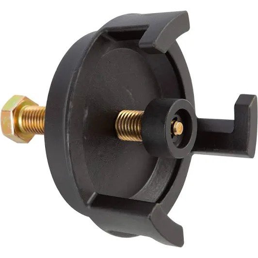

    Cherry picker I had, got free when a friend moved away. Finally validated for having it sitting in the corner of the garage for these years. Engine stand is new. Next up is a damper puller so I can finish the teardown. Hopefully harbor freight has something that will work.

    There's a special puller just for LS truck crank pulleys. I'm pretty sure just about every parts store on the face of the Earth rents it.
    Looks like this

    Good
    To know, I should see if that's an option!
