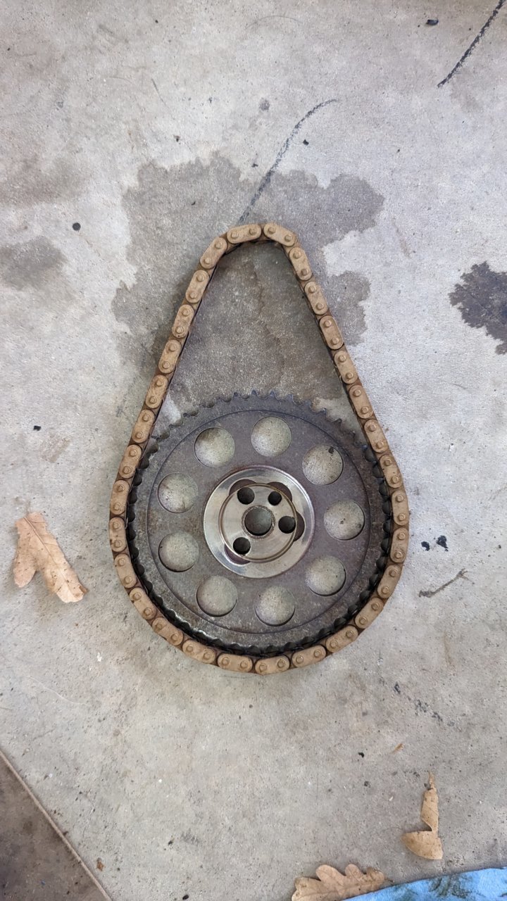

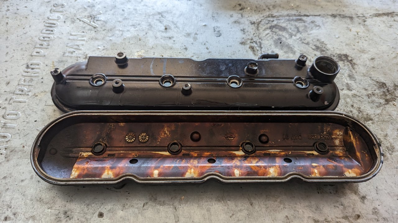

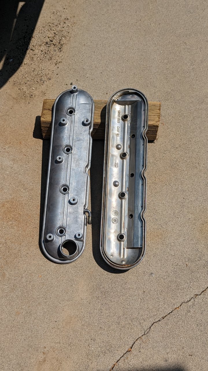

    Hopefully y'all aren't too bored yet. This won't exactly be done in a week.... Still doing the boring stuff, cleaning. I do fine it quite therapeutic however. Today was a lot of work to get the valve covers cleaned up. Lots of paint stripper and lots of scrubbing. The guy I bought the motor from recently painted the valve covers black but did a mediocre job. Not taped well, not prepped at all (paint came off while washing the thing), and big runny paint globs down the sides. He also didn't even clean the insides of the covers so it clearly was a rushed job.
    Here is the before:
    And here is the result, ready for new paint once I make up my mind what I am going to do :spy:
    I don't see a reason to get a new timing chain so I scrubbed the gear and soaked the chain in acetone which turned it into gold!

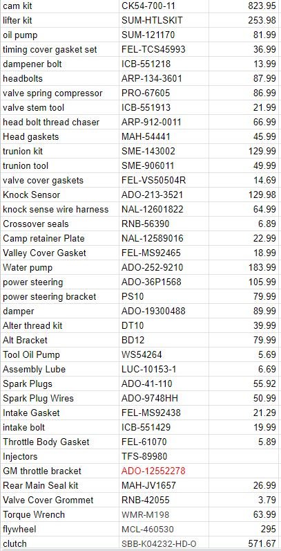

    Still working to finalize the parts list. I think i still need to trim it down a bit or find some parts that are a bit better for the budget. Current total is $3667.20 and doesnt include the exhaust work or machine shop work that needs done. This list will certainly be a Work in Progress.
