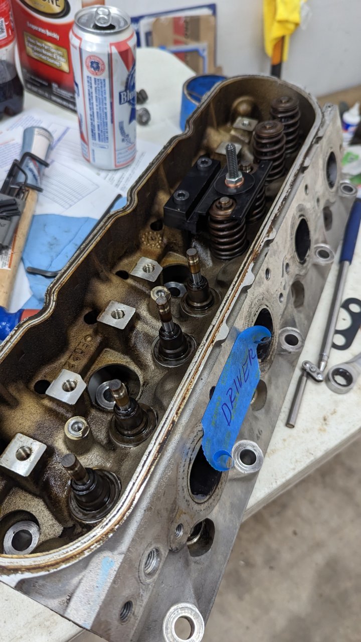

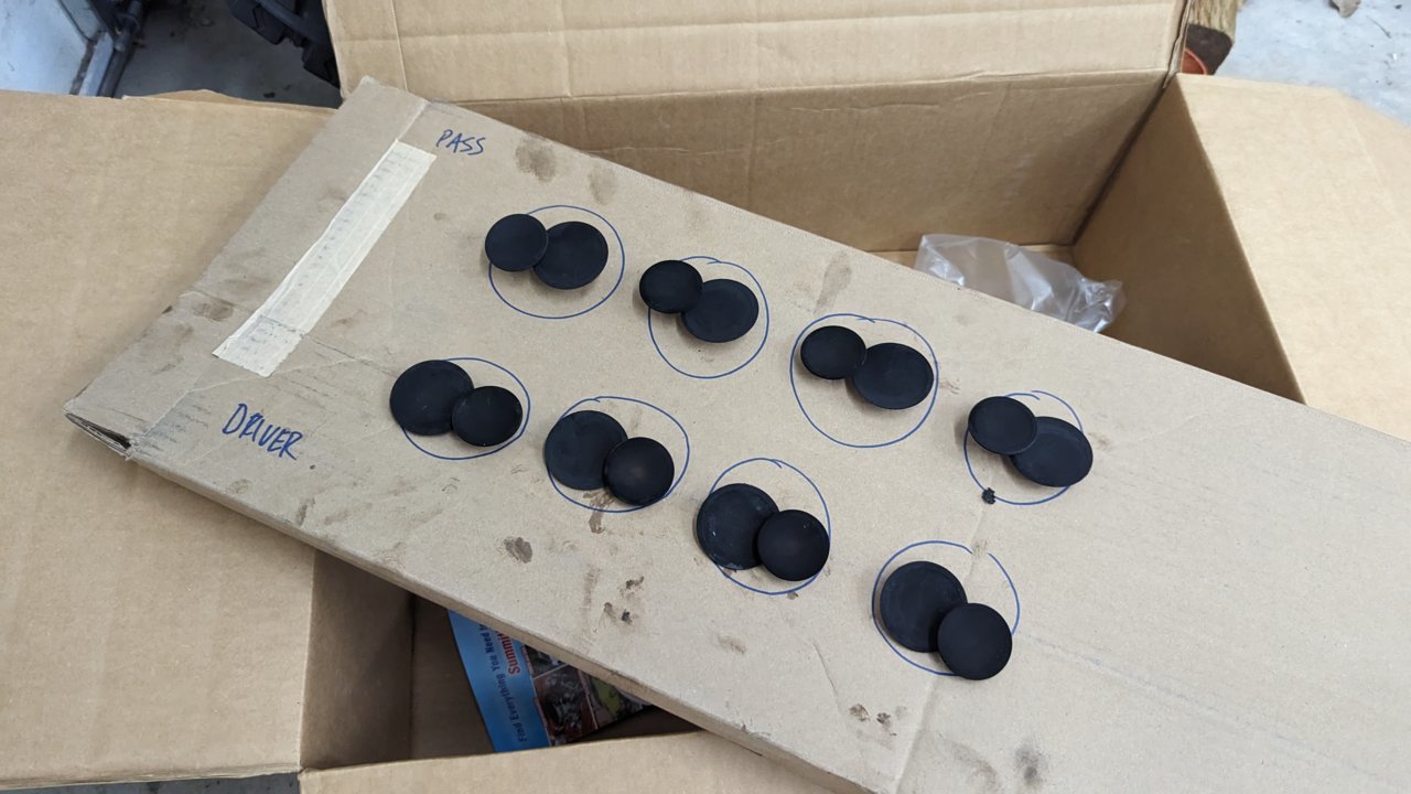

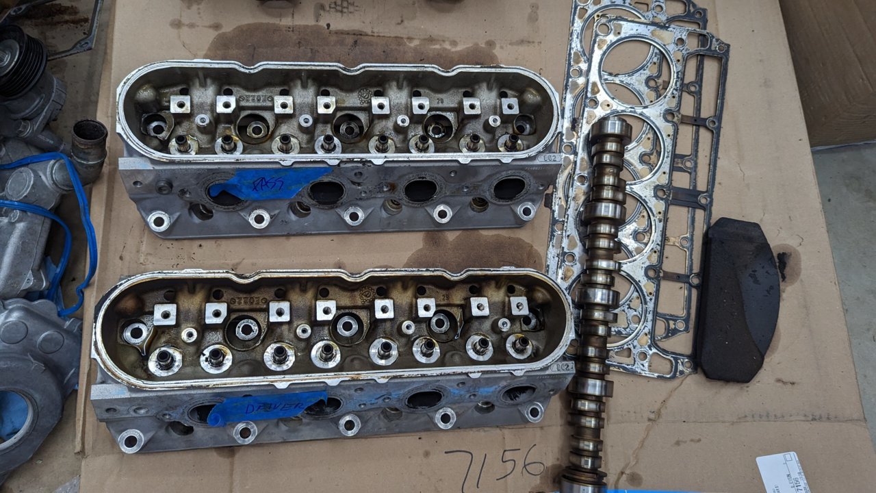

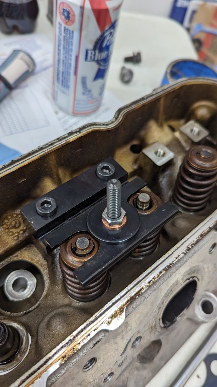

    While the book I'm following says to just let the machine shop deal with the valve springs, that doesn't give me the opportunity to learn how they work. As someone who has always loved cars and trucks, it is important to me to use this as a learning opportunity, to better understand how this thing works. It will make diagnostics in the future that much easier. So, I bought the right tool and spent the 30 minutes to pull the springs and organize the valves myself.
    The tool was from summit (spoiler, 95% of the tools and parts for this build are going to be from summit), and it's by pro-form (pnPRO-67605). Worked flawlessly but was a bit of a shame it didn't come with a case to keep it all together for the next project. It's shipping box will do I suppose.
    Tool in action:
    All parts removed.
    And valves organized for the machine shop tomorrow.

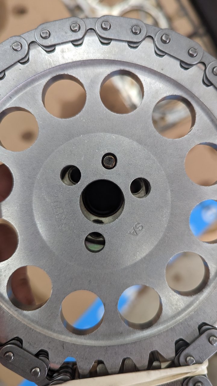

    Well I bought the wrong timing set. Oops.

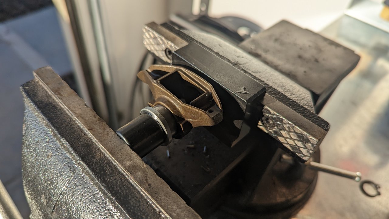

    Installed the Summit Racing Trunnion upgrade kit today. Pretty easy and the tool they sell makes it a breeze. Had to borrow a bench vise but all in all pretty smooth install. So rockers are done! Cam is pushed back further into July sadly, but I'm hoping to get the heads back next week so I can get the new springs installed and the heads will be able to be wrapped up.
    I do need to make some calls to some shops as the Advanced Adapters bellhousing says it isn't for LS applications. I also noticed the CX racing engine mounts note they are not for front sump setups, but that's what I am pretty sure I will need. Lots of details to sort out but all I'm looking forward to working my way through it.

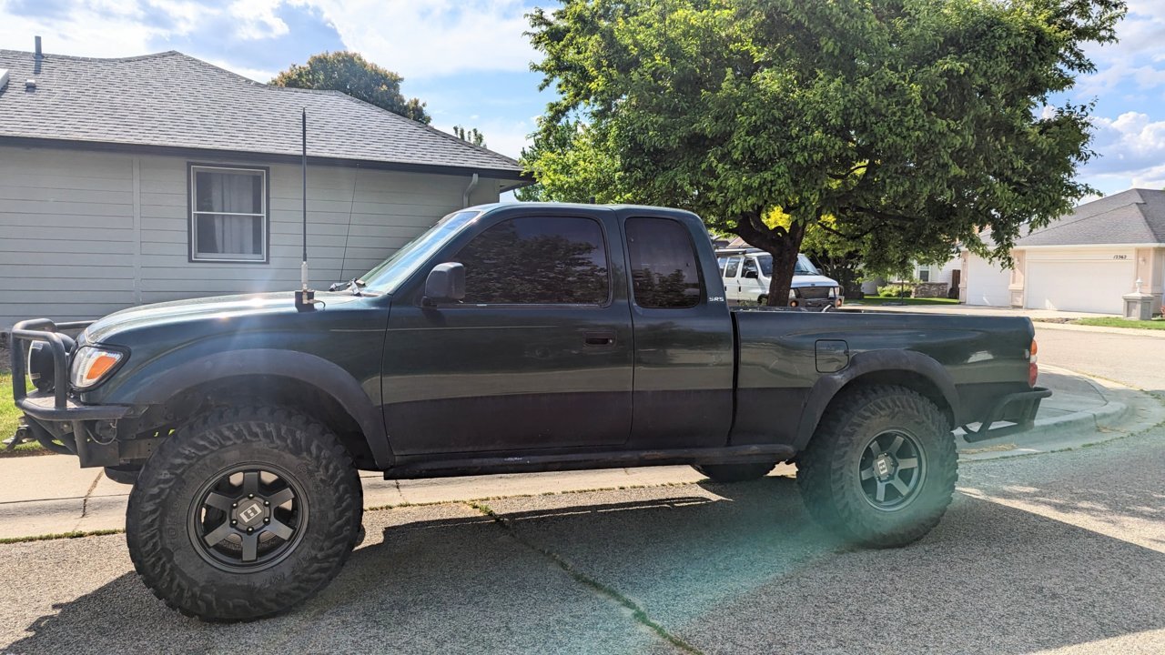

    Got the truck lowered. The rear needs to come down further and probably some softer shocks would help. Looks more appropriate for speed now.
