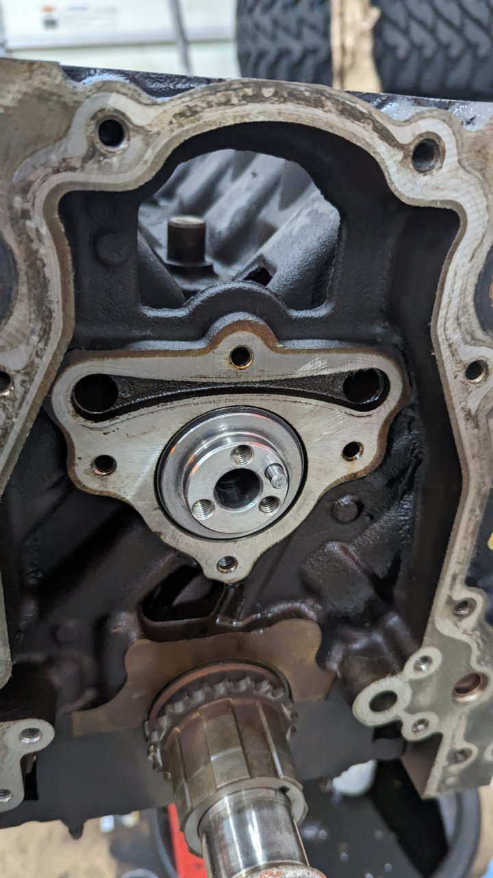

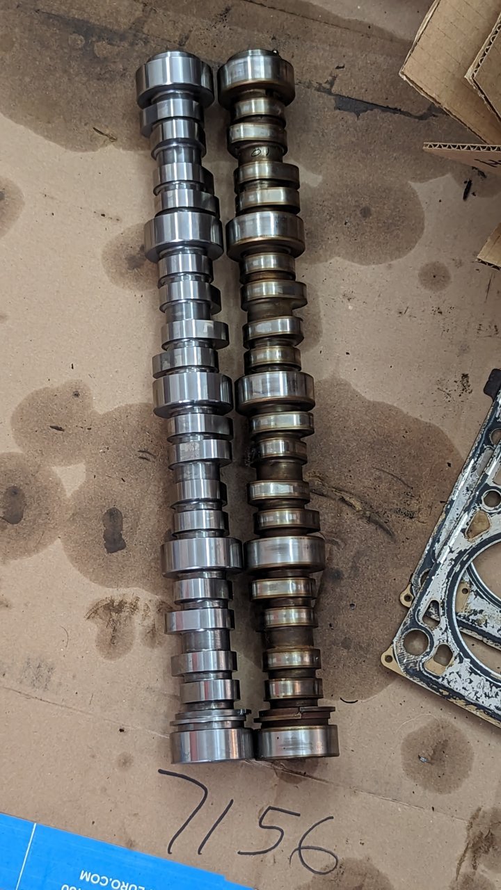

    So I found out something interesting about summit racing. If you buy one of their "kits" that "they" put together, most likely are put together by the manufacturer. Meanwhile Summit orders the parts individually and has them on the shelf and doesn't lot the parts themselves. So, while they have a kit available it has a long lead time, but if you scroll down to their Replacement Parts section you will find all the parts of the kit, and usually they have it on the shelf ready to ship today. So I went this route and canceled my order for the kit as it cut the lead time by months! Wish I figured this out sooner but hey, learning ain't easy. Tonight the cam went in, see below for the timing card. I don't have the right bolts for the new plate that is tapered (cue the credit card) but that's ok, I can get the lifters and trays in and swap to the correct bolts early next week before I throw the oil pump and timing parts on.

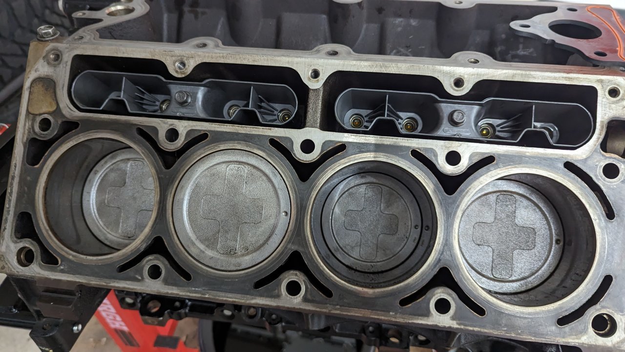

    Threw in some new lifters. Pretty straightforward, pop them into new trays, oil them up, glob on some assembly lube and drop them into the block and torque to spec. Next step will be rearranging the garage to get the hoist back out and getting the engine off the stand so I can access the bits on the rear of the block. That's a job for tomorrow.

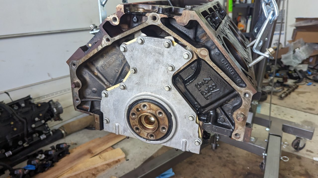

    New rear cover gasket and rear main seal in. Hidden is the new billet oil barbell behind it. Splashed some rtv on the bottom edge of the block and torqued to 18ft/lbs. Feels like hurry up and wait with each new part but that's just the nature of a first time build I suppose. Should slap together pretty quick in the next week or so after the paint dries.
