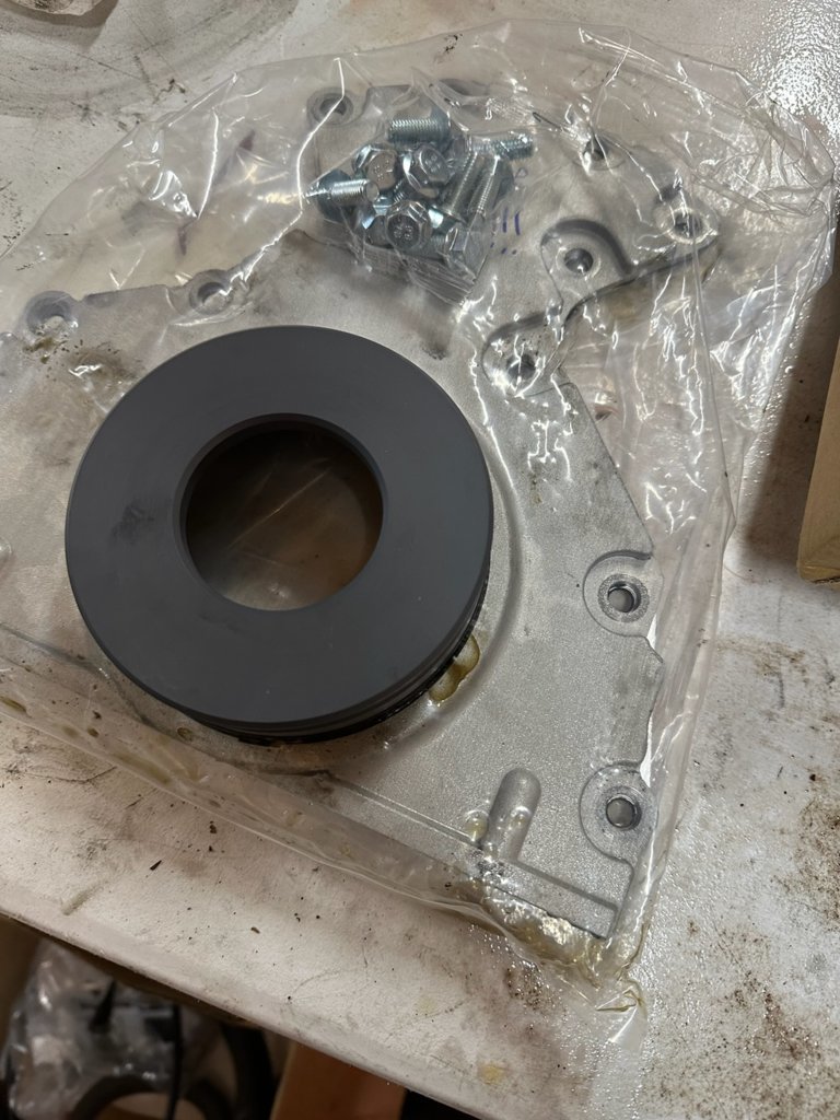

    Did you replace the rear main prior to install? If so, do you simply replace the seal, or the whole plate?
    If you replaced the plate(cover), then you need an alignment tool to re-center it, or it will always leak. I dealt with this as well on a build last year.

    My friend wanted to do the whole plate. I didn't realize at the time that you needed a tool to center the seal/plate combo if it were removed. I had to drop the trans to correct the issue.

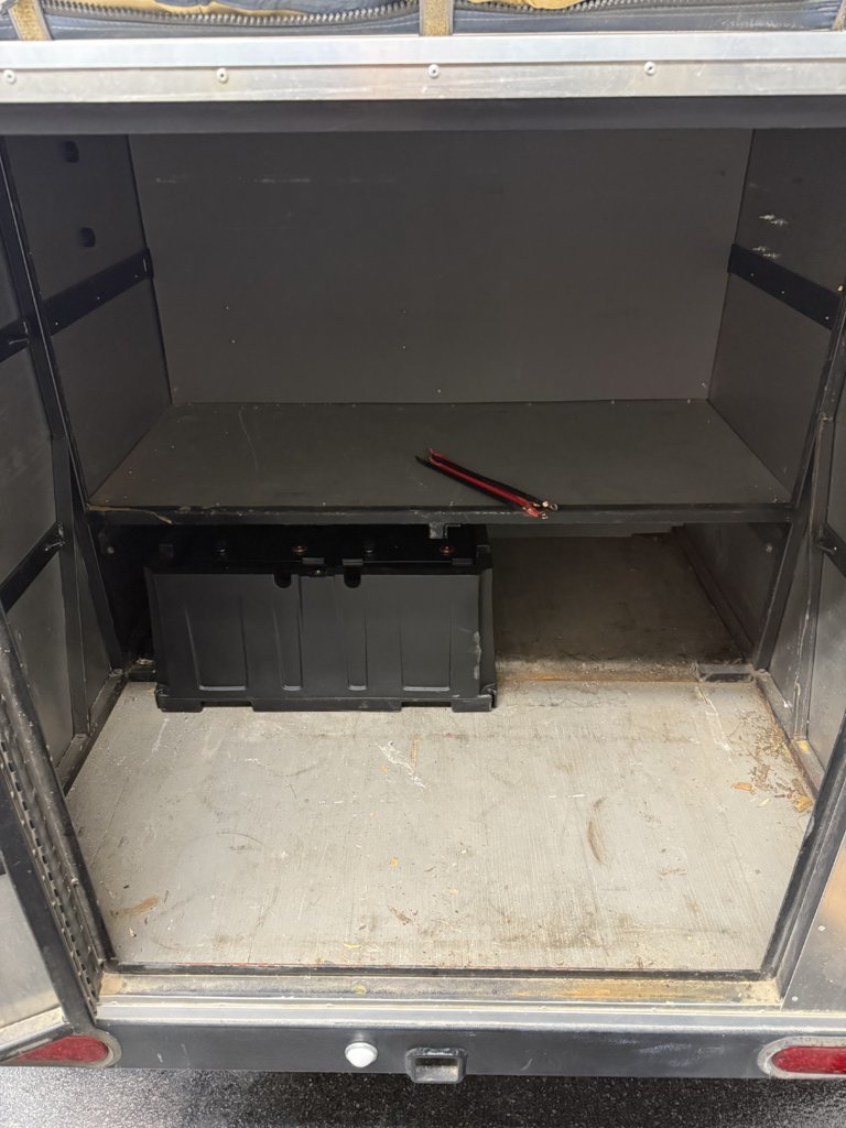

    Finally got some work done on this thing. 960ah of lithium installed in the trailer in a nice battery box. This trailer is built super stout. Had to remove one of the supports for the shelf, so now instead of being able to support 1200lbs it can probably only support 1000lbs now. :rofl:
    I picked up a bunch of 0/4 copper wire for my battery links, and for the connection to the bus bar and battery charger.
    The water system needs a little bit of a rework. It has an overflow valve, but it’s either plugged or doesn’t work, and will just dump water on the inside of the trailer. The hot water heater is all plumbed up, but my gripe with it is it takes a bunch of d cell batteries. I dont wanna screw with that, so I bought a 12v to 3v step down converter, and will toggle it on and off with the switch pros. Everything will be wired to that so I can control it from my phone in the tent, or the control panel on the ground.
