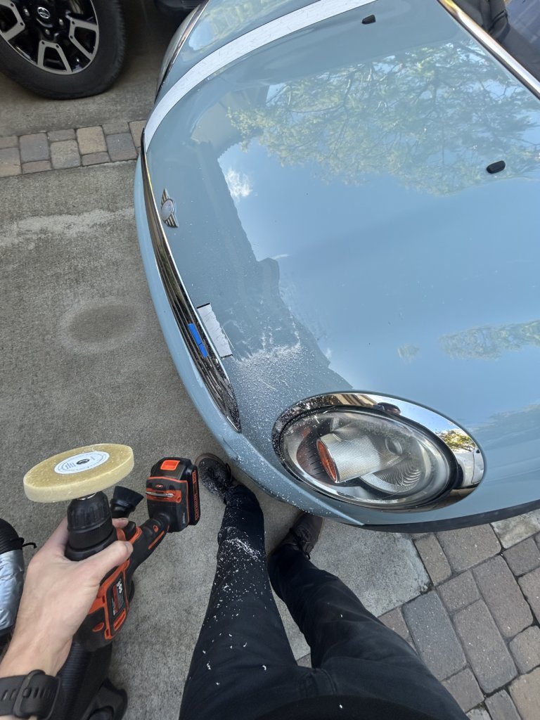

    woah woah woah… 60 grit is way too rough
    a lot of companies make stripping discs just for this purpose, google pin stripe removal disc

    “Decal Stripe removal disc” Bingo!!
    It takes time but these pads / disc do work!!

    I’ve used the decal stripper wheel from 3m, thing works great.
    They are kinda spendy and create a mess.
    But friggin works.

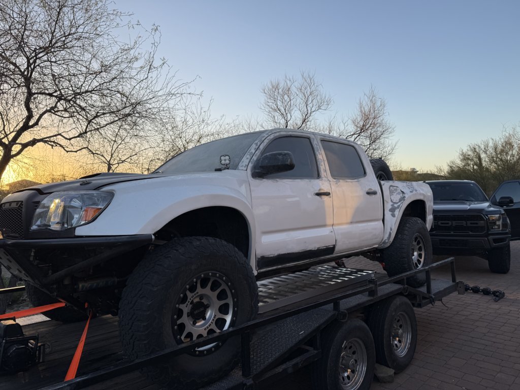

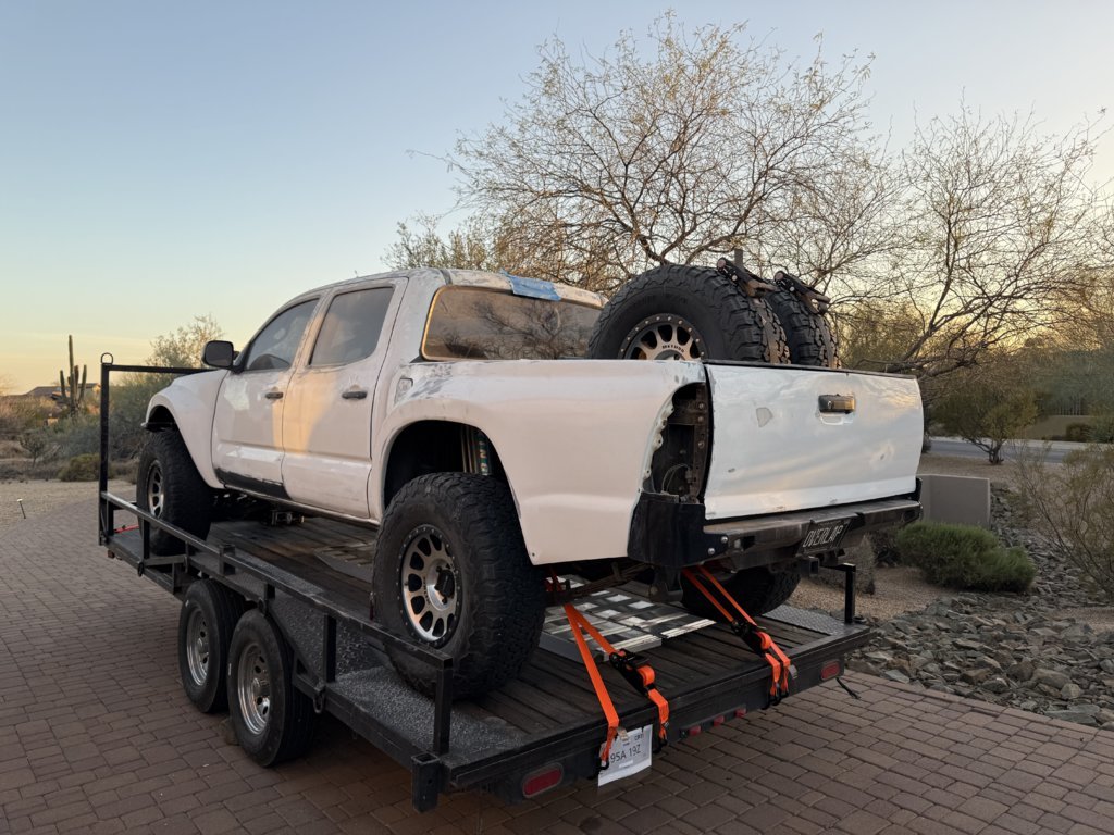

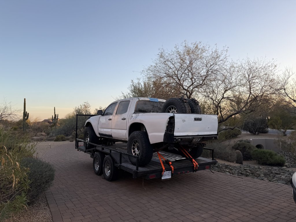

    5 hours with an orbital and 60grit later. No more vinyl left on the truck.
    Dropping the truck off Thursday at the paint shop. He’s going to do some light body work, primer and block the truck, then paint it in a shade of coyote brown.
    only thing I gotta do before I drop it off is remove the door handles, tailgate handles, and side mirrors. Everything else is solid and good to go.

    you can get a non-name brand one too. My body shop friend told me they are called Eraser wheels
    I would have also tried a paint stripper disc. Supposed to take paint off, but not grind like flap discs or grinder wheels. Also better than a wire wheel.
    Different colors are different abrasions. Looks like this:
    Also if you guys havent heard/used before, check out Benchmark Abrasives. Usually cheaper than the normal Amazon junk, but made in the USA (they also sell on amazon, but their site is good too). Its one of those cool companies that gives you a sticker or candy in your order.
