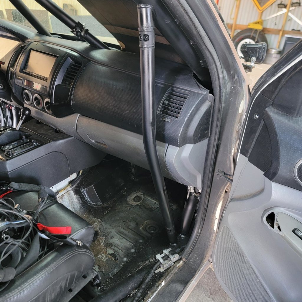

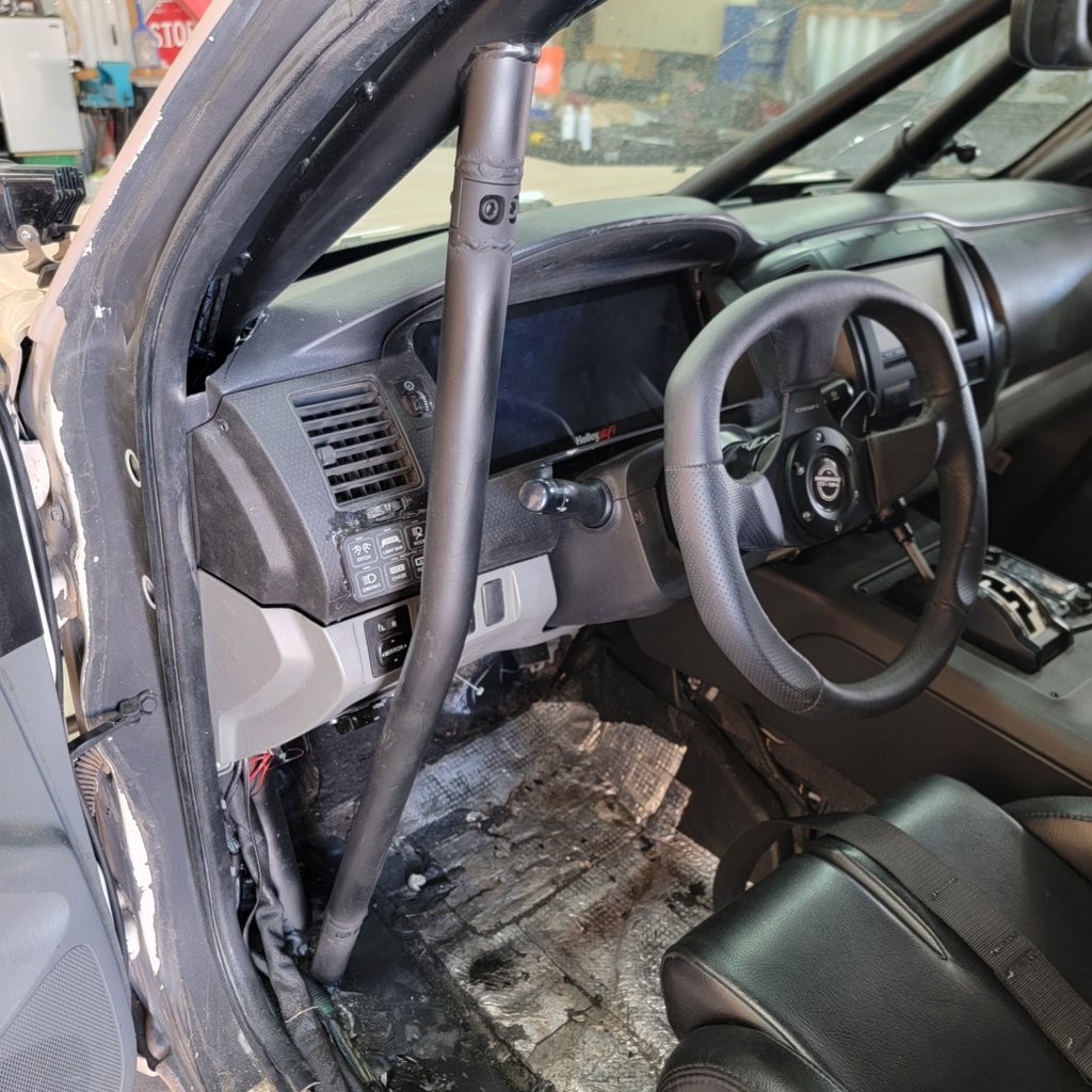

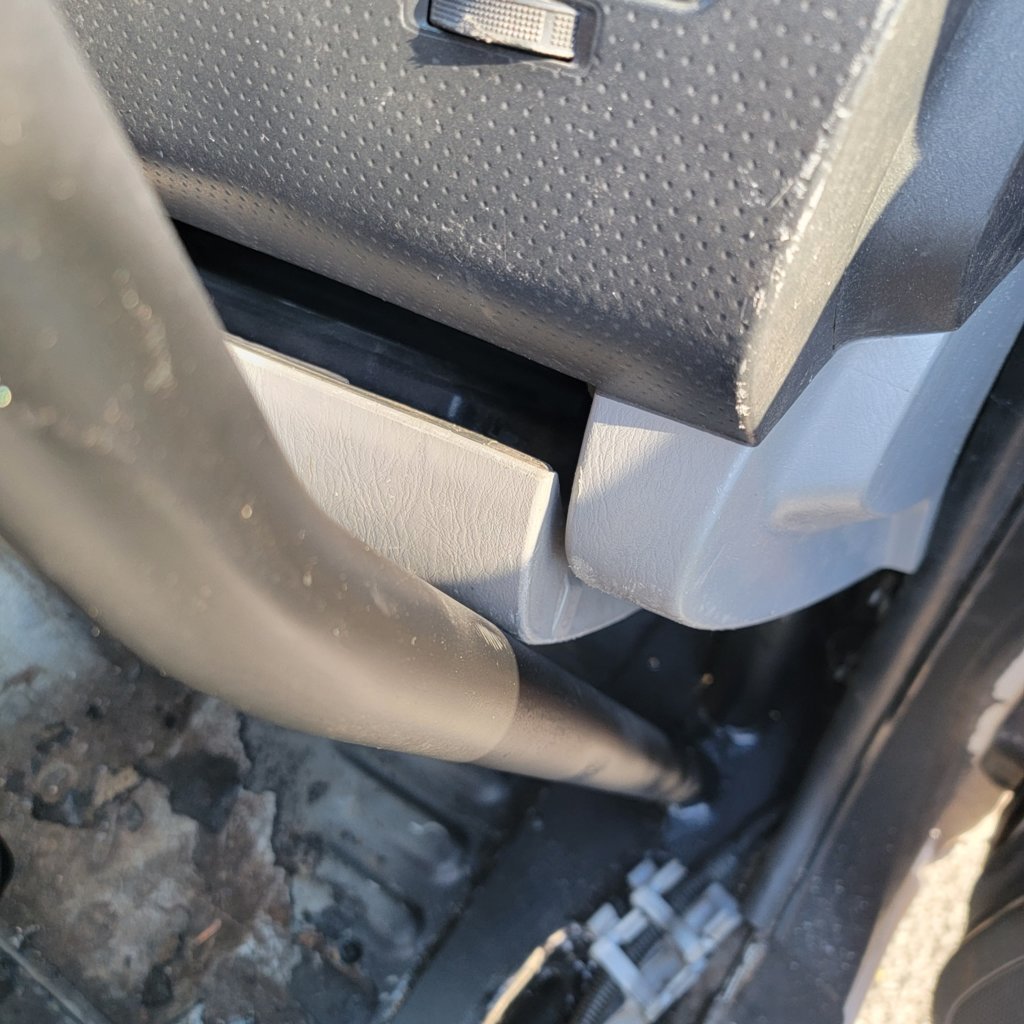

    Resized_20250509_164743.jpg Resized_20250509_164721.jpg Resized_20250509_164719.jpg Resized_20250509_165150.jpg
    Lmao if you wanna use your glovebox, you gotta take this bar out

    Redo that side. Lower point on a heim pivot point, upper on a grade 8 quick pin. Easy peasy

    Next time I have to open my glovebox I’ll just grind away where the door is interfering :anonymous:
    but that is a very smart idea.

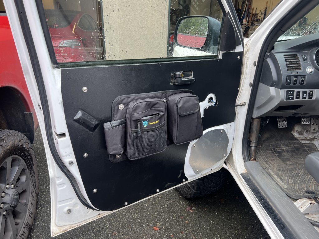

    I keep mine in my door bag! But I also don’t have a glove box if my gps is installed.

    Damn I like those door cards. Wanna make me a set how do you deal with the window controls and door locks etc

    I put them in my center console, sadly I’ve only made one so far….lol one of these days I’ll get around to making at least a passenger side…

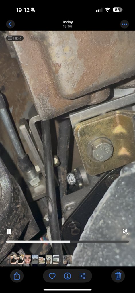

    Tcase shifter bolts were never tightened when the trans and tcase were reinstalled. Truck is currently stuck in 4WD. Gotta go buy new hardware and figure out where it needs to be tightened down at…. God so frustrating.
    might as well have done it myself.
    edit: I should probably iterate that this was because of the dude who made my center console. Homie messed with the push pull cable length when he installed it.

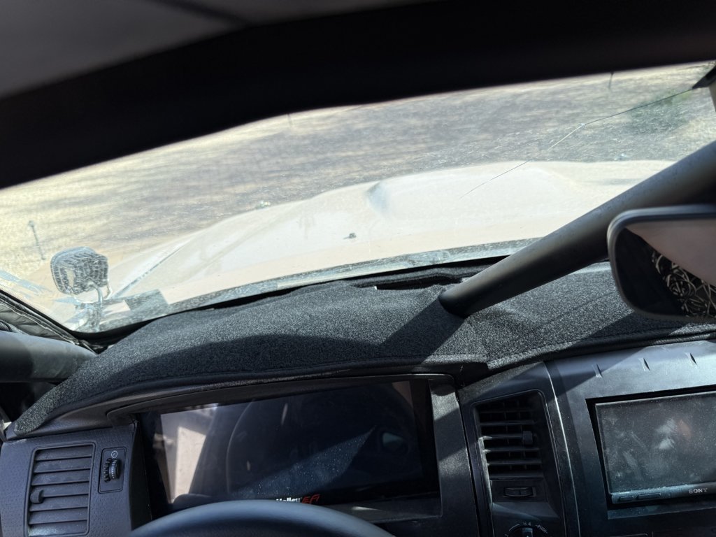

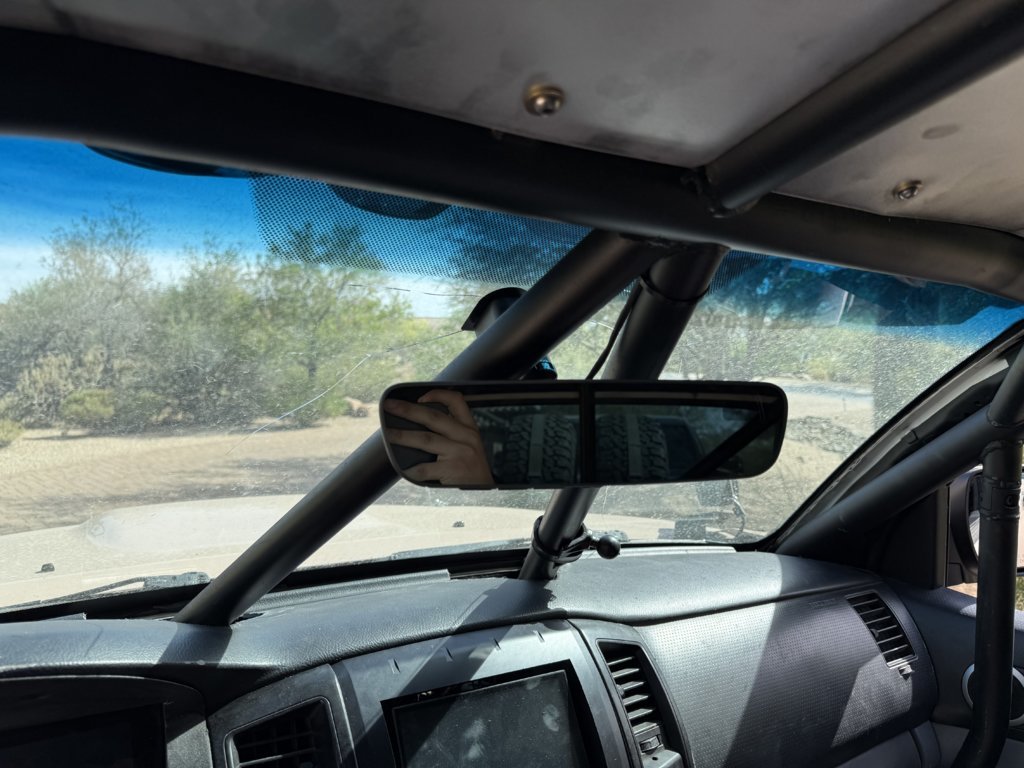

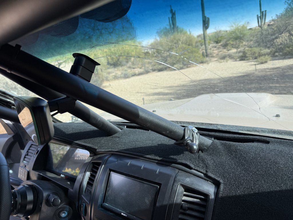

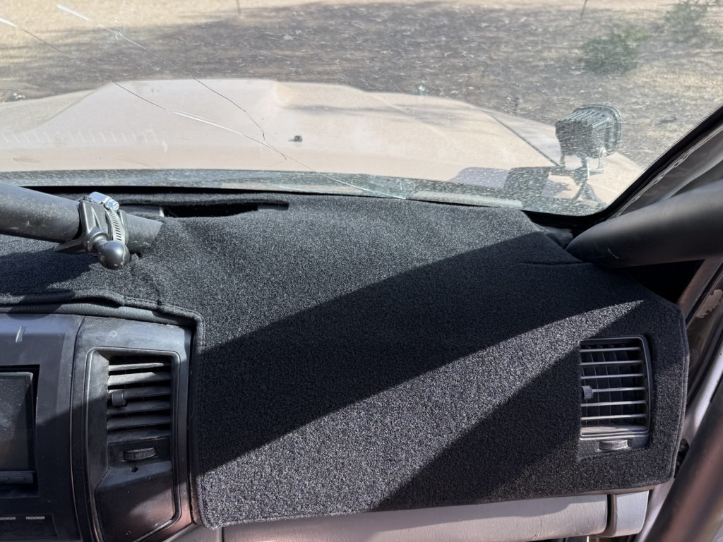

    Mirror is on
    dash mat to cover the holes
    Tires were all at like 16 psi. Got them topped off.
    I got the tcase shifter reinstalled. Man that was frustrating lol.
