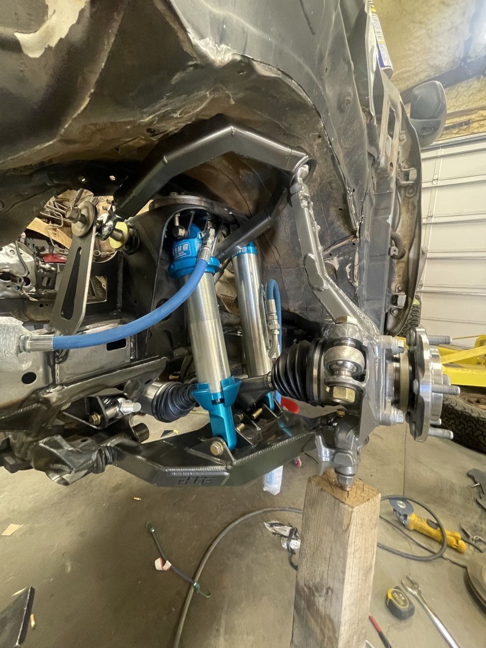

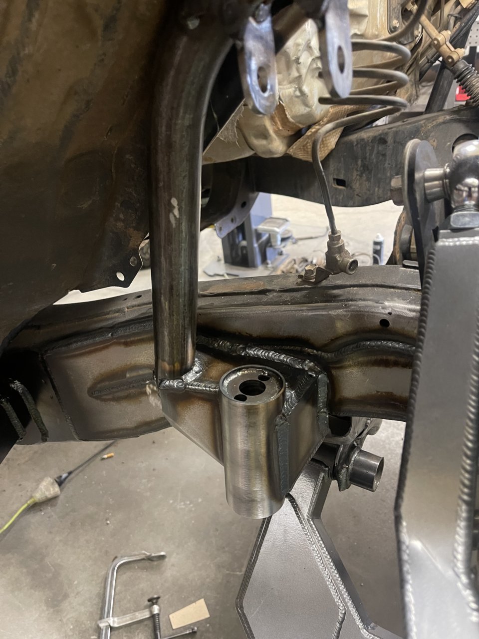

    Trevor at 454 is killing it. Bump cans are in.

    Axles are in. Tiny bit of binding at full droop but 454’s going to strap it just before it binds.
    waiting on the custom length tie rods from JD.
    Something got mixed up with shipping but they’re making it right and whipped up a new set and shipped them out. Plus respect. 454 also ordered a set of their inner fenders to install.
