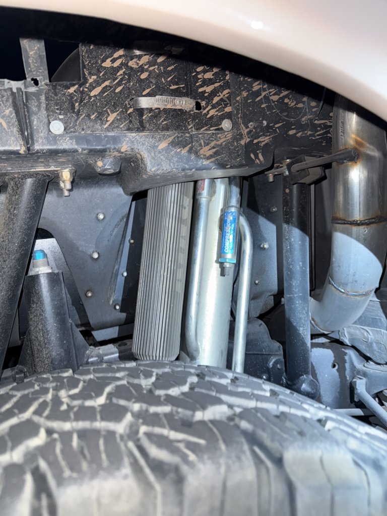

    Good news! Oil leak is fixed! The -10ORB to -10AN fitting in the filter block was loose. Took it out, put a new one in with a fresh oring and torqued to 35lb-ft and no more leaks!
    used 4 cans of brake clean on the front end of the truck to clean oil and dirt off of it from the leak. Messed up the paint on the fabbed stuff so I hit it with some steel it and we’re good as new.
    truck gets an alignment Saturday and then we’re just waiting on ECGS!
