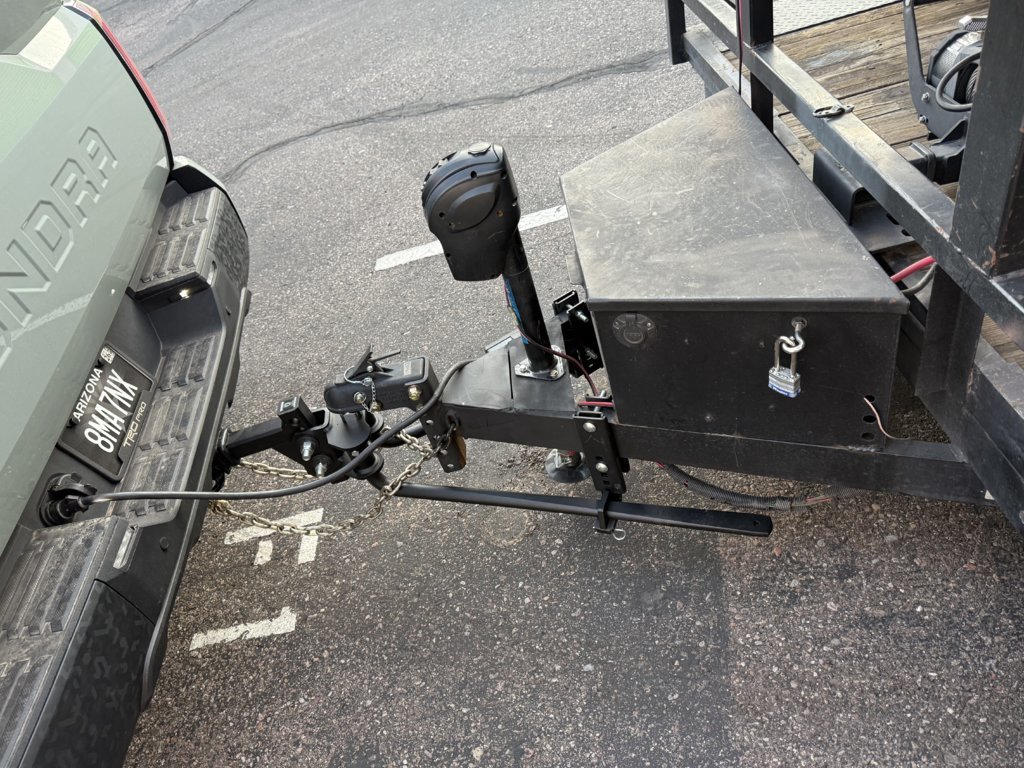

    Weight distribution hitch is on! Tows wayyyyy better now. Almost no squat and feels like it’s on rails

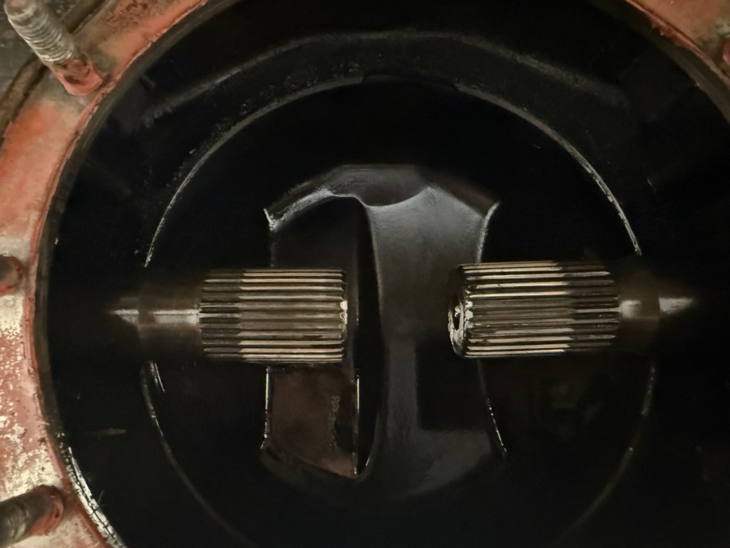

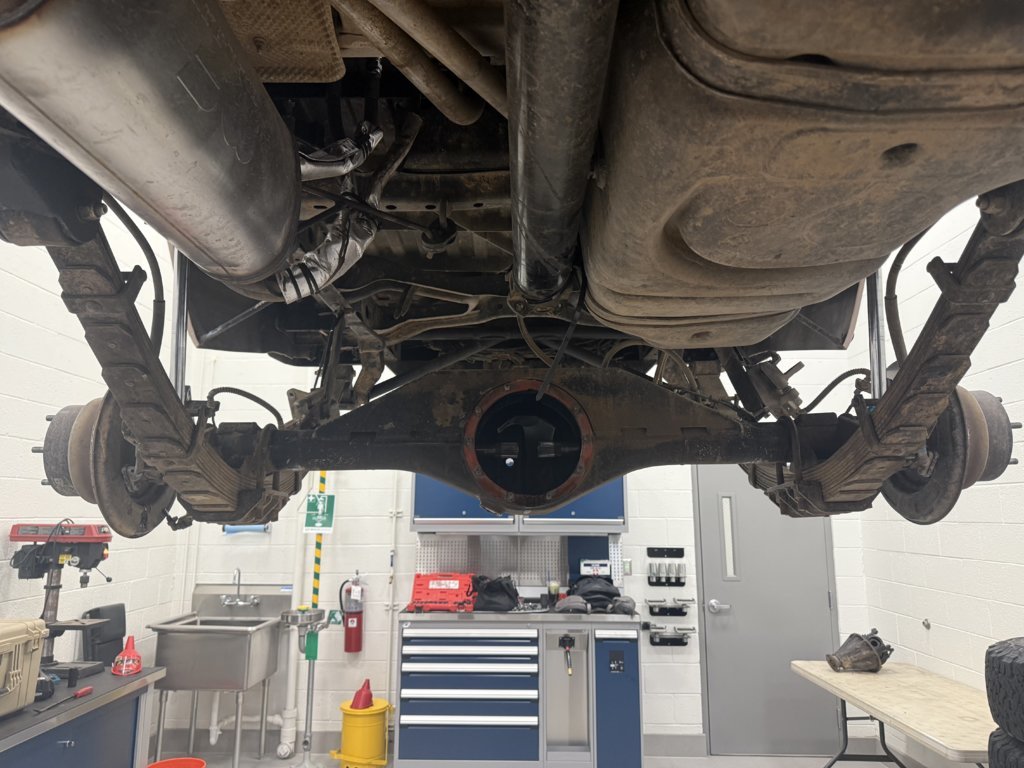

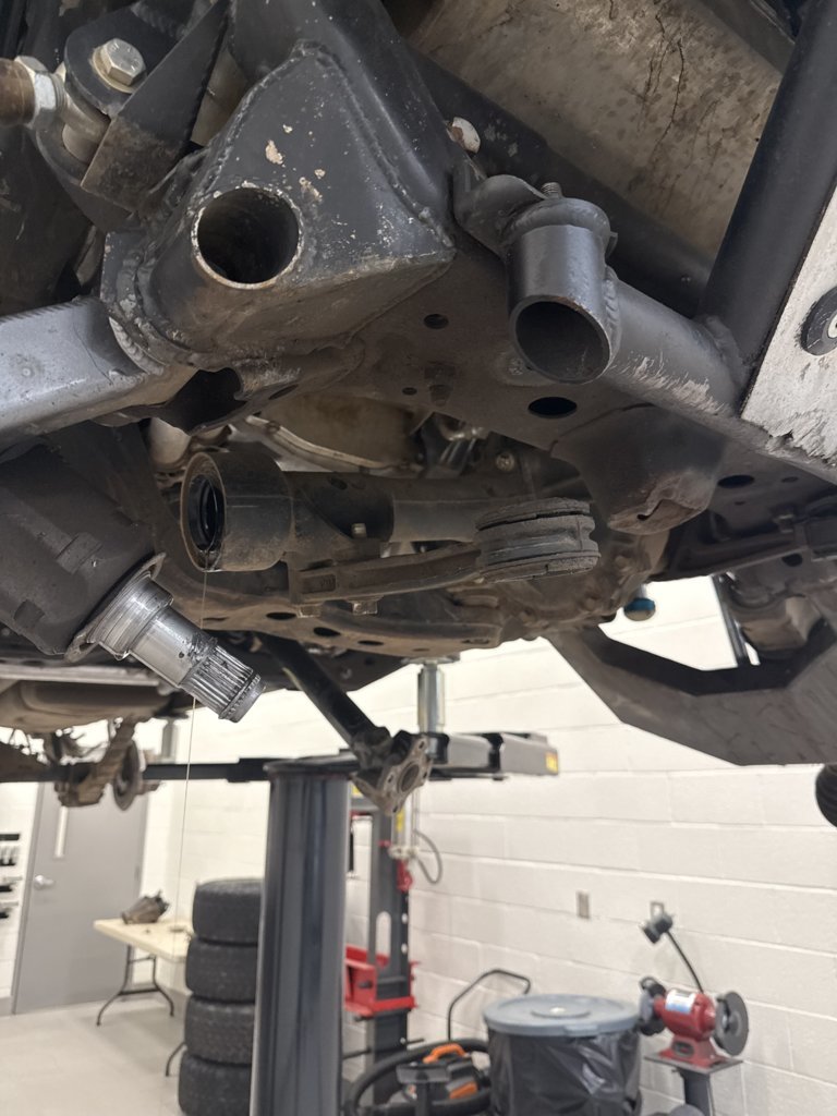

    IMG_5563.jpg IMG_5564.jpg IMG_5560.jpg IMG_5562.jpg IMG_5566.jpg IMG_5569.jpg

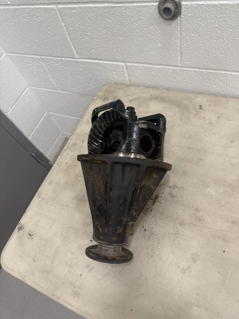

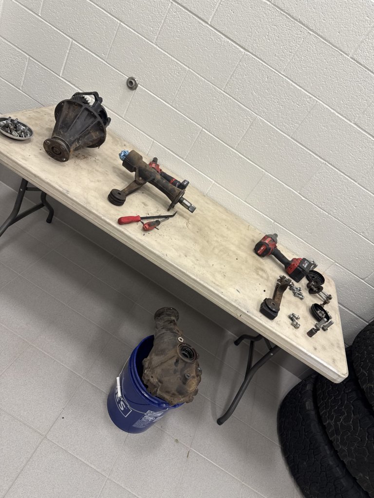

    Got both 3rd members pulled in about 3 hours. Ring and pinions look great actually, but there was quite a bit of metal in the rear drain plug. I couldn’t get the front drain plug off so I just let it drain on its own after pulling the CV’s out.
    I got everything cleaned and prepped for fresh RTV when the ECGS thirds get here tomorrow. Should be relatively easy going back in.

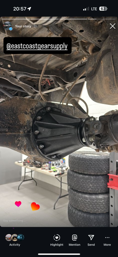

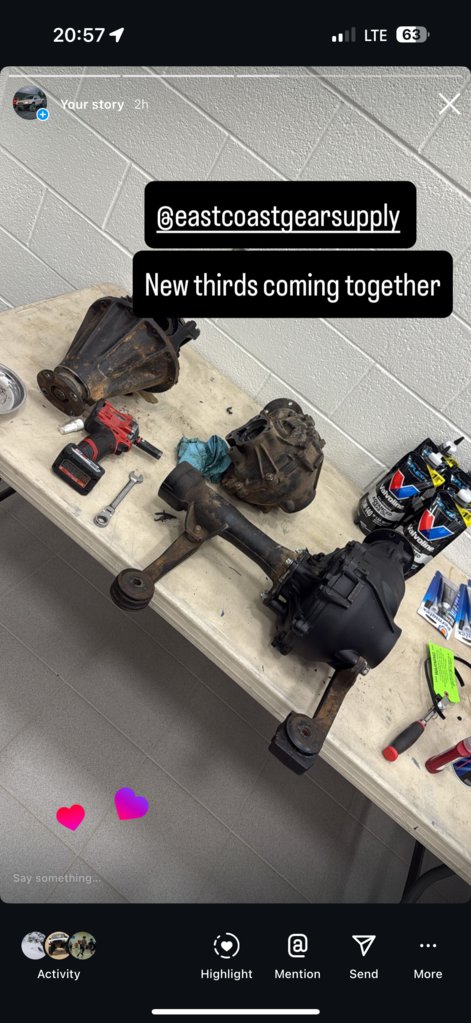

    Both of the ECGS third members are in. Just waiting on RTV to cure so I can fill it with oil and start the break in miles.
