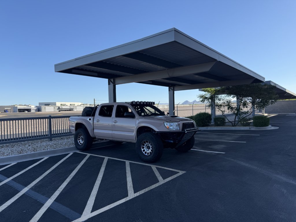

    Idk man @snowsk8air2 gapped the shit out of me in the cinders :burnrubber:

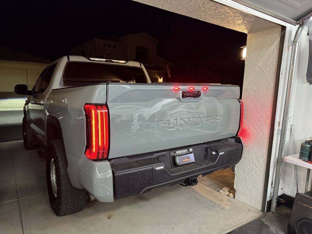

    Bought a trd pro tailgate spoiler, sanded off all of the texture, and paint matched it.

    Looks more OEM than OEM.

    That was the goal. I kinda think the TRD pro trim looks like shit on every color except for black.

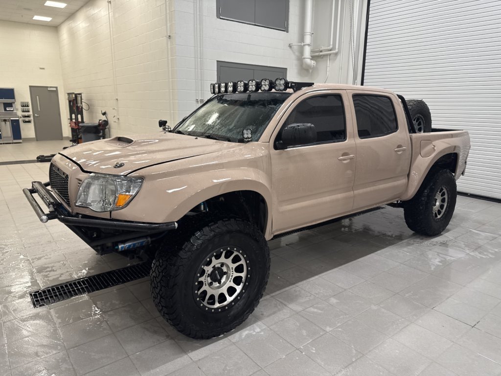

    Did a full detail on the truck today. Also tackled laundry list of items.
    retightened the trans cooler lines at the bed bulkhead, started to seep a little fluid, one of the 45* fittings was slightly loose.
    put a spare tire tool kit in the pro eagle box
    refilled the coolant reservoir and radiator
    side note: I want to get a coolant reservoir bottle that mounts to the cage tie ins above the radiator, to hopefully help with burping and filling, since it’ll definitely be the highest spot in the loop. Does anyone have any suggestions or ideas for this?
    replaced the zip tie’s with actual nuts and bolts for mounting the MSD relay and bus bar in the bed. Zip ties got all sun fucked and broke, and the msd was just slamming around back there.
    zip tied the roof light bar wire so it’s not flying around either
    Covered the drive floor in duck tape, since the aluminum on the butyl sound deadening wore through and my shoes kept getting covered in sticky butyl. This is temporary until I get an actual vinyl carpet or something.
    polished up the front skid plate too.
    I’ve officially got 100 miles on these new gears. At 500 miles, I’ll be doing an oil change on the engine, setting the trans fluid level, changing front and rear diff fluids, and bleeding the brakes. Should be the last bit of prep for this thing to be ready to rip again.
    oh and side note, need to fix my AC. I think my arduino module is toast. I want a hardened version of it that can withstand the vibrations and heat in AZ. I was dying driving this thing around today in the 108* weather.
    the truck really wasn’t a fan either. Coolant temps got up to 201, which is the norm for GM stuff but I have a 170* thermostat in this thing, so it makes me a little nervous. It stabilized at 201 though, was about an hour in stop and go city traffic, lots of lugging the engine. Am I being stupid for getting nervous about this? Or should I put a fat pusher fan on the front to assist the pullers? I think the elevated coolant bottle will help big time though.

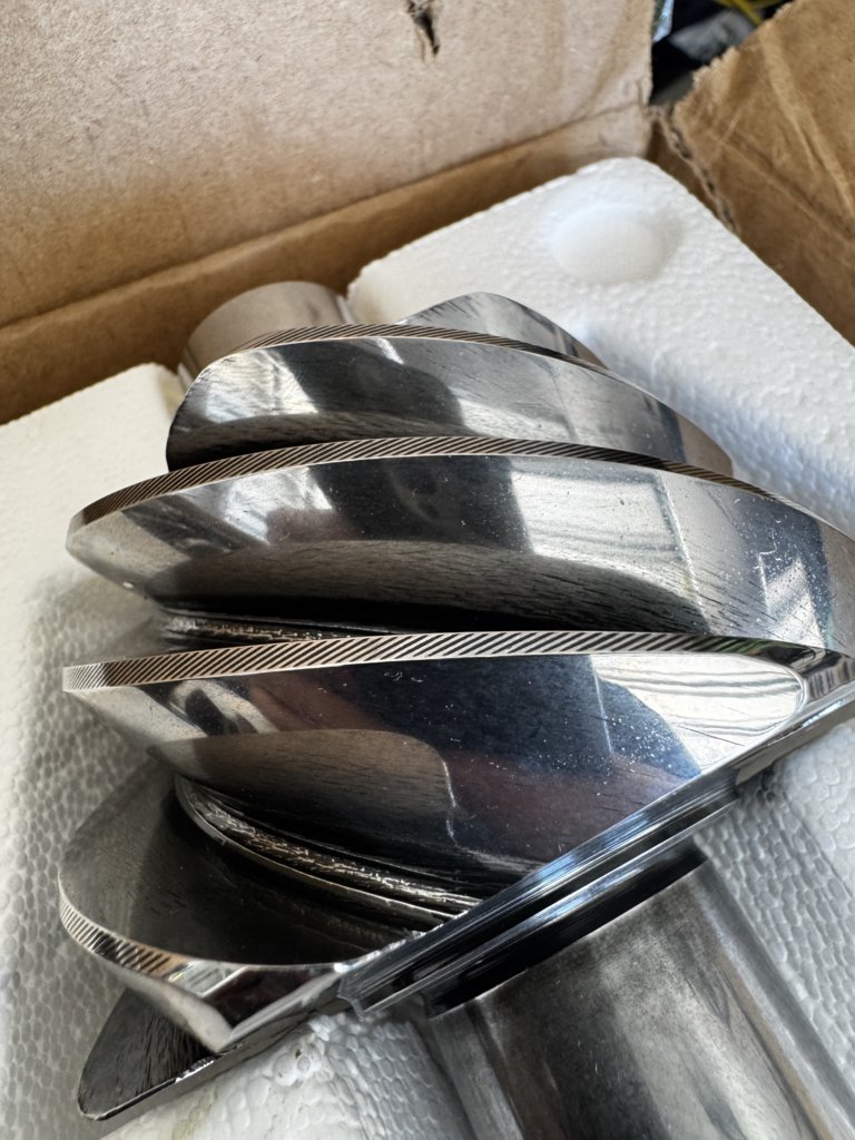

    Yup. Last set of gears I got are REM
    polished. Put them In a few weeks ago and went wheeling the next day.

    Those are beautiful.
    beggars can’t be choosers though. I’m just happy I got assembled thirds. The annoying break in is worth it. I don’t have the ability to actually do the gear swap itself
