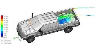

    Air in the bed is actually very turbulent. It's basically doing big circles and creating a cushion that the air moving over the truck runs over. So the air in the bed is all buffeting at high speed, but not in the directions you want. Unless your fans can move air faster than the speed you're driving, they won't get much through the rad.
