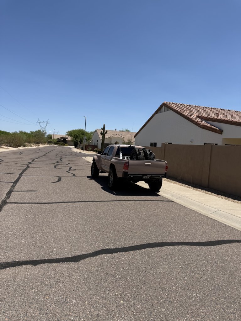

    Engine temp was at 225. I wasnt about to keep driving it like that. The ambient temp is so high here that if these fans aren’t turning, the truck will overheat so fast
    edit: also takes forever for it to cool back down to a driveable temp. By the time I got back to the truck with the trailer the temps were still 190.

    I tried, but there was no getting that truck home without risking warping the heads lol. I could’ve done 100yds at a time probably but it is what it is. So frustrated with this truck.
