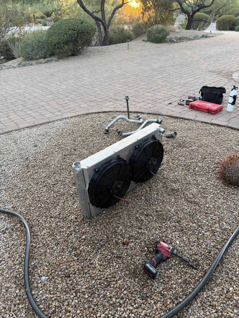

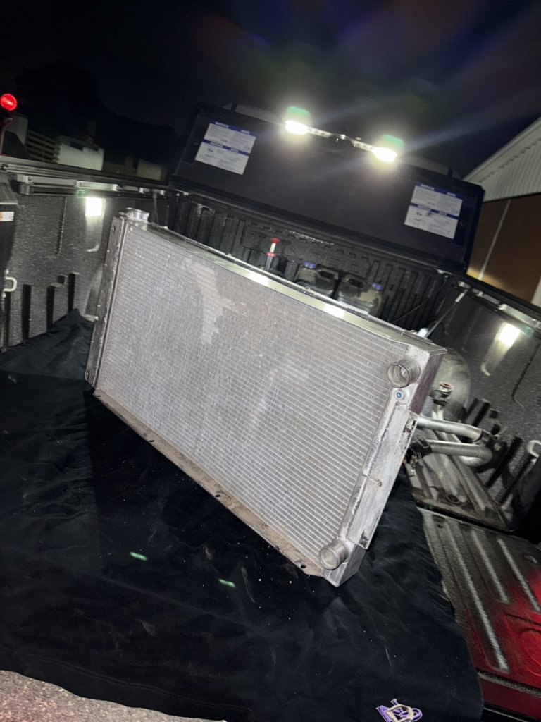

    Well this took all of 15 minutes to take out of the truck. Turns out the fan shroud isn’t welded to the rad, it just looks like it. Just gotta have new tabs welded on for the hardware and should be done tomorrow. The fans are still fucked and I need to figure that out but the rad should be installed tomorrow. The condenser will mount underneath the rad now instead of on top. All of the hoses are long enough and the brackets should be as easy as flipping them around. If not I’ll have new ones made to tuck it closer to the rad.
    I’m gonna call Steele and see if they’ll warranty them, or what the deal with the thermal management is. I should probably just put spal’s on it again. Sucks I didn’t save the old ones that I took off.

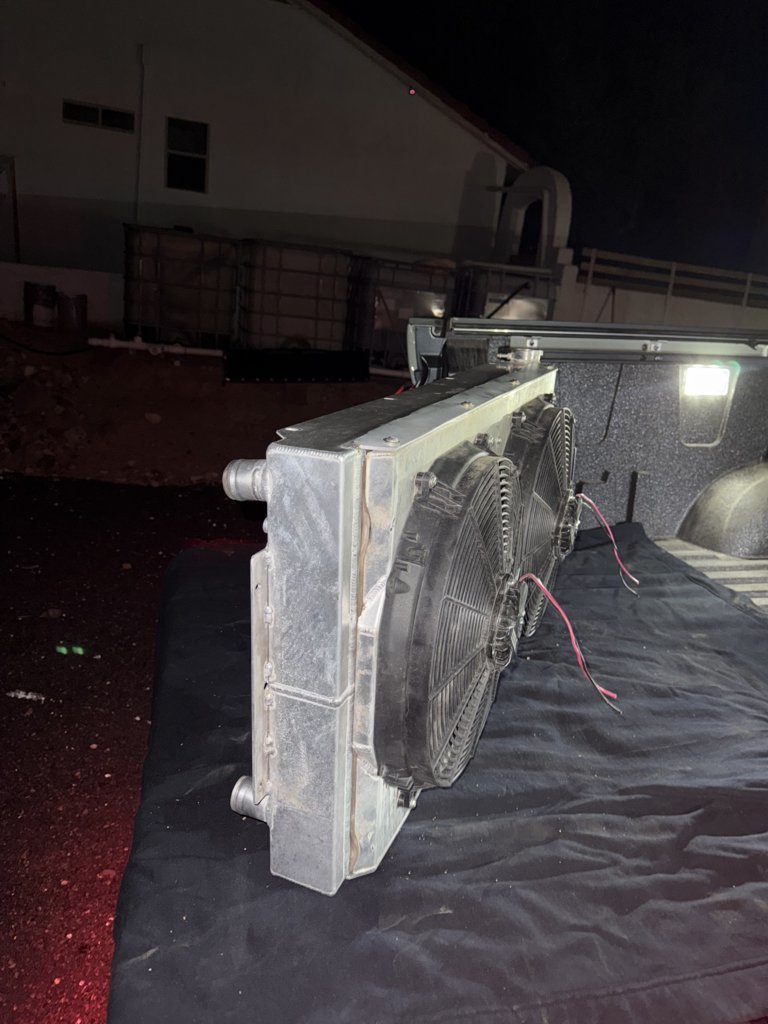

    Well @WormSquirts
    fans are now on the correct side in a puller config.
    gonna call Steele tomorrow and figure out their bullshit. Should probably just go buy 2 new spal’s and forget about the fancy bullshit. But rad should be correctly set up now.
    only thing left up in the air, is if my condenser will bolt up to the back side no problem. It should, only thing I’m worried about is clearance to the coolant hard lines. Worst case if it doesn’t fit, I’ll drop the truck off at the dude who fixed the rad and he’ll whip up some new mounts for me. I’m trying not to have to evacuate the AC system.
    I was out flying around all day so didn’t get a chance to test fit, but will tomorrow. Need to go get some new stainless hardware to replace some black oxide bolts that are rusted to fuck already.
