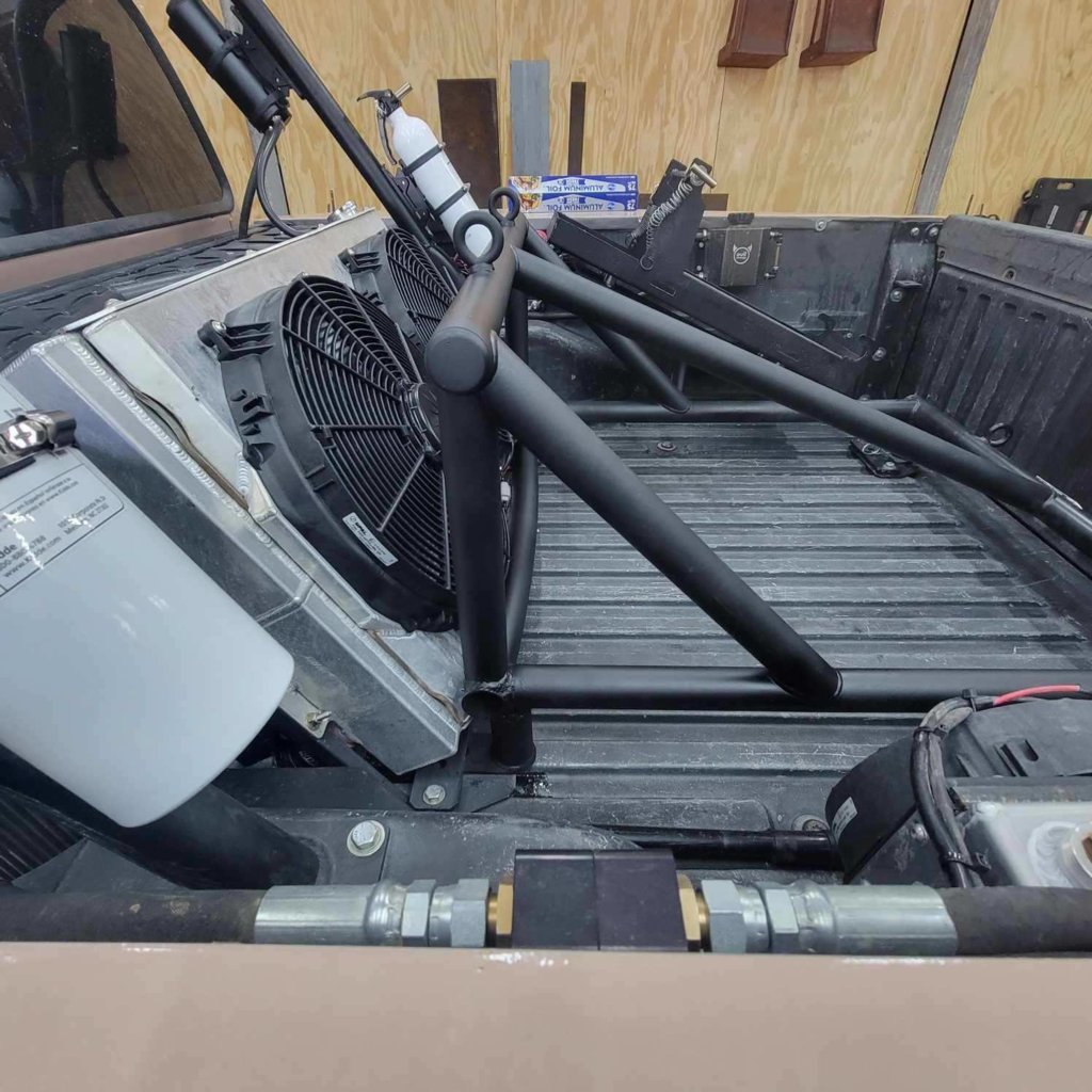

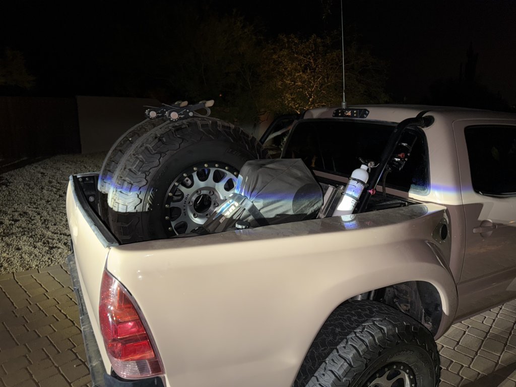

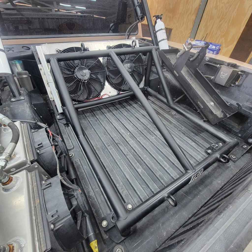

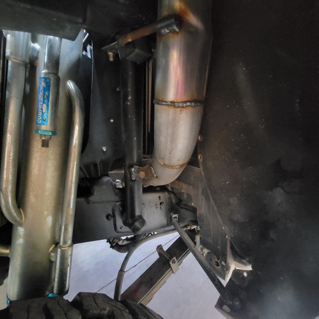

    Resized_20250712_113802.jpg Resized_20250712_113754.jpg Resized_20250712_113810.jpg

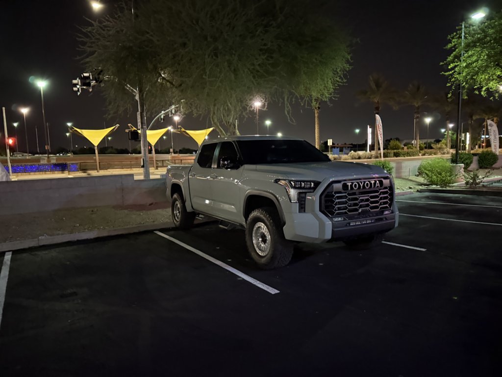

    Well driving around today at highway speeds while it was 106 out, the temps were rock solid ~184 ish. Really doesn’t even need the second fan now that they’re oriented correctly. I also had the exhaust hard mounted to the frame right before the fender exit so it doesn’t rattle anymore, and the tire cage was modified to fit the existing feet and not interfere on the fans anymore. We’ll see how it does tomorrow driving at highway speeds with the tires back there, since it’ll change airflow pretty significantly. I bet it will do even better.
    Also:
    dropped the tundra off today, had my homies where I used to work raise the front end a little bit, adjust the pano cameras, oil change, alignment etc etc. truck sits level now and looks/feels way better. I just paid Westcott Designs to do this, but they wouldn’t raise it anymore without doing control arms and axles:confused:
    I understand their reasoning behind it but at the same time, I know what I’m doing, and if I fuck up an axle, I’ll deal with it, but I’m not going to be dropping 4k at their shop to raise it a half inch.
    essjay, armyoffoo, Torspd and 5 others like this.

    For the Tundra, did they adjust the headlights down so you’re not blinding on coming drivers with your low beams also?

    Lmfaooo
    The truck is now level so they’re perfect now. They were too low before
    Dude that’s really trick
