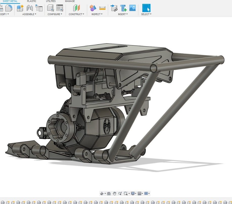

    I think I have everything I need other than the radiator to start it. Just need to wire and plumb it all up. Will need to make custom headers though. Man starting it would be so cool. Slowly getting closer to starting to actually build the upper half of the bulkhead. Just finished designing the jig. As soon as the front suspension is done I'll move to getting it running.
    Can't afford the Howe stuff or the spidertrax stuff yet, so I will hit a point where I can't move forward on the front suspension soon, basically as soon as the bulkhead is done.
    As for an LS swap, I'd say $10k usd is the bare minimum for a junkyard build if you do it all yourself, and it will only go up from there.

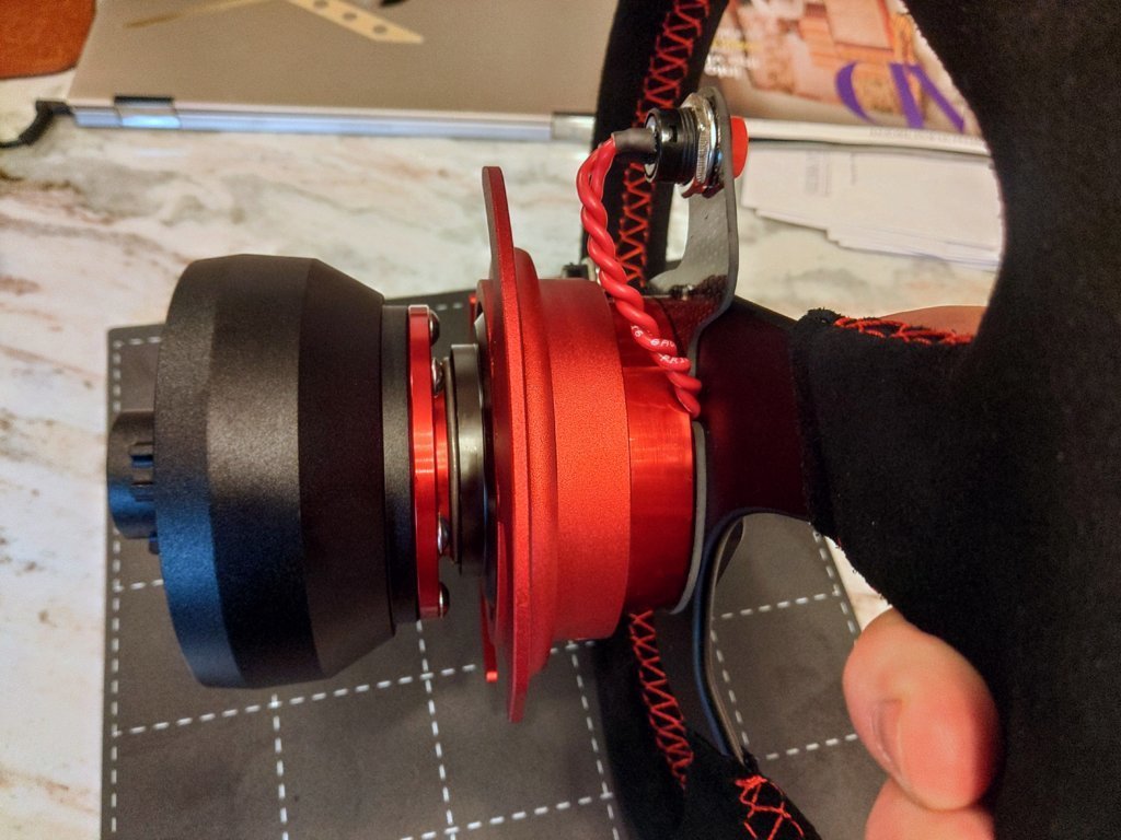

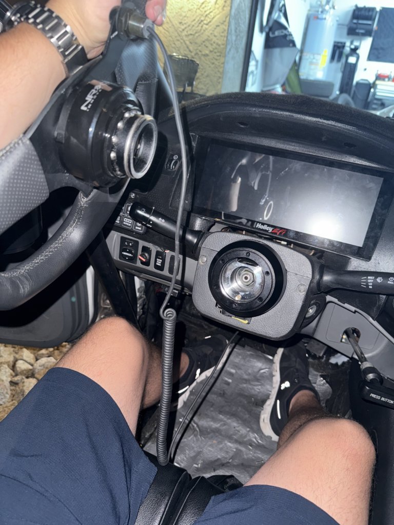

    What do you guys do with your spiral cables to keep them from getting tangled in the steering column and clock spring?
    Also my Holley dash mount is shit. I’m trying to get the guy that made it to redo it, Basically it’s a piece of wood screwed to the dash plastic with Velcro on it, and the screen velcros to the wood. Except the adhesive on the Velcro is sliding off with the heat. This mount used to look awesome, before I took it apart and saw how it was done. Hated it ever since but here we are. I re Velcro’d it for the time being.
