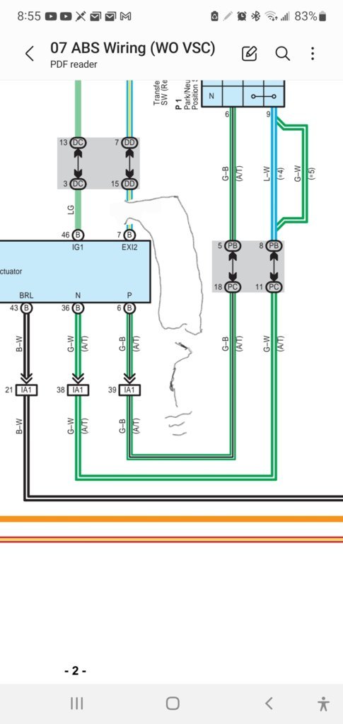

    I don't 100% know that this will work but I think you can use a SPDT switch on the EXI2 terminal to switch it to ground which would tell the Skid Control ECU that the rear diff is locked and disable the ABS.
    Kind of a crude picture I sketched up on my phone.

    TACOTU3 and BEAR_KNIFE_FIGHT like this.

    There's 3 powers to the ABS unit, not really feasible to cut all 3 or any of them without setting codes.
    Why not do it the factory way and ground the diff lock signal when you want to disable the ABS so it thinks the diff is locked.

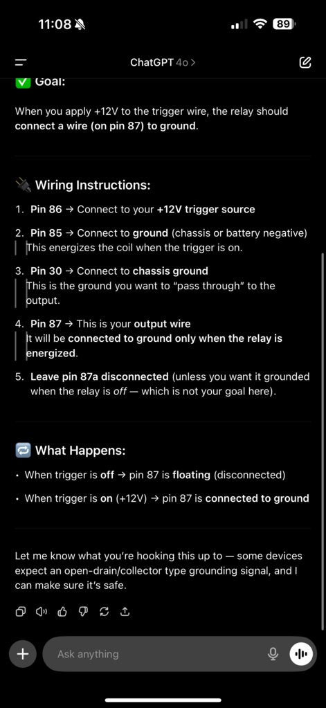

    Just curious how to make a positive 12v triggered relay do that.

    I’m a chatGPTard

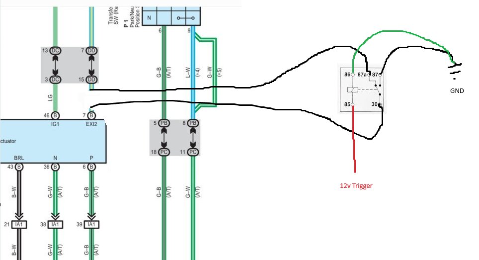

    Well for a standard relay:
    Pin 30 to the EXI2 wire from the ECU
    Pin 87a to the other end of the wire
    Pin 87 to Ground
    Pin 85 to Ground
    Pin 86 to your positive trigger
  13. Jul 17, 2025 at 11:20 AM
    #2633
    Pittsy
    Pittsy [OP] AKA LS6Taco - Ex car guy, current truck guy.
    Jan 20, 2022
    #387923
    2,613
    AZ
    07 DCSB 4x4, 25 Tundra Limited
    BTF Fab +4.5 - DMZ SUA - TE Cage - LS6 Stroker Swap - LS6Taco
    Sweet I’ll try and get that done tonight or tomorrow. Thanks for the help!

    The ABS light should come on when that wire is grounded and go out when it isn't.

    Here's a better drawing.
    Torspd and TACOTU3 like this.

    Got it thank you!

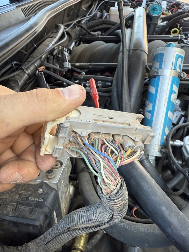

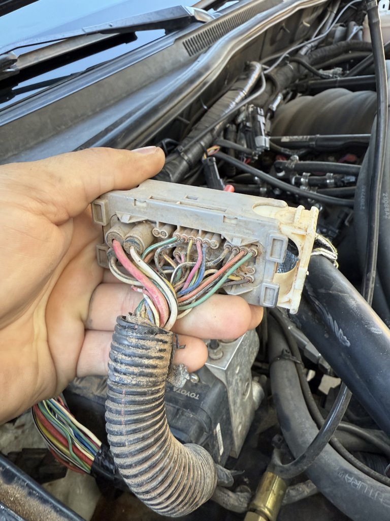

    Is EXI2 the only one that’s blue with a yellow stripe? I’m not sure how to count pins on this wacky connector, but I only see one blue yellow stripe wire.
