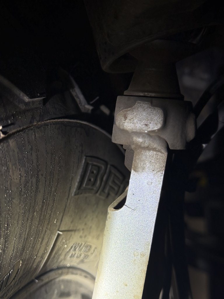

    Well I got the truck figured out. Pulled all the ac lines off the truck, blew them all out, no blockages at all. Replaced the expansion valve just for giggles, and it’s all good too. Recharged to 1.5lbs, got the truck warm enough to turn the fans on and boom! Ice cold AC!
    also fixed my steering. Got it centered back up. No damages were found to the suspension, with the exception of a small crack in my spindle gusset now. The hit it took last night was really hard, definitely not its fault. But good excuse to upgrade I guess? Or maybe just stop drill it and reweld it. It’s teeny tiny. But if that’s all the damage from that huge hit I’ll take it.IMG_6341.jpg

  14. Jul 23, 2025 at 6:48 PM

    Torspd Custom Turbo kit [] Borg Warner 9180EFR Turbo [] Haltech Elite 2500 [] TiAL Q BOV [] TiAL V44 Wastegate @ 15psi [] CP Pistons [] CP Carrillo Rods [] ARP Head studs [] ARP Main Studs [] ARP Header - Head Studs [] Ported Heads w/ 1mm oversized valves intake/exhaust [] Brian Crower Forged Stroker Crank [] Darton M.I.D. Sleeved Block [] Kelford Camshafts [] Torspd 160* T-stat mod [] APR Large Fuel Rail [] Walbro 460 LPH E85 Fuel Pump [] FueLab FPR [] APR T56 Conversion Kit [] KP RACING Built T56 [] McLeod Racing Custom Twin Disk Clutch [] One Piece Aluminum Driveshaft [] MGW Shifter [] Custom lowering kit [] Ohlins Front Coilovers [] QA1rear shocks [] Custom Ron Davis Radiator [] Dual SPAL Electric Fans []
    Re-weld, then put into a furnace or oil bath at around 650° F for about 6 hours. Then re-install. :D

    2011 S/C and basic mods
    Does the crack look fresh? Mine have all sorts of fatigue cracks. Can’t wait to get this project truck out of the garage and install the drt fully fabbed spindles.

    BTF Fab +4.5 - DMZ SUA - TE Cage - LS6 Stroker Swap - LS6Taco

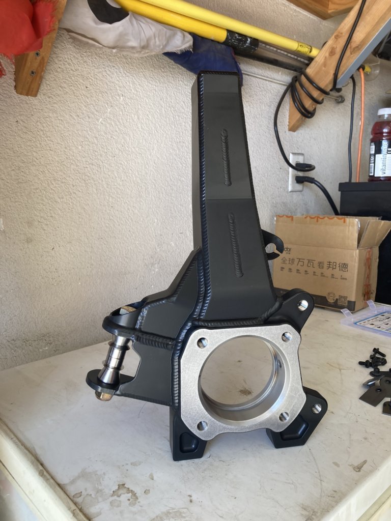

    Yeah pretty fresh, I mean I can’t remember the last time I looked at it, but definitely didn’t used to be there.
    I really want the new DRT spindles, but 2k for them is a bit much at the moment. Me and my wife just found out we have our first kiddo on the way. So should probably reel in the taco mods
