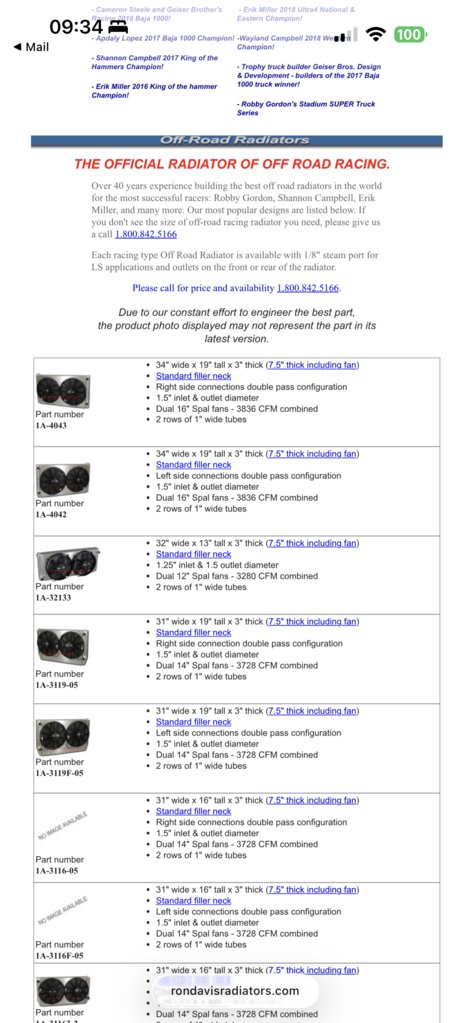

    I have their biggest off the shelf rad, the top option here. 1A-4043
    Use it!!!! Come on up! There’s gonna be a ton of us out there it’s sounding like. Gonna be a blast.
    thanks for the heads up!
    He came recommended by a few different shops here in the valley. I feel bad for always asking you for help hahaha. But this is good, especially since I just threw on some 3.0’s in the rear. Everything is gonna need to be messed with.

    Dope, thank you! I was looking at a 31x19. Wonder if that would be enough considering mine will be front mounted instead of rear mounted, so lots of direct airflow

    Definitely. That’s what I have but no direct airflow. @allenfab has a stock Tacoma radiator on his LS swap and it’s working fine IIRC
