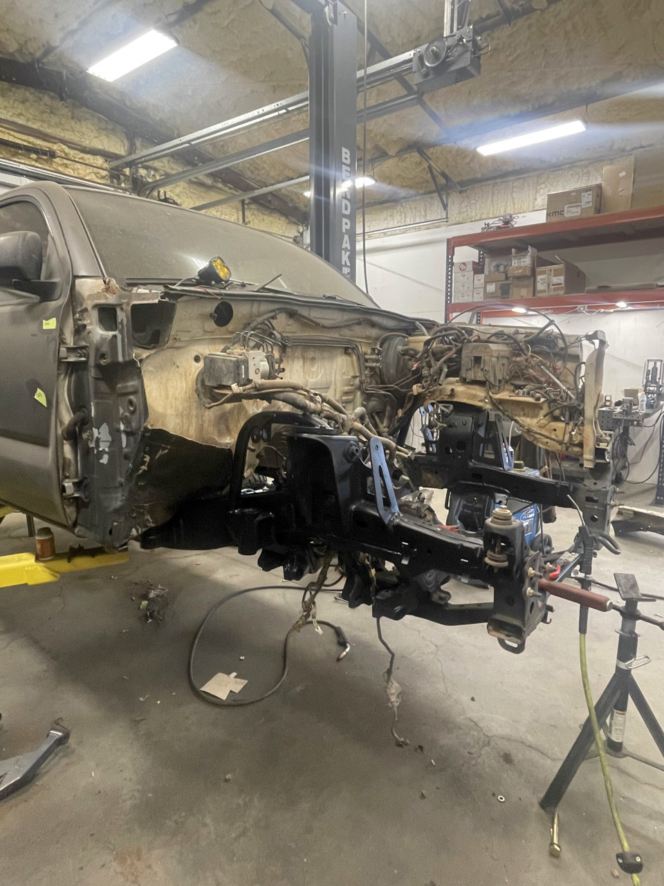

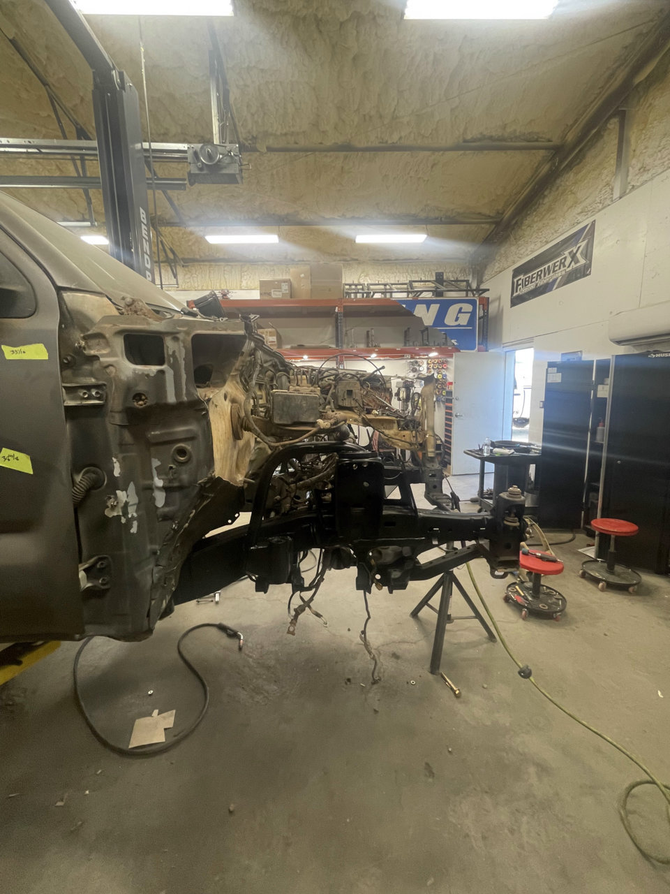

    LCA Pivots are done. Final assembly goes on tomorrow. JD fenders also arrive tomorrow so that'll be getting done as well. 454 is doing an incredible job.
    Im getting restless. I cant wait to get the truck running.

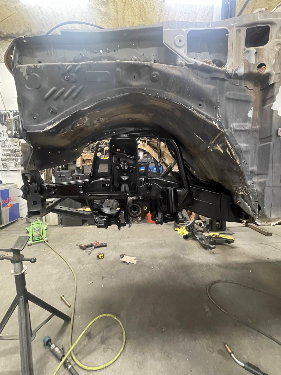

    For some reason, seeing these pics made me feel like this was the point of no return on the tacoma. obviously we passed that point a long time ago, I just thought it was funny.
    JD inner fenders getting slapped on.
