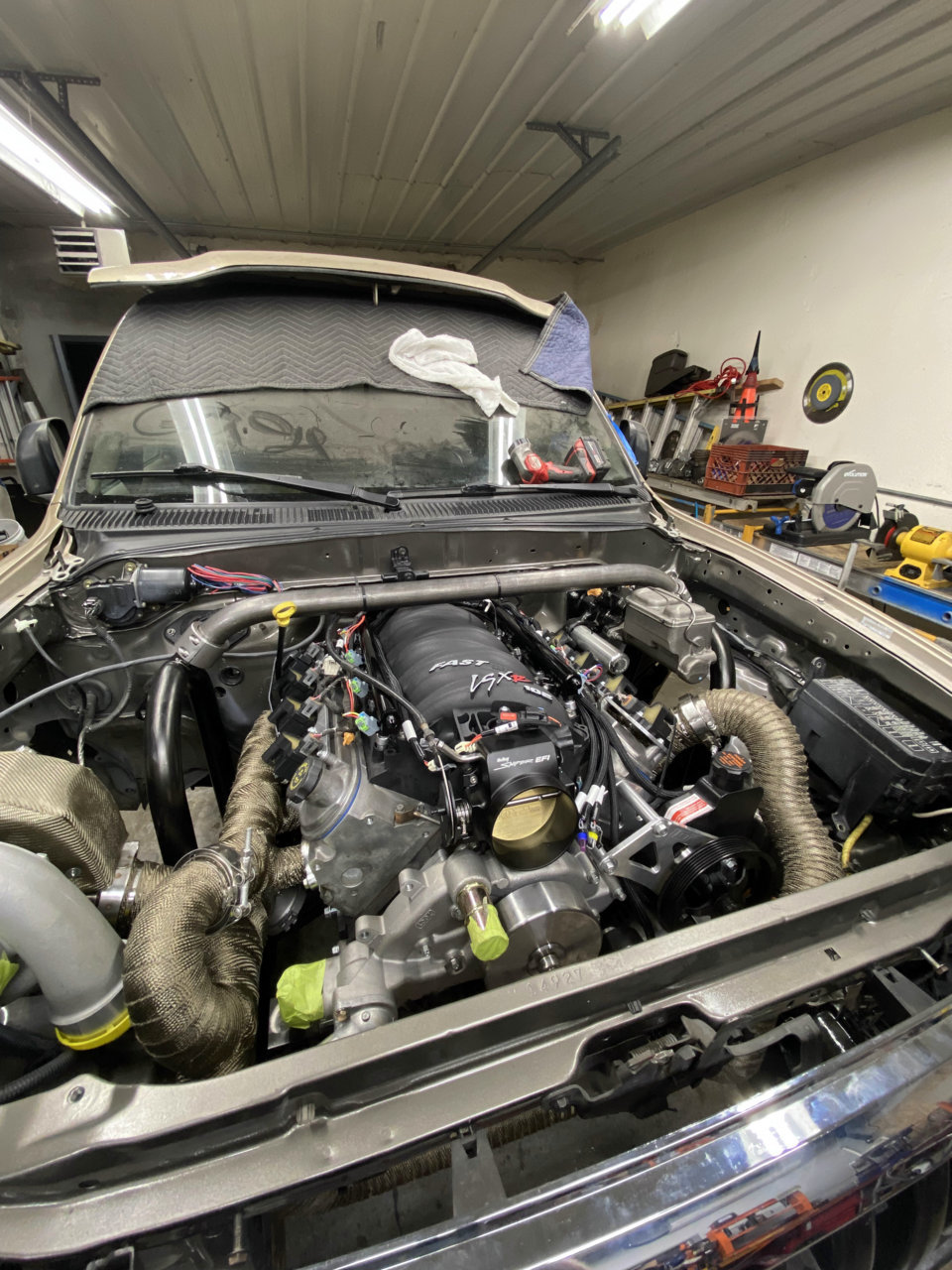

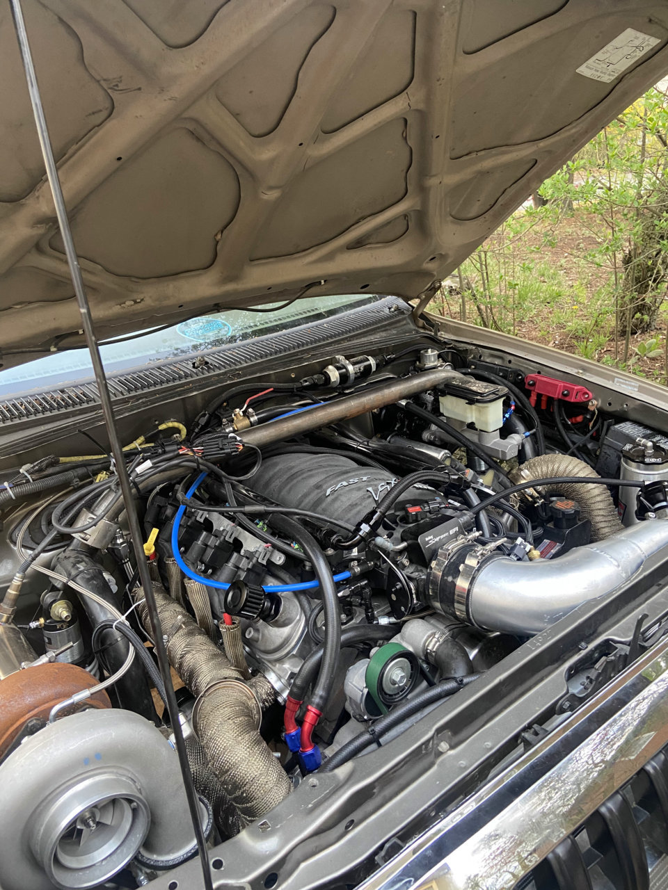

    Im not sure what you are even saying. First of all, that is a 2wd 4 banger and I am not talking about engine bay space. Im talking about the hood closing. If you ever put an ls in a tacoma or even saw an ls w truck intake in person you would know what im talking about. Especially if @Pittsy is gonna do some desert race setup. That engine is gonna be max height. This is a hood barely closing on an ls intake.

    Yeah I’ll have a crossover bar over the engine once it’s in. I need every inch I can get. This truck is 4WD so I gotta clear the diff which makes the engine sit up high.

    I guess I wasn't clear about my point. You can slam a motor to 5" off ground and put a blower under hood. What I am saying is, if you want up travel of 6" with an sas setup you need the motor up high if you want the truck to have a low stance w travel.
    If you wanna run factory diff and cv's then yeah, 1st gen will even fit a truck intake. If you want high clearance front with crazy prerunner arms I assume you want it high as possible too.

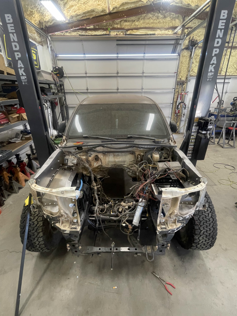

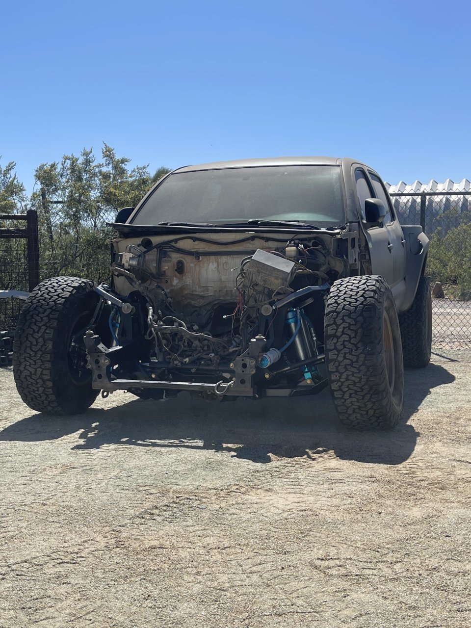

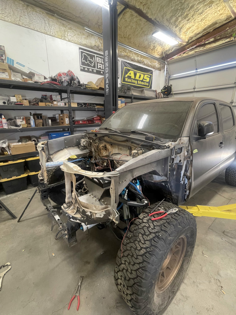

    JD Fab inner fenders are in. Picking up this weekend, then motor time!
