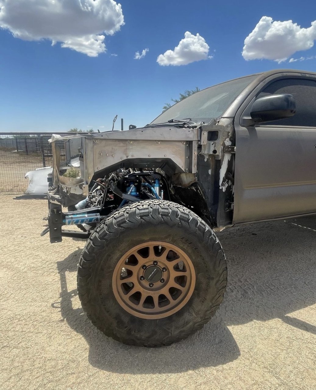

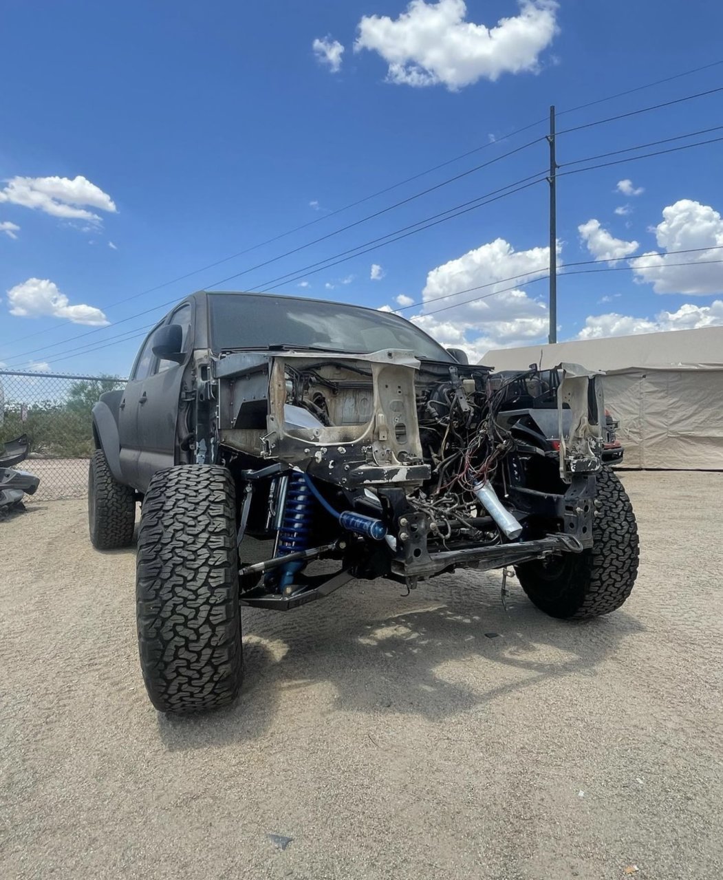

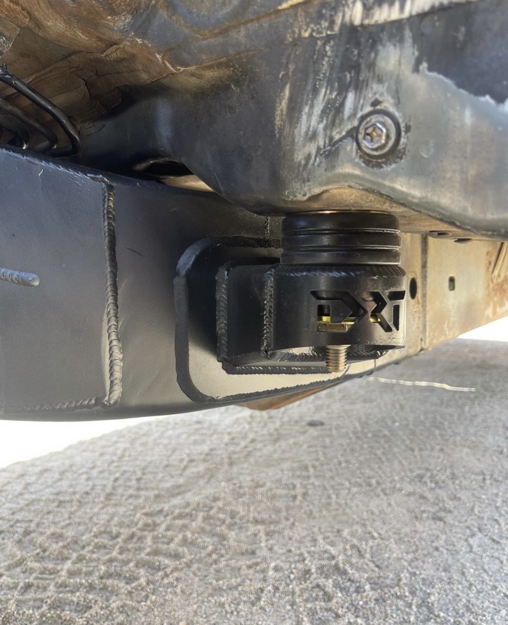

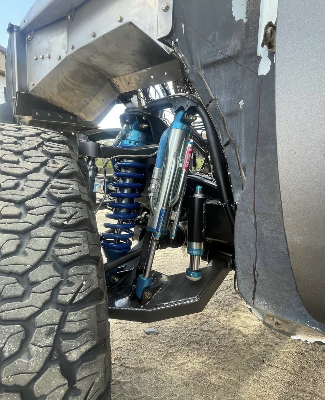

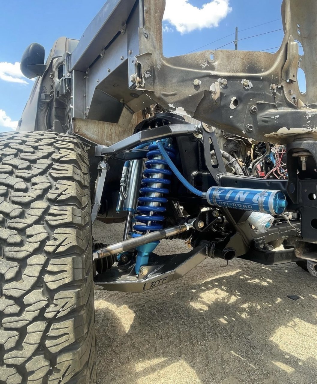

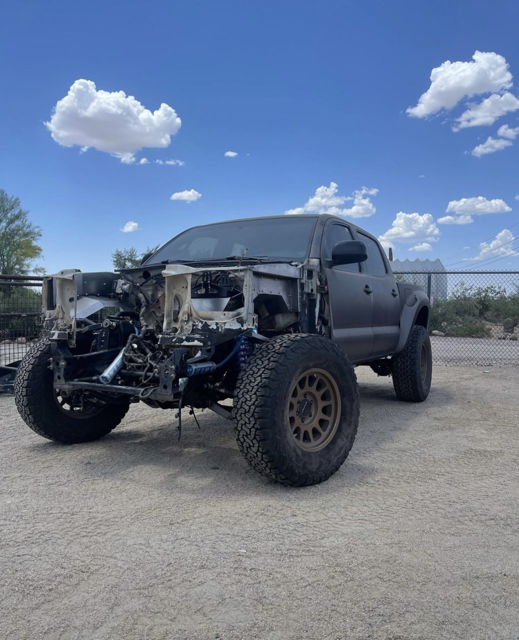

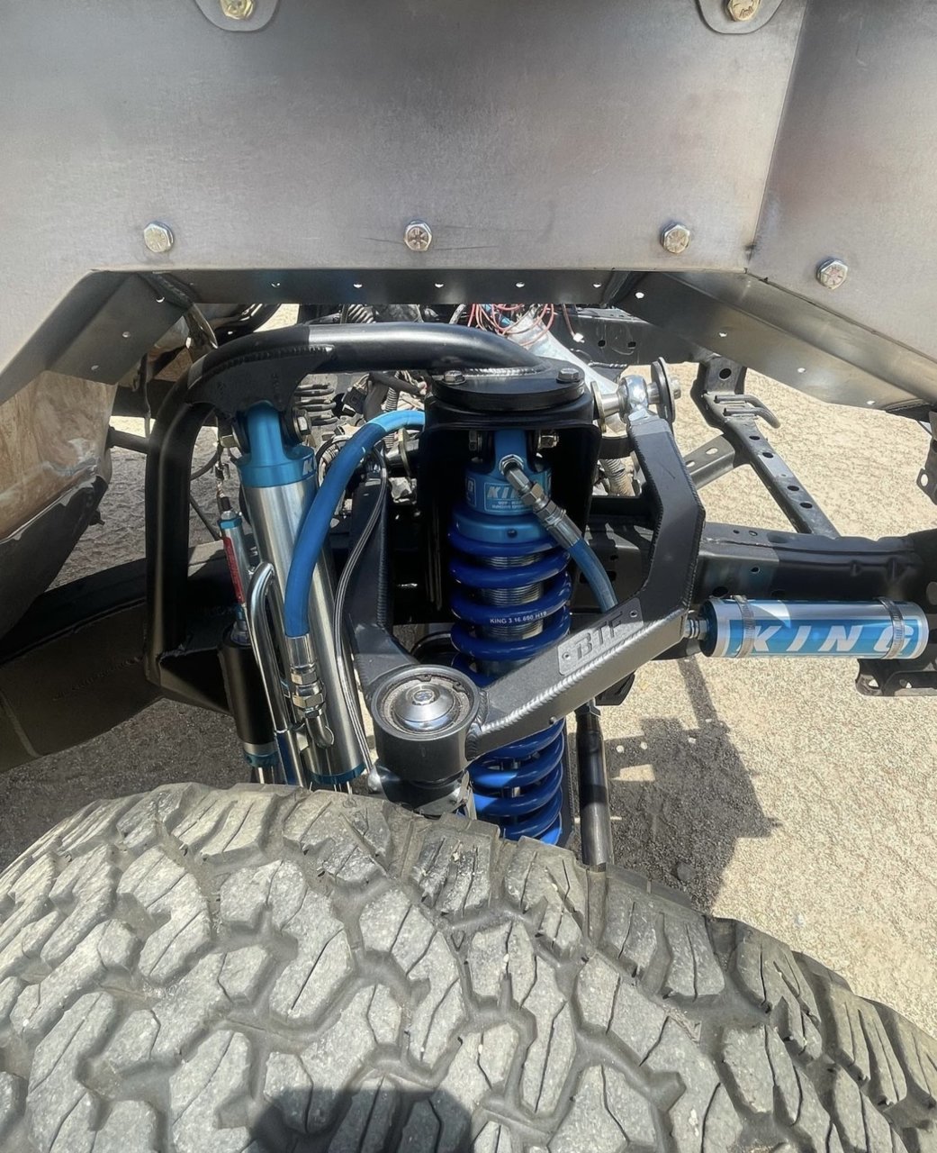

    IMG_4407.jpg IMG_4408.jpg IMG_4409.jpg IMG_4410.jpg IMG_4411.jpg IMG_4412.jpg IMG_4413.jpg
    Taking her home tonight. @454Motorsports did an incredible job. Its going to go back to 454 in about 2 months to have the front bumper built, engine crossover made, and some other finish items, like having the inner fenders powder coated after all the LS stuff is good to go.
