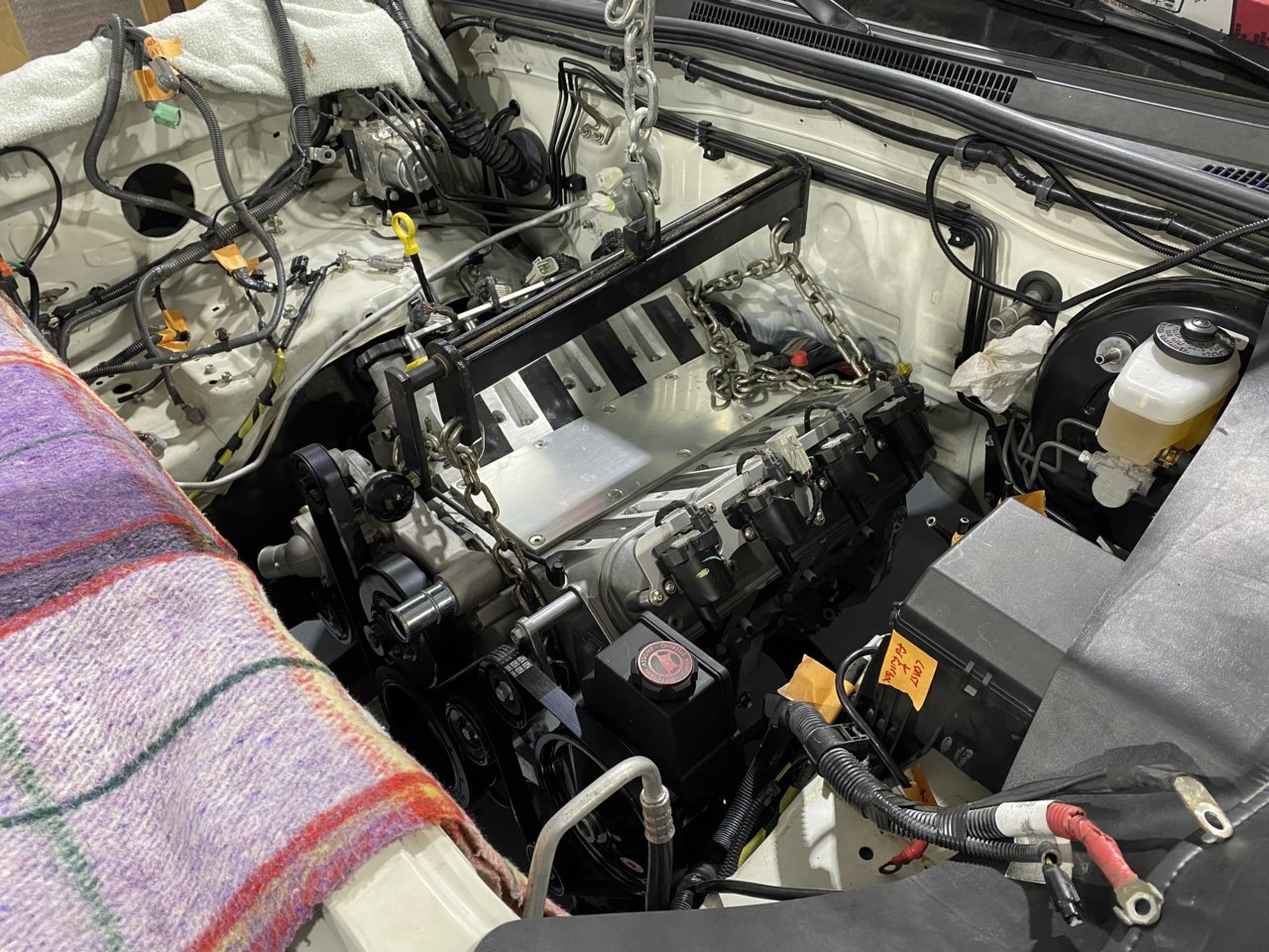

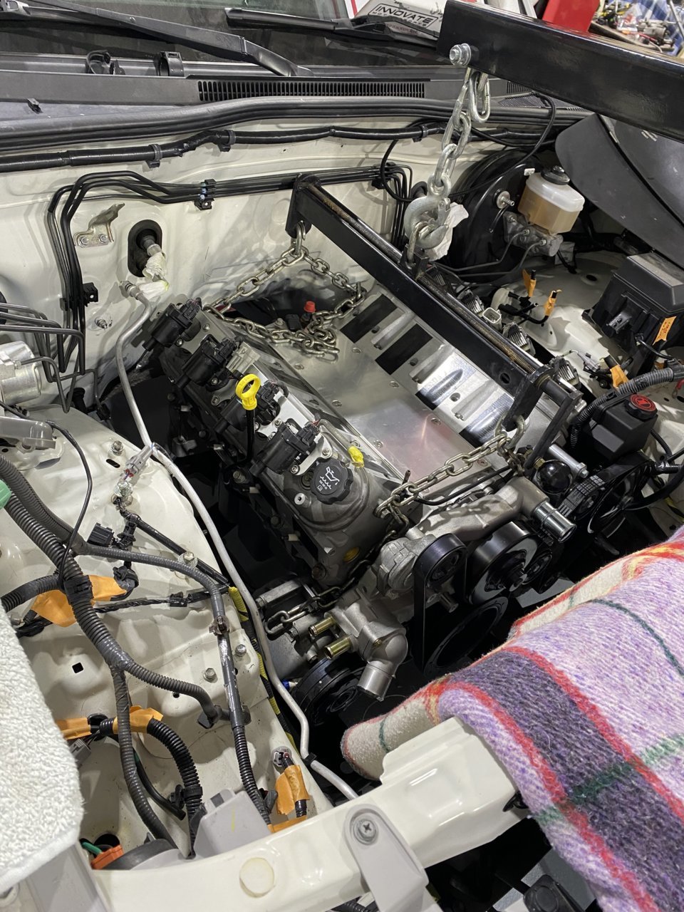

    Hmmm, gaining headway. The oil pan is an Holley 302-1 and is setting about 3/4” to 1” above the 5 lug cross member. (Don’t *think* it’s different than the 6 lug cross member but I really don’t know!) Oh, and didn’t have to cut the upper radiator support with the Vette accessories installed to drop in the engine.

    The crossmember isn't the part thats in the way, the 4WD Front diff is the part in the way.

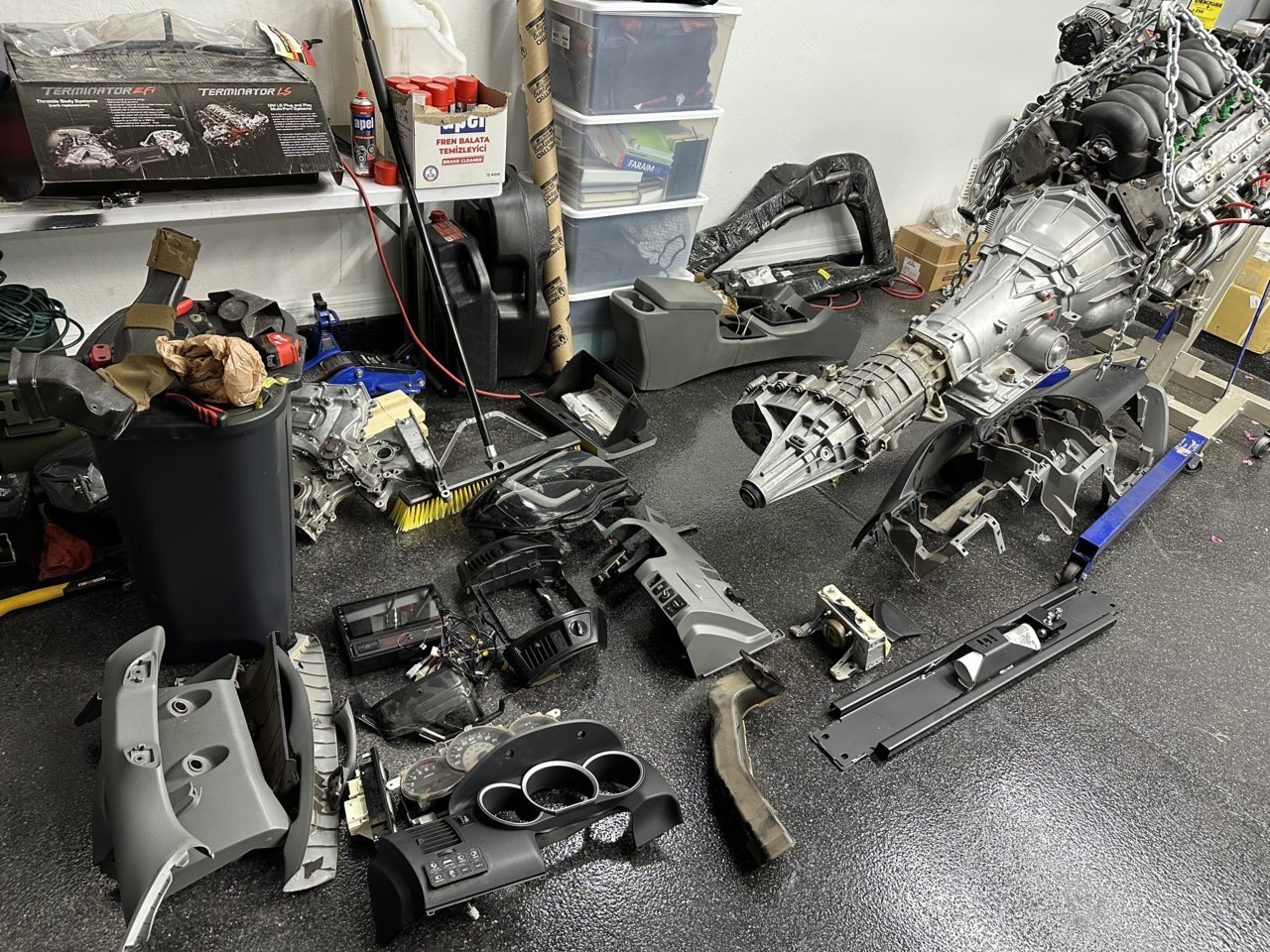

    This is stressful. Has anyone else done this and can give me some insight? I have to remove the crash bar from what it looks like. So much shit to remove to get to it.
  16. May 19, 2023 at 8:05 PM
    #356
    Pittsy
    Pittsy [OP] Ex car guy, currently in rehab
    Jan 20, 2022
    #387923
    2,319
    Davis
    Cave Creek, AZ
    07 DCSB 4x4, 20 DCSB PRO 6MT
    BTF Fab +4.5 - DMZ SUA - TE Cage - LS6 Swap
    Garage is starting to look like a junkyard.

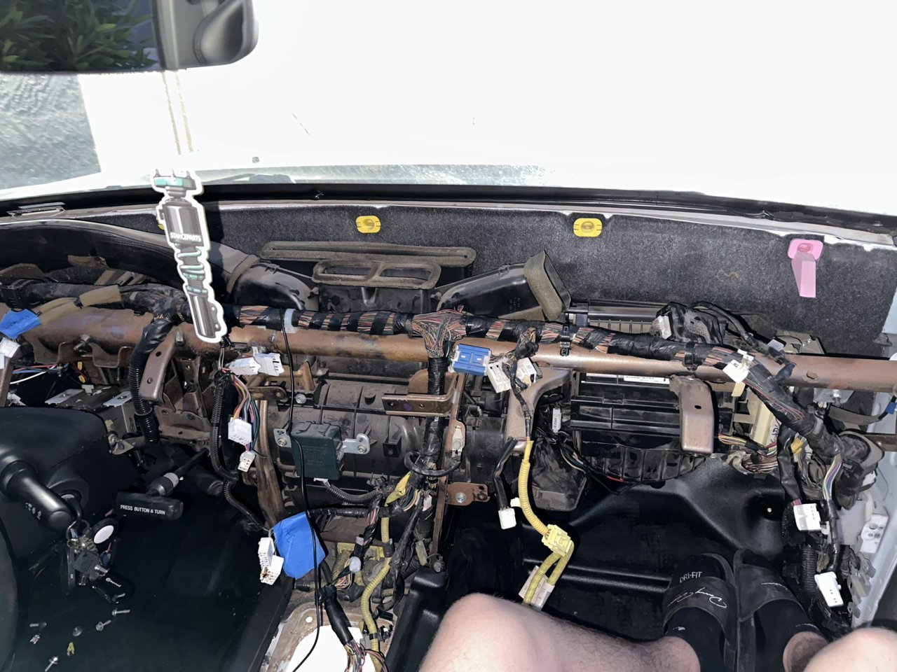

    As I started to dig deeper into the dash, the girlfriend comes home hootin and hollerin about her car leaking some kind of fluid. She dumped half her coolant out, so I spent the remainder of my night calling different autozones to find a radiator in stock. Swapped that baby out in an hour and a half and the dash progress continues…

    Turns out you can buy the OEM Toyota key fob receiver plus the fob for like 150$ and have keyless entry. Time to rip out the dog shit viper system.
    Since I am replacing the evaporator core, I'm going to replace the heater core too. Might as well since I'm in there. Probably going to paint the lower dash, the two tone isn't my jam.
    This is giving me a really good chance to un-fuck everything the previous owner did, plus whatever I've piled on top. :rofl:
