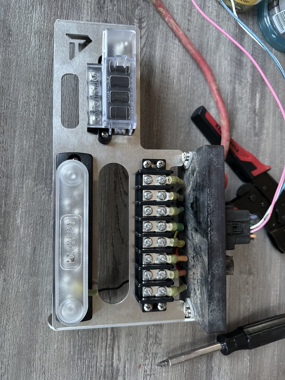

    powertrays setup going down. The aftermarket wiring was a shit show, so im over that. Ordered 50 ft of 0/1 and I’ll use that to do the big 3 and switch pros power.

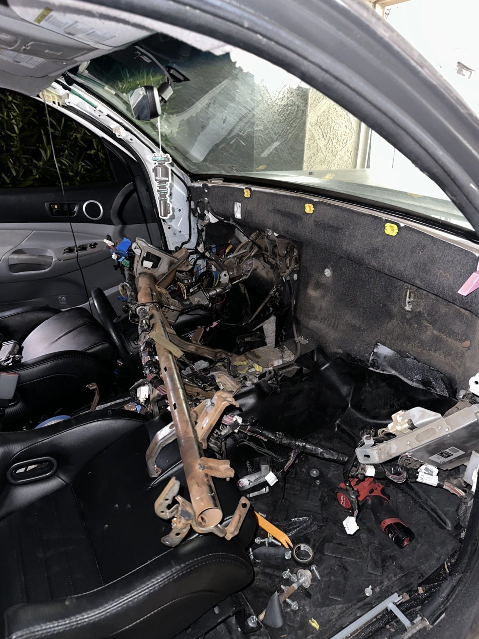

    If you didn’t know this truck hella bread worth of suspension you would’ve thought it was totaled by the way the interior and engine bay look currently.

    yeah that dash bar shows how dumb Toyota engineers can be… having it thru bolt from the door jamb on the drivers side than having the pull the cowl to pull that bolt as well…. Just dumb

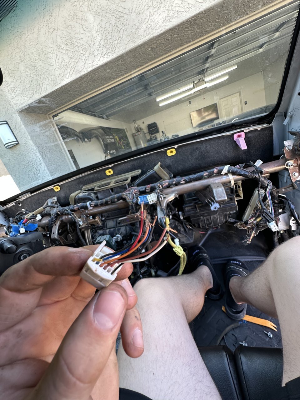

    Evap and heater core done, put the crash bar in and found this guy. I can’t find any broken wires anywhere. I was meticulously careful moving the crash bar so I can with certainty say it wasn’t me who broke this connector. Someone’s had the dash out before I owned it.

    Is that possibly an old stereo connector that got left is after a replacement by a previous owner?
