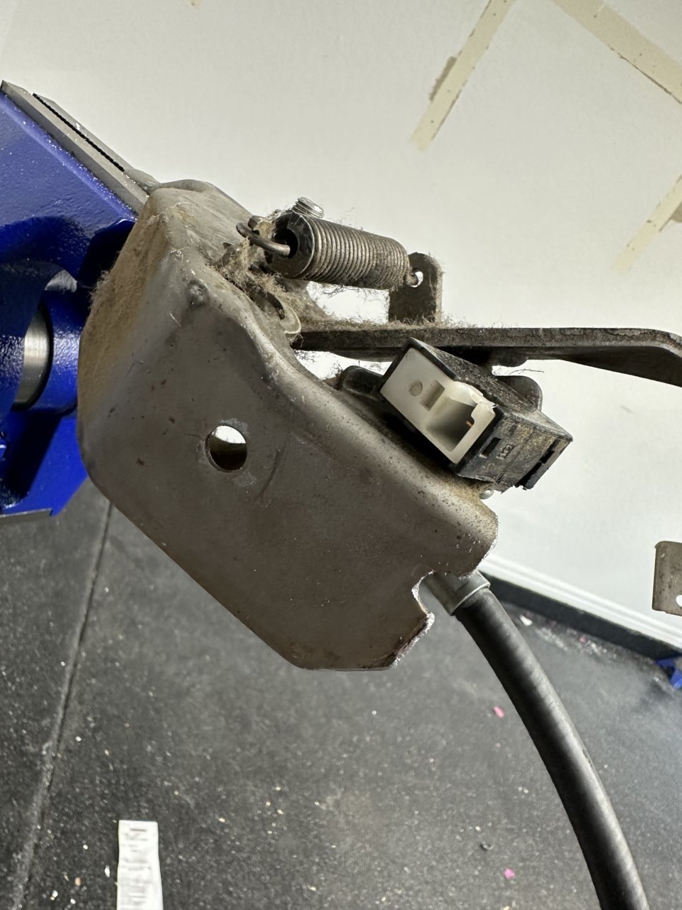

    That’s what it looks like. It was right behind the radio area so

    yeah it doesn’t look like a factory connector, styles a little different and colors are off.

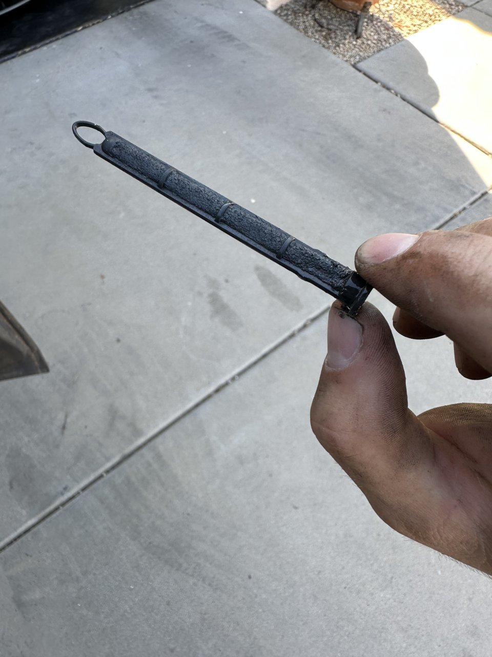

    Took apart the old expansion valve, guess it’s a good thing I replaced it with the evaporator. Lol.

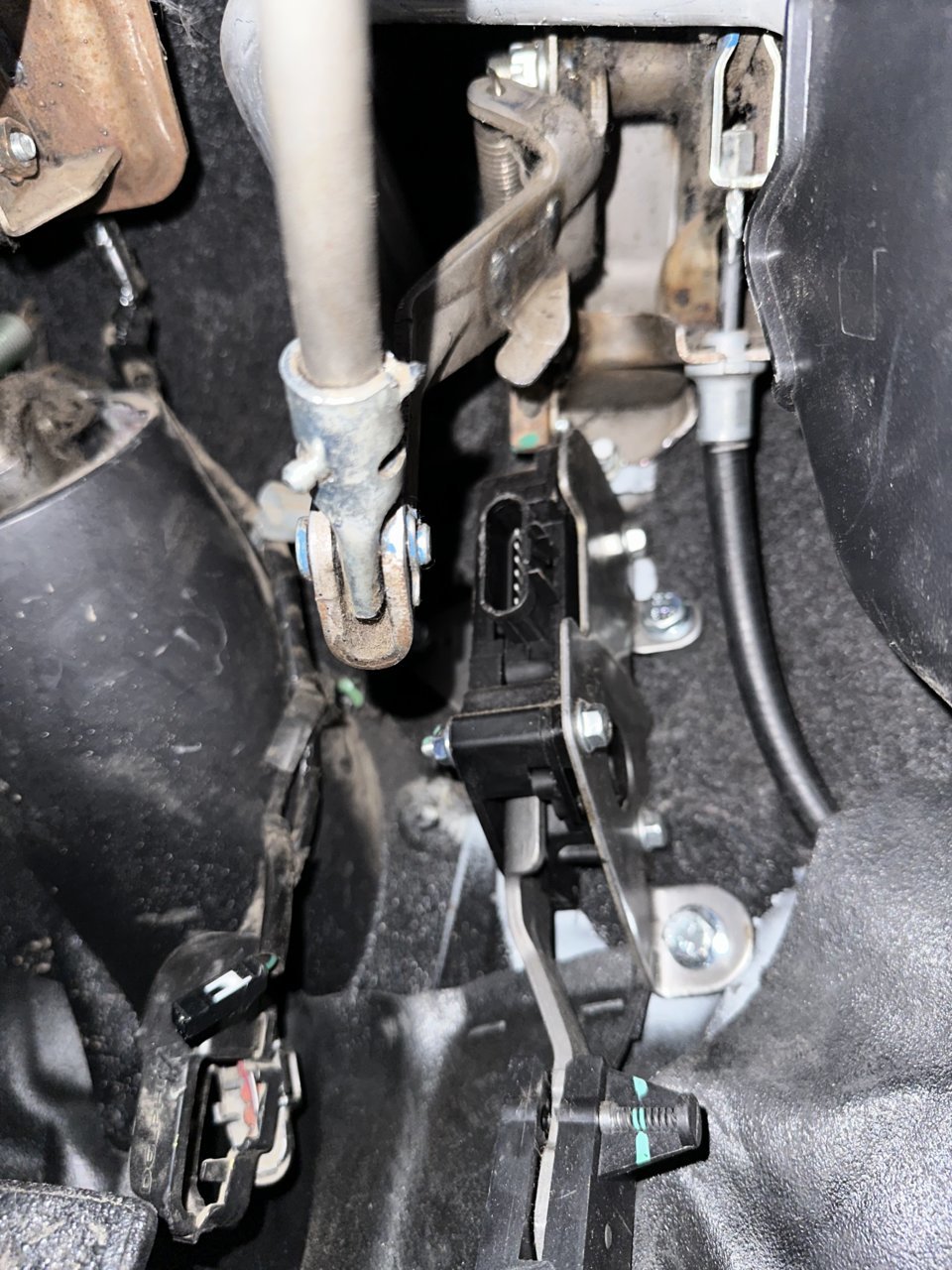

    So tonight I installed the key fob module, and tried to install the A/T parking brake. The at parking brake is no where near bolt in like i imagined it would. So I did some thinking, tired to refit the M/T parking brake in and really I found out that I was cappin big time about it not fitting. IMG_4560.jpg
    Cut about 3/8 of an inch off the bottom hole and voila it fits!
    pretty close quarters up there, but everything clears with good margins for safety.
    I’m happy with how things are coming along so far. I think tomorrow if I have time after work I’ll get the DBW harness installed and everything ziptied out of the way of the parking brake.

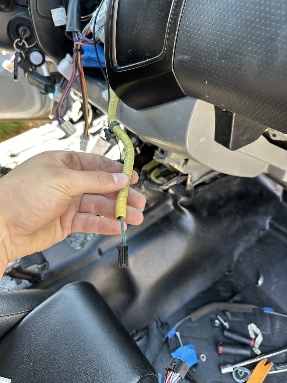

    Mystery SRS system wire. Any ideas? Other than that, dash reassembly is going swimmingly

    That is the passenger airbag on / off switch wire that would have been in that blank panel to the right of the radio right above your hand in the photo. Some early 2nd gens had a key switch in that panel to turn it on and off.

    my truck isn’t equipped with the switch. I wonder if there’s a dead plug or something it’s supposed to go into.
    I had another thread started that @Dm93 and @karibemakira figured it out for me.

    The dead plug is on the back of that panel I mentioned
