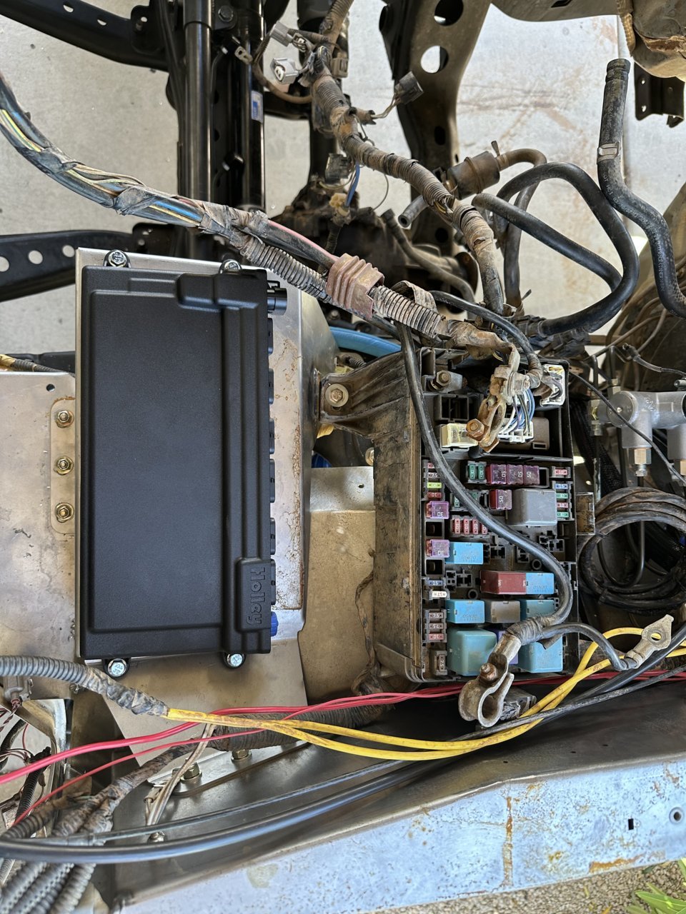

    Im struggling to find a good place to mount in on the interior.

    I bolted mine to the a pillar under the dash, but if you pulled ur airbag from the pass side just make some tabs off the dash bar there.

    I kept the airbag system intact on the truck, but that has me thinking. Wonder If I can mount it to the backside of the glove box or something. I'll need to do some digging I guess. I'll worry about it after the engine is mounted. These mounts need to get done.

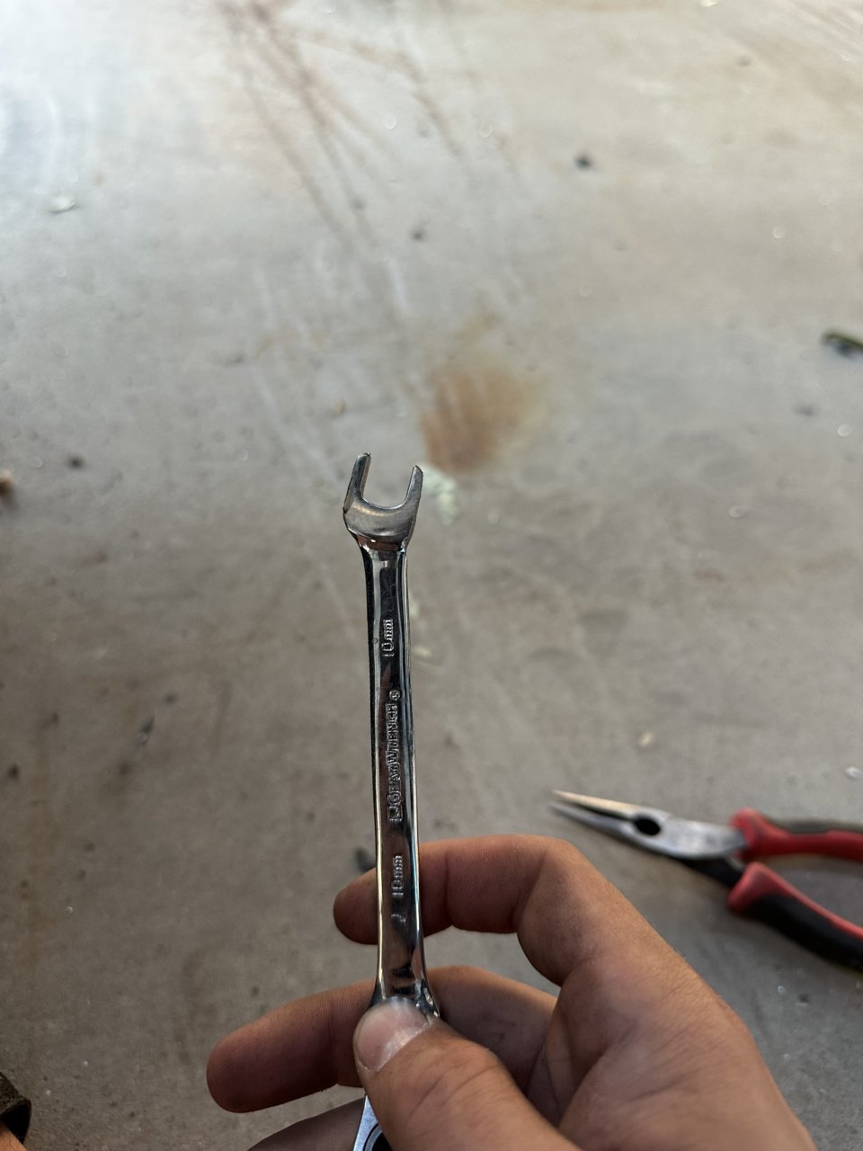

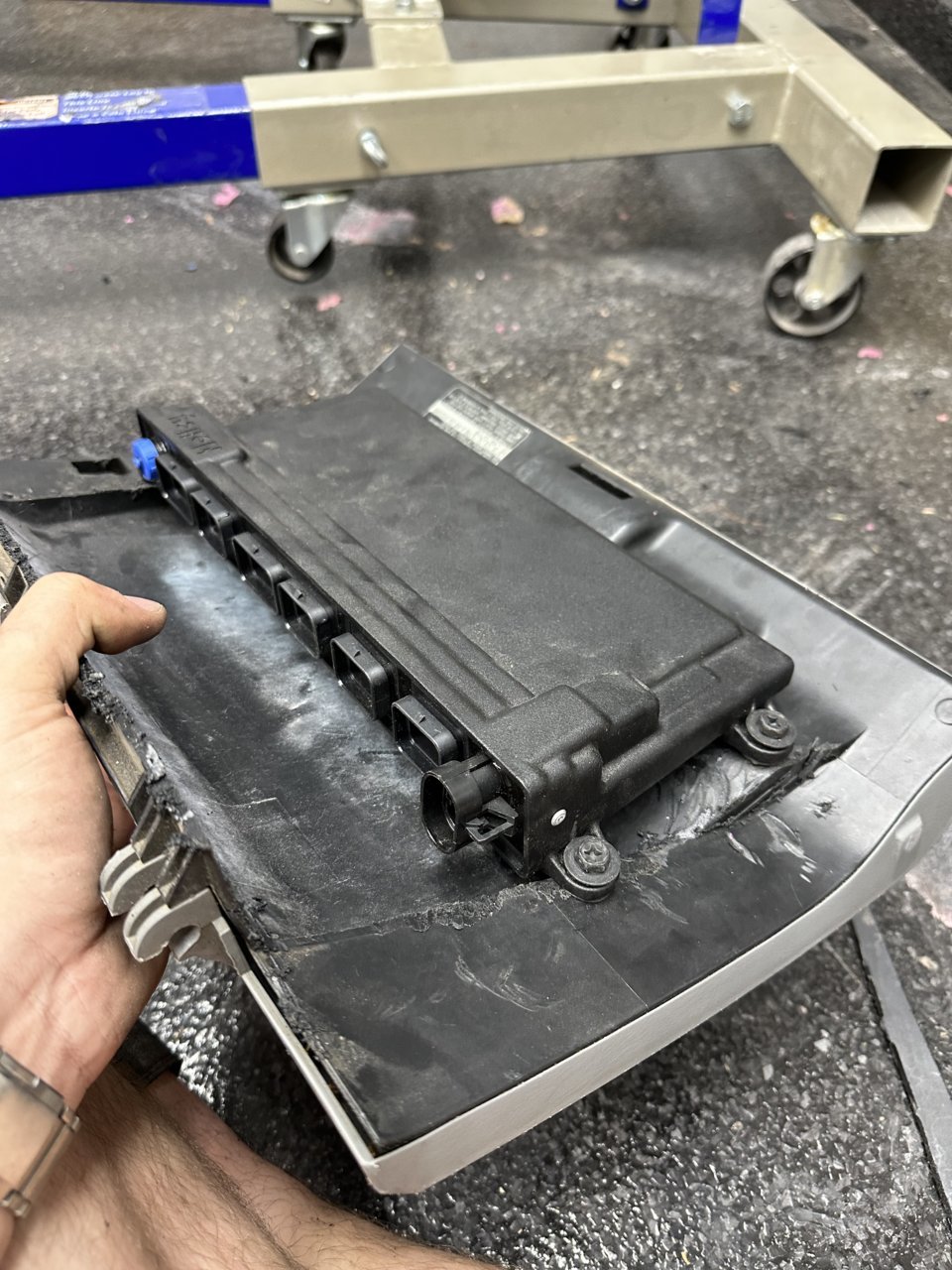

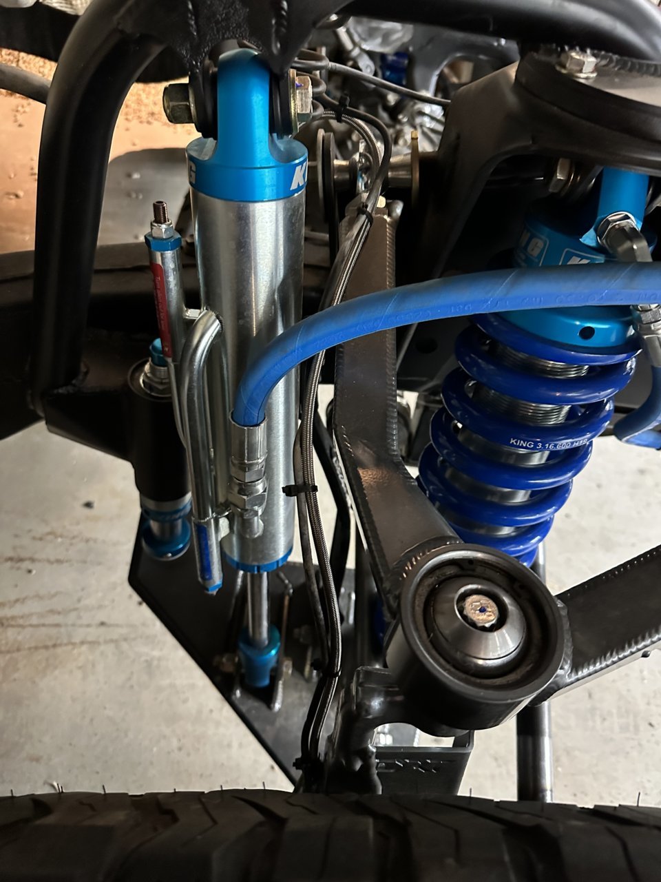

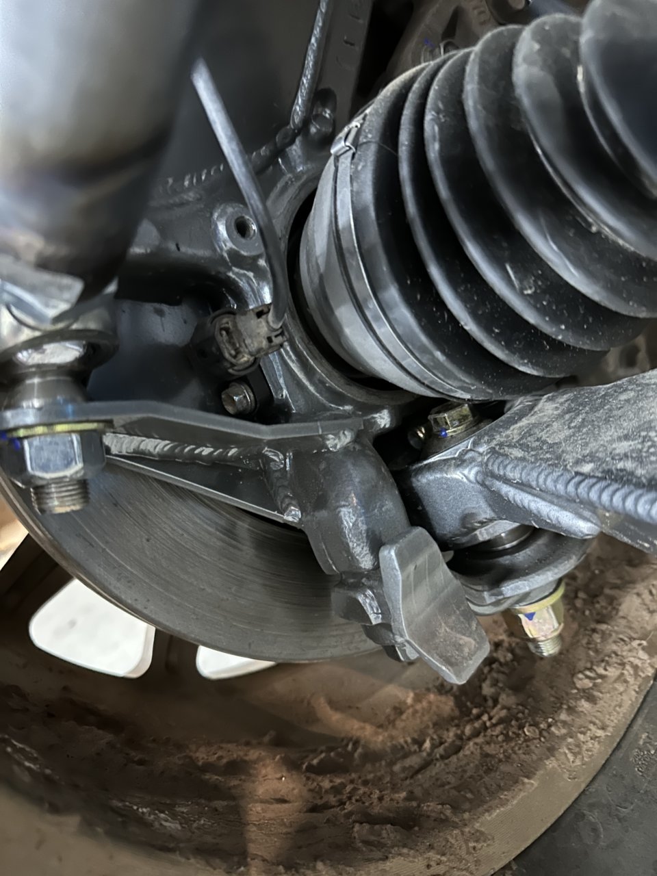

    Every single time I work on the truck I feel like I get farther and farther away from finishing it. It’s defeating.
    Anyways, I got the harness clipped down to the essentials for what I need. I’ll mesh insulate everything and make it look nice once material comes inIMG_4628.jpg
    I got the wheel speed sensors installed:
    man, what a PITA with the double sheer steering tabs and spindle gusset. Had to turn my 10mm gear wrench into a gimp:IMG_4615.jpg
    Zip tied the wheel speed sensor and brake lines together and cleaned them up:
    And modified my glovebox hella to accommodate the Holley. Atleast it’ll be protected from the elements now.
    All that done tonight and still feels like I got myself nowhere.

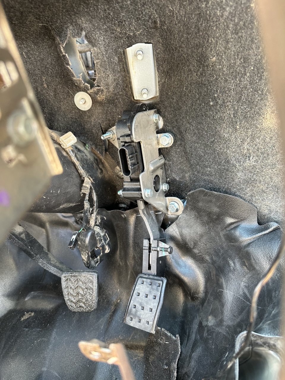

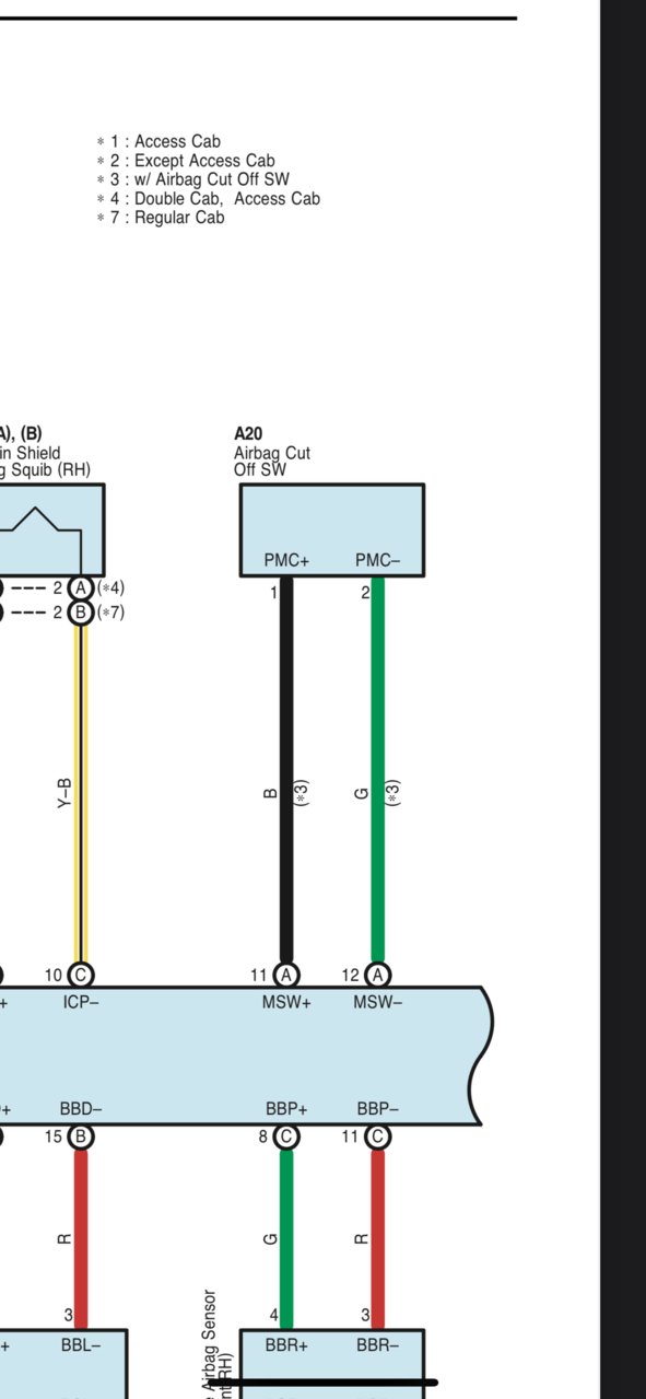

    that’s it, only the access cabs and regular cabs have it I believe, double cabs do not although the harness is prewired for it

    Ah yup you are correct double cabs did not have the switch because you would never put a child's car seat in the front seat of double cab when you have the back seat to use. The on/off allows you to put a car seat in the front safely.

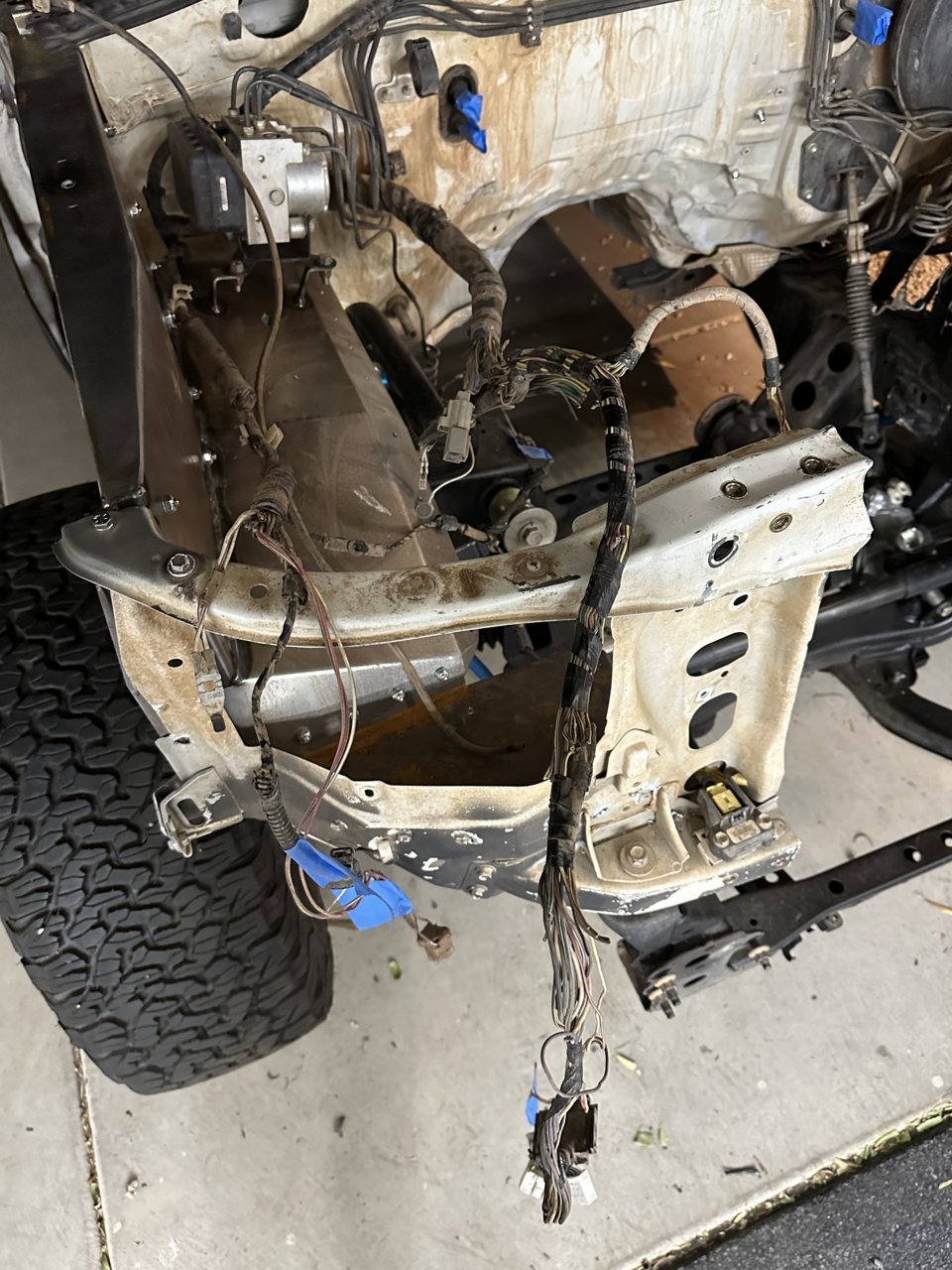

    Can someone bigger brain than me answer this?
    I just realized the only pigtail im using off of the engine room harness is the ac compressor, which is making me think it’s not worth having that bundle of shit in there just to activate the ac compressor. What it I instead ran the ac clutch to my switch pros and just completely removed the engine room harness? Could I also remove the ECU at that point? Or better to leave the computers in place to run the rest of the truck but just unplug the engine room harness?
    edit: I just realized I need to keep it for the fuse box connections in the engine bay, or is that not needed? I guess I need to see if the starter signals are sent to the fuse box through that harness.
    @Dm93 Can you shed some light on this?

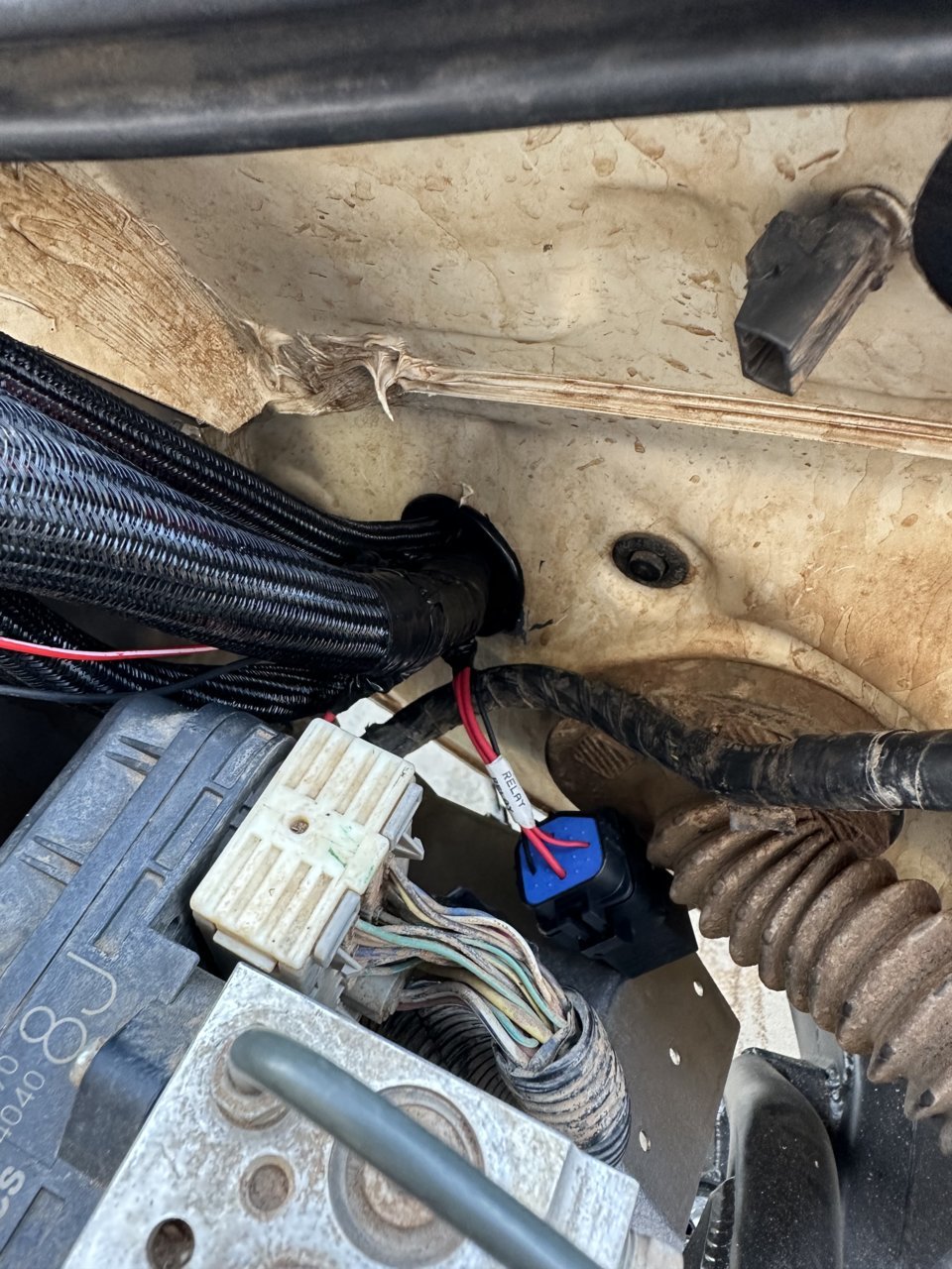

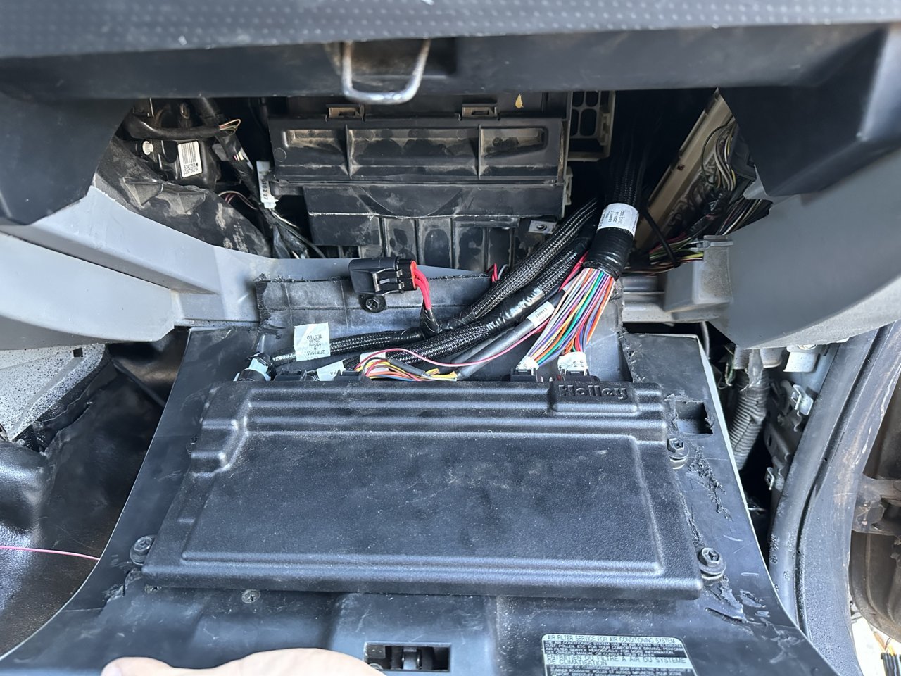

    Holley is mounted and wired up!
    here’s where the wires come through the firewall. 2” hole with a grommet.
    going to wire up all of the inputs and outputs, so it’s theoretically plug and play to get the engine running.
