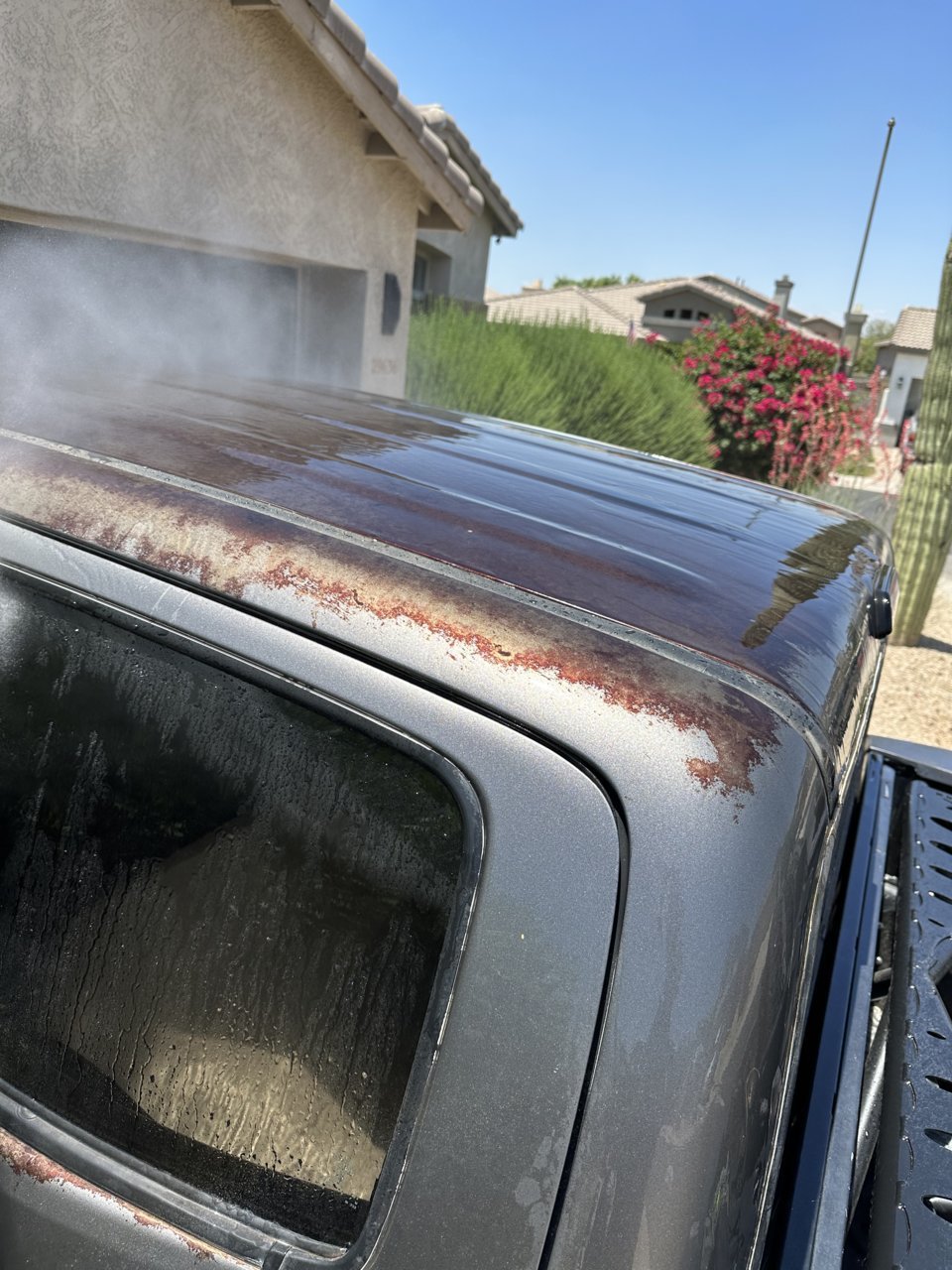

    The OE white paint is a single stage paint which means that it does not have a clear coat over the paint so mud like that can actually seep into and stain the paint. So if it is an actual stain and not on the surface a degreaser or anything like that will not touch it you’ve got to dig / cut into the paint with a buffing compound. With pro chems like maguires it is actually surprisingly easy to do even by hand

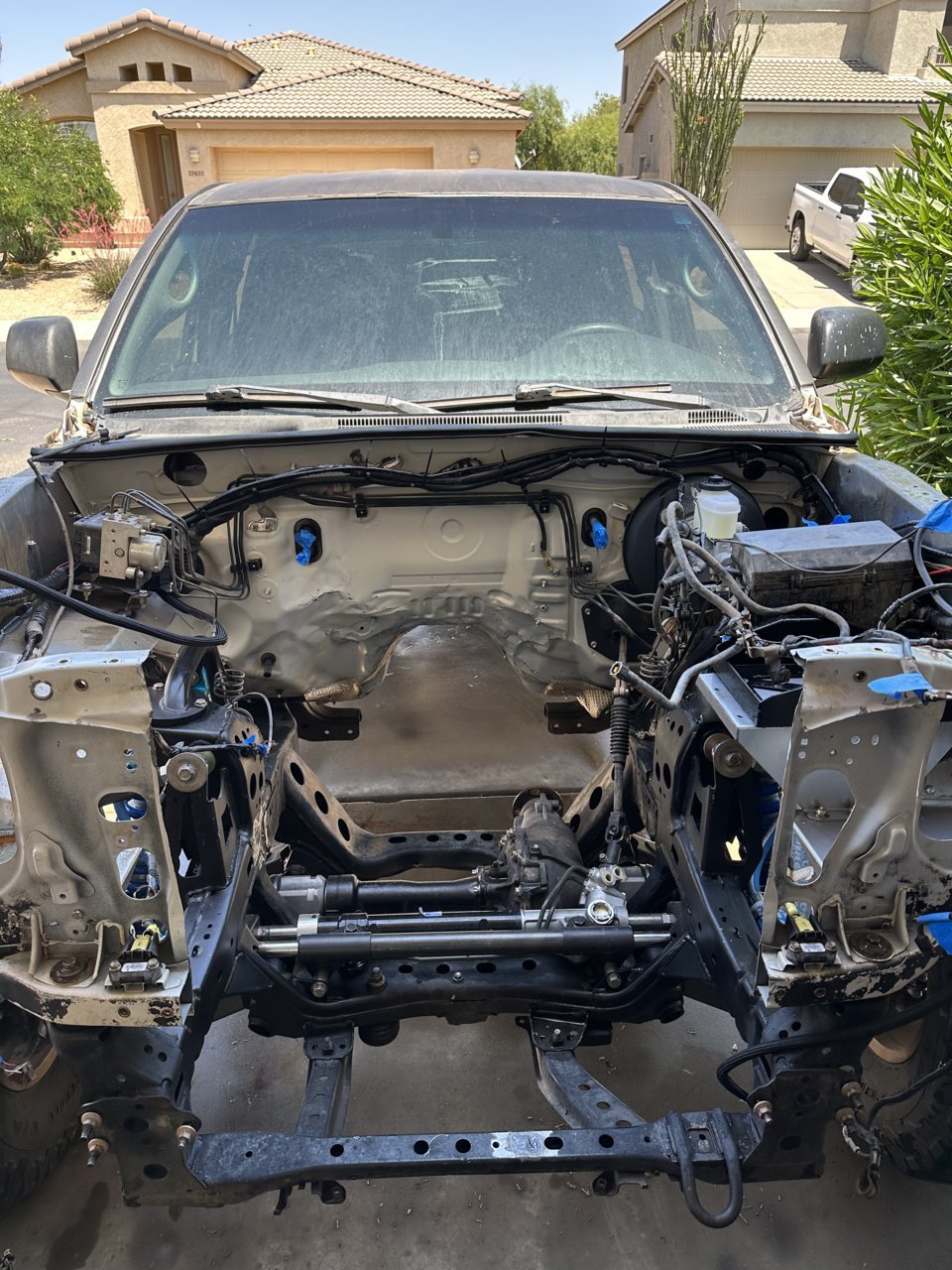

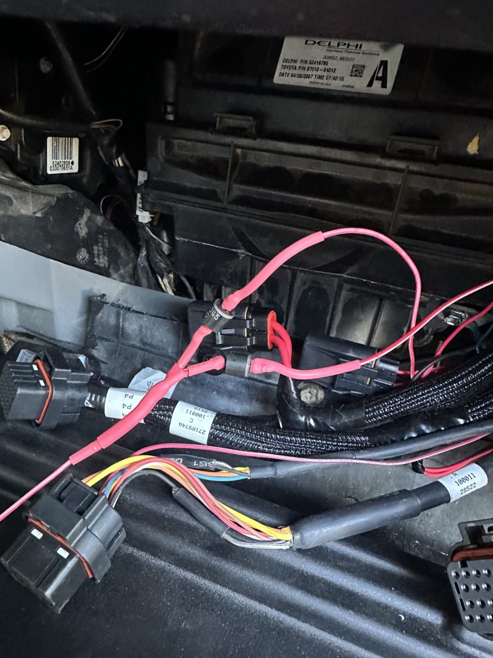

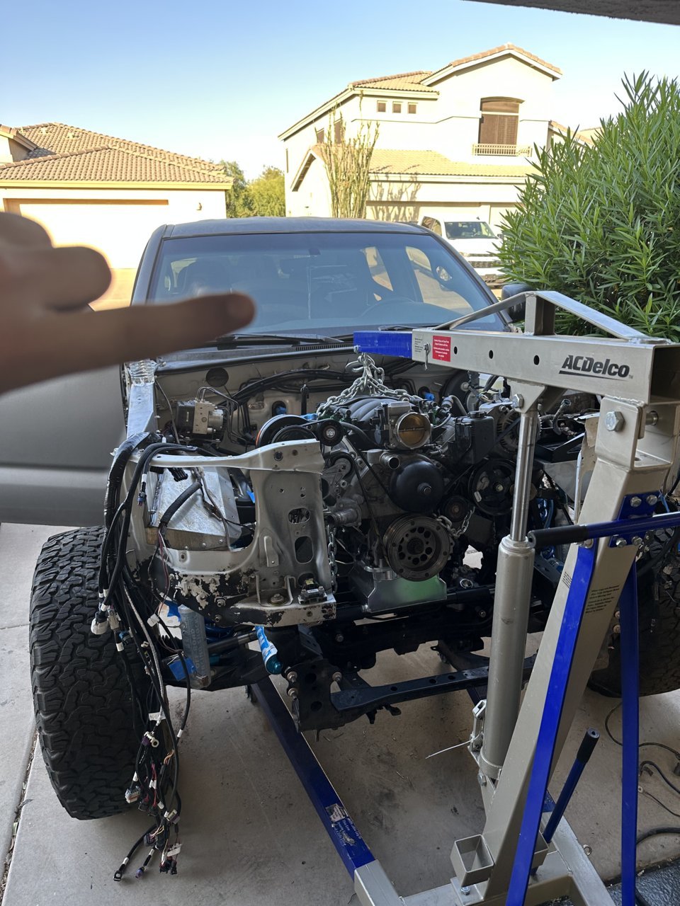

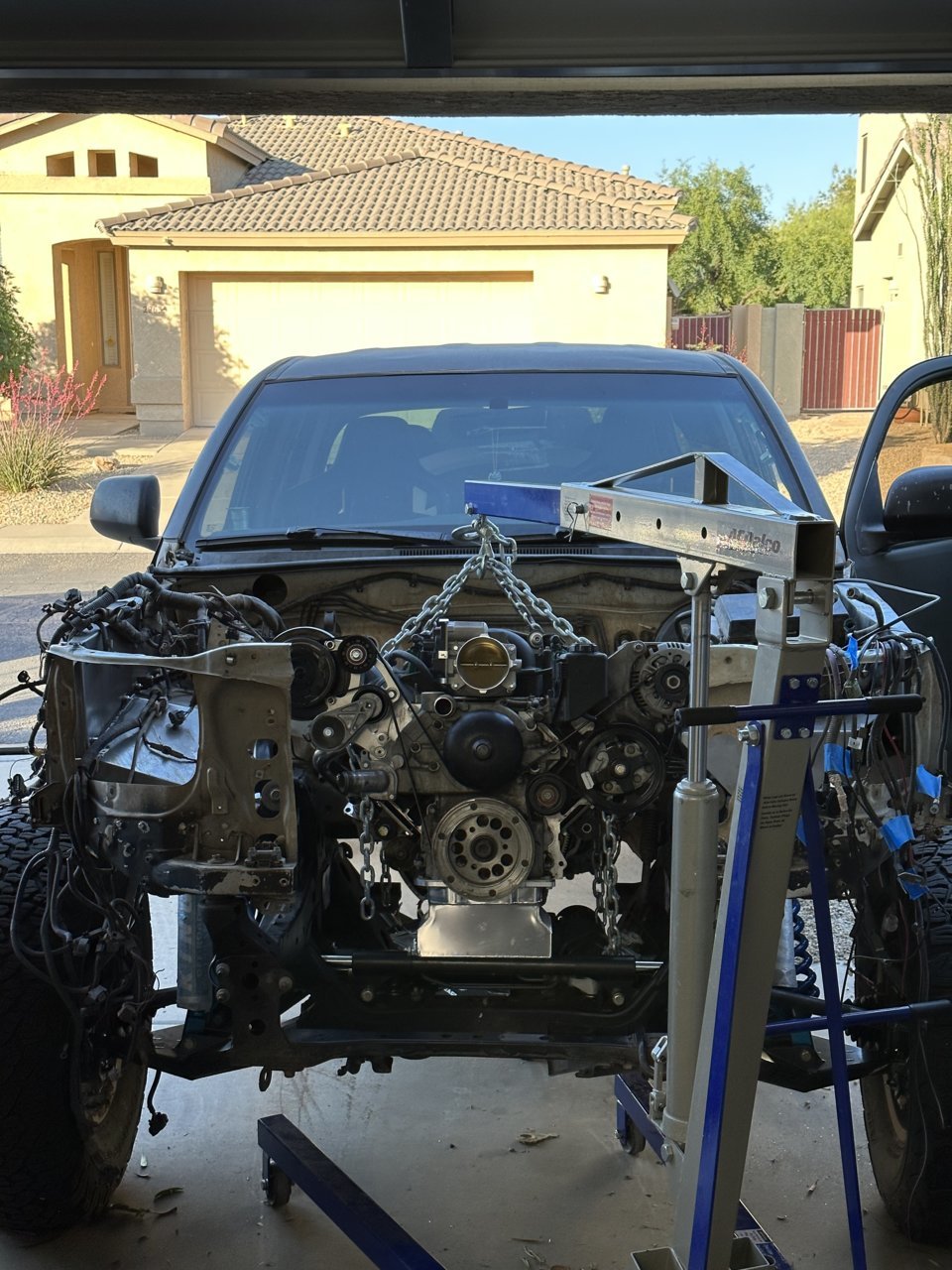

    Lots of updates.
    This is what the wrap is looking like after just about a year :/

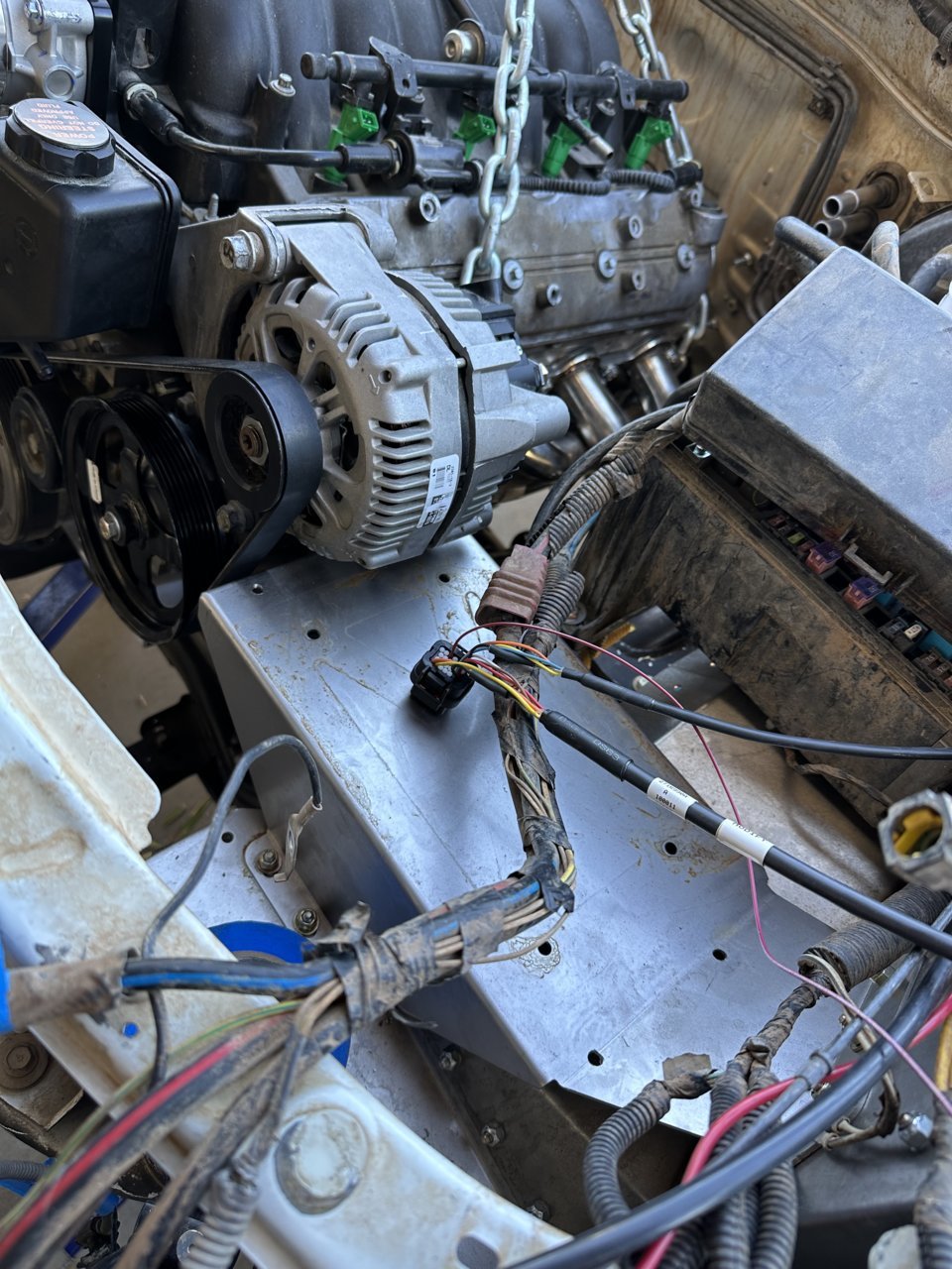

    factory wiring harness taken care of, Holley stuff routed to the side it needs to be on. And paint cleaned :)
    poly front core support mounts changed out.

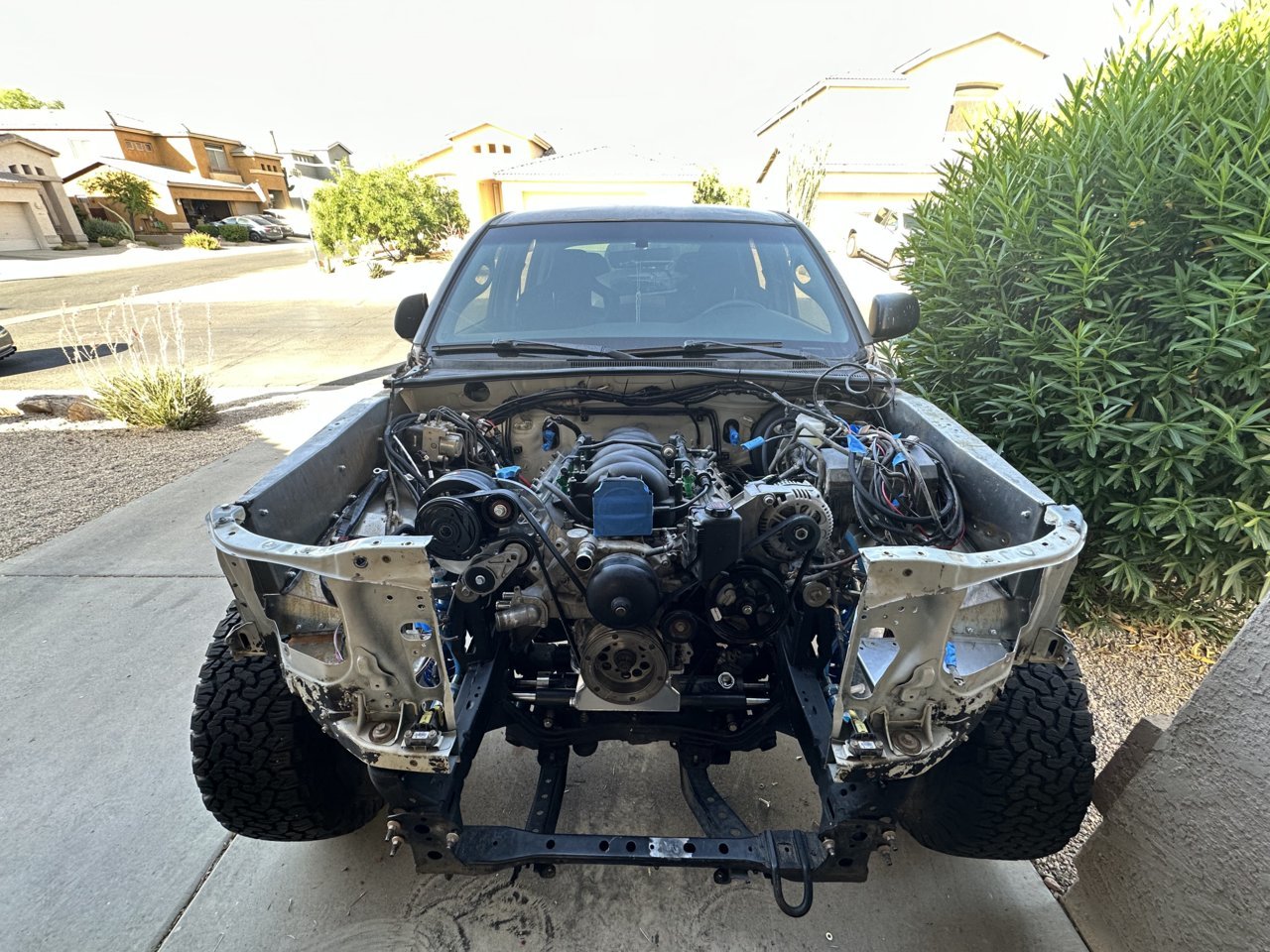

    engines in! Supported by the frame!
    We did just take it back out though, need to finish weld the mounts and plate them. But fucking finally we’re making some headway here. Sunday we should have the motor in its resting place permanently. The NP261HD’s mount lines up perfectly over the stock cross member.

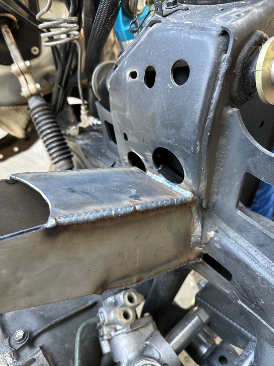

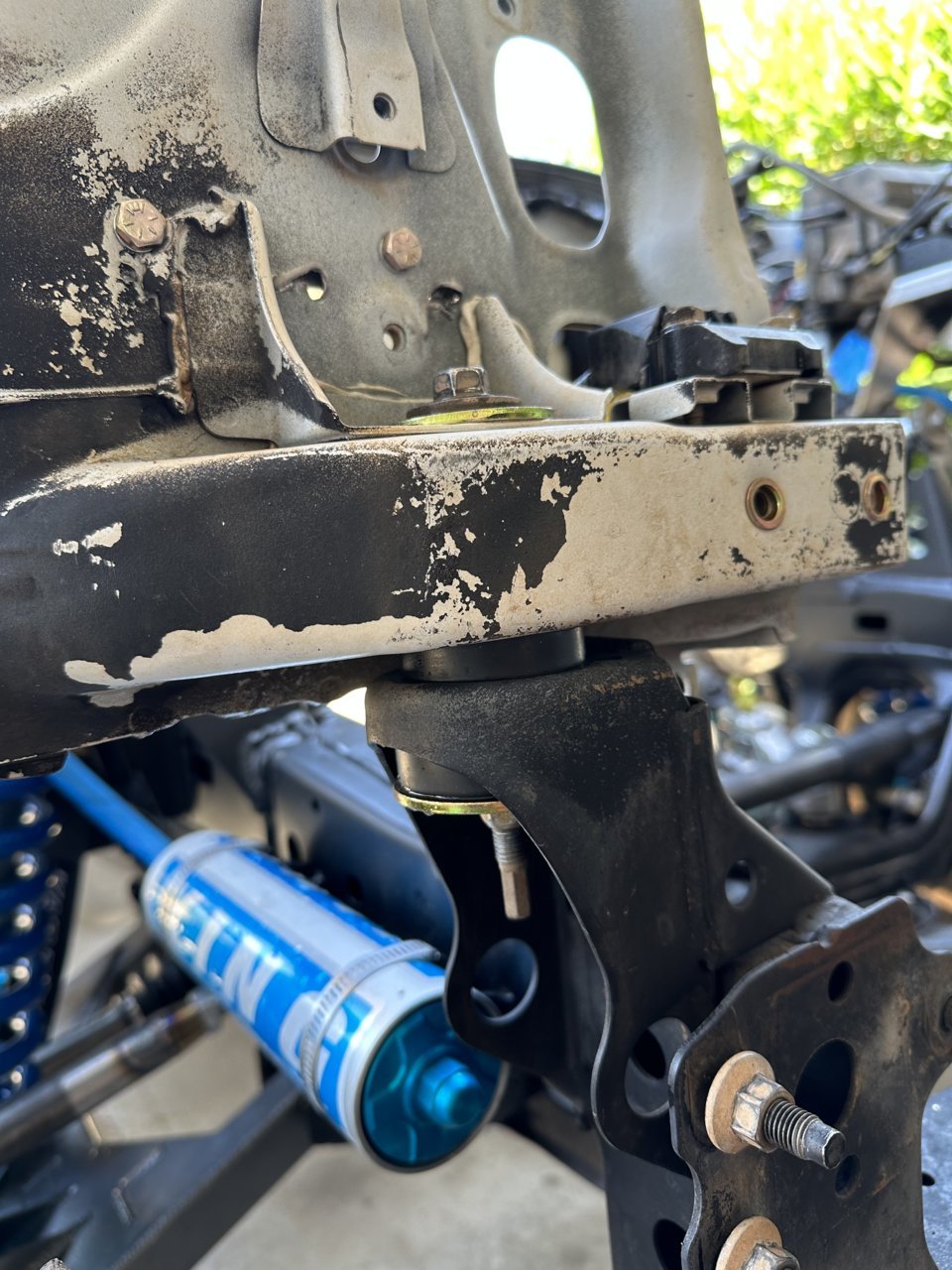

    motor mounts are boxed!
    motor is officially in and bolted down. It won’t be coming out again.

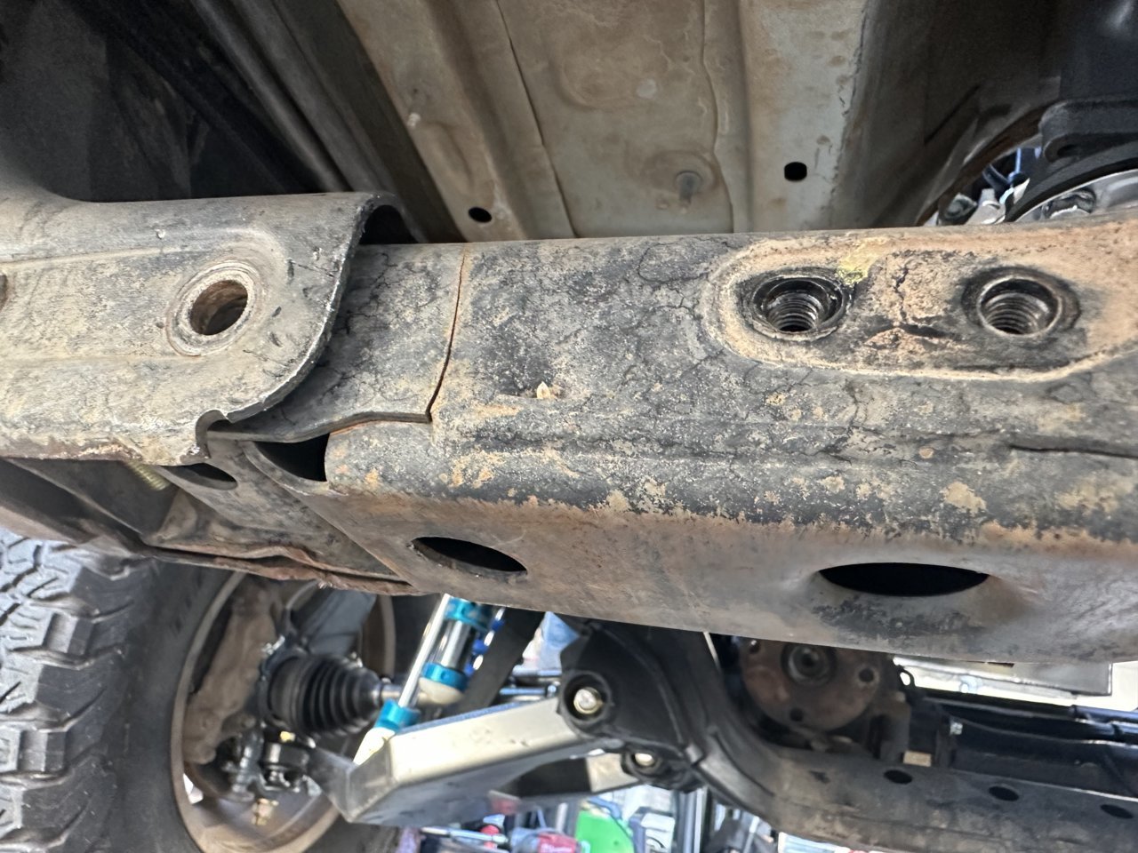

    Going to need a new crossmember. Lines up perfectly, but…
    pretty serious crack there.
    I can officially say the truck has been LS swapped now :)

    Braeden
    BC
    Been finding more cracks in those spots lately on customers trucks

    It’s actually cracked on both sides. Shits fucked lmao

    Reoriented the battery tray so I won’t have to relocate it. Tonight I’ll try and get my transmission cooler setup and fluids filled in everything. Gotta wire up the big 3 as well. Then once the trans crossmember is back from repair, it’ll start!
